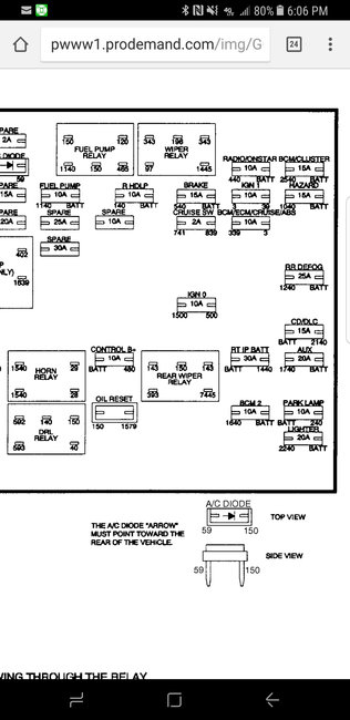

No tail lights no dash lights
172,000 MILES • 4 CYL • 2WD • AUTOMATIC
JESSICAWESSON
Head lights, running light, dome lights and brake lights work.
Tail lights and back light for dash do not work. What could be wrong?

Sounds like you have a blown parking light fuse.
Jul 6, 2017 at 11:03 AM
SATURNTECH9
  • 30,869 POSTS
I posted a diagram of where the parking light fuse is in your Underwood fuse box.
Jul 6, 2017 at 11:08 AM
SATURNTECH9
  • 30,869 POSTS
Under hood fuse box I meant.
Jul 6, 2017 at 11:09 AM
JESSICAWESSON
We have replaced the park lamp fuse and still do not have any lights any other suggestions. we also replaced the dimmer switch.

SATURNTECH9
  • 30,869 POSTS
The dimmer switch only controls the dash lights and radio shifter indicator lights etc not the outside lights.iam posting a link to a guide how to check the fuse.I need to know if the old fuse was blown and if the new fuse is blown.
