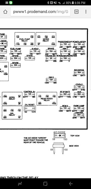

Head lights, running light, dome lights and brake lights work.
Tail lights and back light for dash do not work. What could be wrong?

Sounds like you have a blown parking light fuse.

I posted a diagram of where the parking light fuse is in your Underwood fuse box.

Under hood fuse box I meant.

We have replaced the park lamp fuse and still do not have any lights any other suggestions. we also replaced the dimmer switch.

The dimmer switch only controls the dash lights and radio shifter indicator lights etc not the outside lights.iam posting a link to a guide how to check the fuse.I need to know if the old fuse was blown and if the new fuse is blown.
