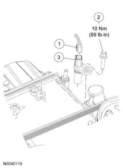

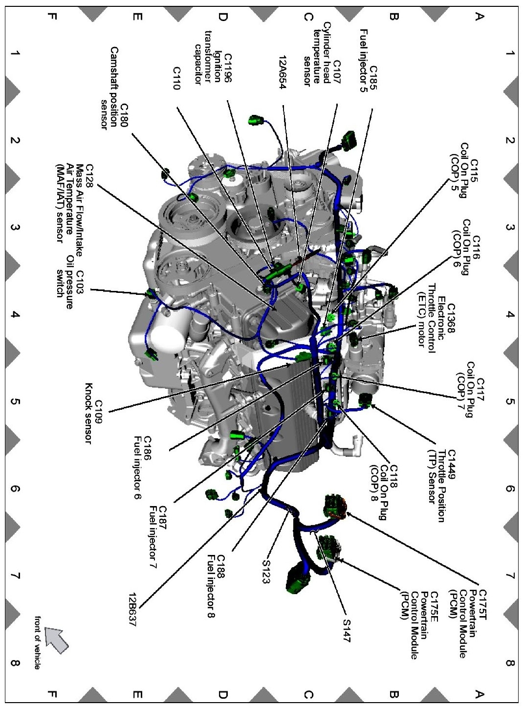

No spark can be caused by a few things. First, I would check to see if there are trouble codes stored in the computer. Here is a video which includes a general directions for using a scanner:
https://youtu.be/YV3TRZwer8k
If there are no codes and you have access to a scanner which can provide live data, check to see if there is a crank sensor signal. If you find the crank sensor is the issue, I have attached directions for removing and replacing it.
_______________________________________________________________________________________

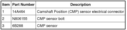

SERVICE AND REPAIR
Camshaft Position (CMP) Sensor
Removal and Installation
Disconnect the Camshaft Position (CMP) sensor electrical connector.
Remove the bolt and the CMP sensor.
To install, tighten to 10 Nm (89 lb-in).
To install, reverse the removal procedure.
I have a feeling the sensor is the issue. Do these things and let me know what you find.
