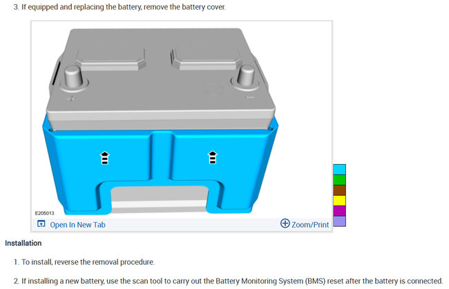

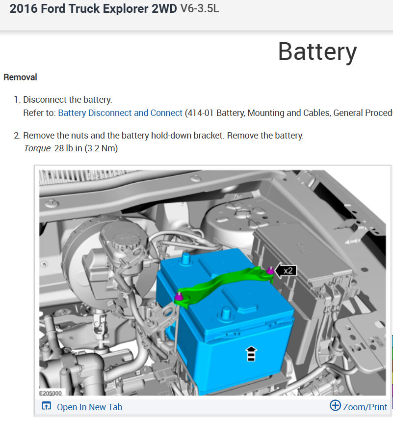

Do the headlights come on? Do they stay one while cranking? If you have a bad battery a jumper may not help it, I would take the battery to the auto parts store for testing. Check out the images (below). Please let us know what happens.

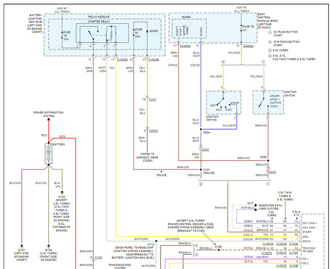

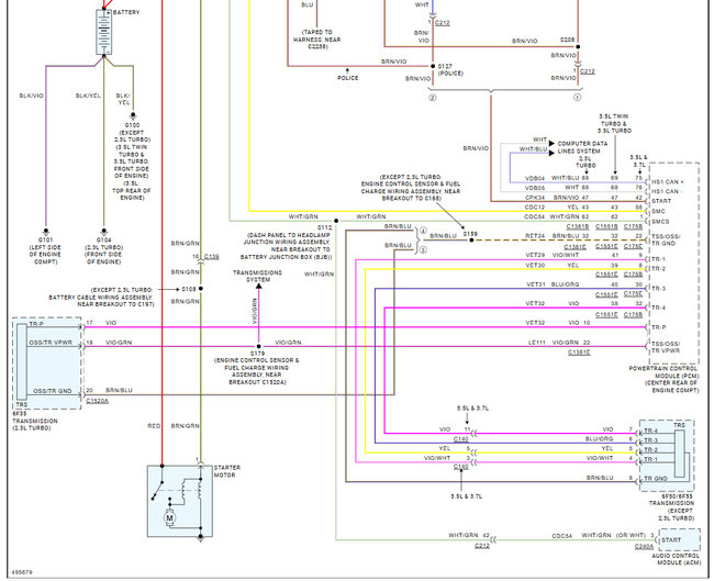

If the engine rotates let's check the fuses under the hood #79 and # 81 near the battery, also please check fuse #18 in the fuse panel on the left side of the dash, here is the starter wiring diagrams so you can see how the system works. Check out the images (below). Please let us know what happens.
