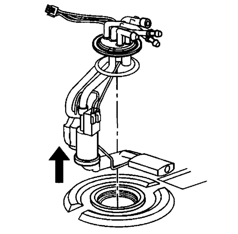

1996 Vorted 5.7 liter. turns over but won't start after getting hot after driving in traffic 30 minutes. Cool off motor for an hour or two, starts right up.
New spark plugs, wires, distributor, coil, alternator, battery, fuel filter. Runs excellent, passed CA smog, gets hot and turns over fine, but fails to start.
No codes come up on scanner.

When it will not start, I would check the fuel pressure. Chances are the fuel pump is failing when it gets hot.
The pressure specs are below for you. You can rent a tester at a parts store.
FUEL PRESSURE
1. Ignition "OFF" for 10 Seconds.
2. With ignition "ON," engine "OFF" and fuel pump running, pressure should be 385-430 kPa (56-62 psi).

REMOVAL PROCEDURE
1. Remove the negative battery cable.
2. Relieve the fuel system pressure. Refer to Fuel Pressure Relief Procedure. See: Fuel Delivery and Air Induction > Procedures
3. Raise the vehicle.
4. Remove the fuel tank. Refer to Fuel Tank Assembly. See: Fuel Tank > Procedures
5. Remove the fuel sender unit assembly by turning the cam lock counterclockwise using tool J 39765.
6. Disconnect the fuel pump from the sender assembly.
Pull the fuel pump up into the attaching hose while pulling outward from the bottom support.
Do Not damage the rubber insulator or the strainer.
7. Inspect the fuel pump attaching hose for signs of deterioration.
8. Inspect the rubber sound insulation at the bottom of the pump.
9. Inspect the strainer.
