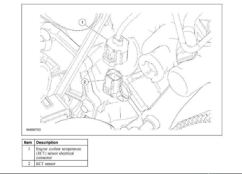

117 This is for the coolant temperature sensor. Check the wiring for any damage.
DTC
P0117
Symptom Descriptor
Probable Causes
Harness Circuit Grounded
Improper Harness Connection
Sensor Damaged

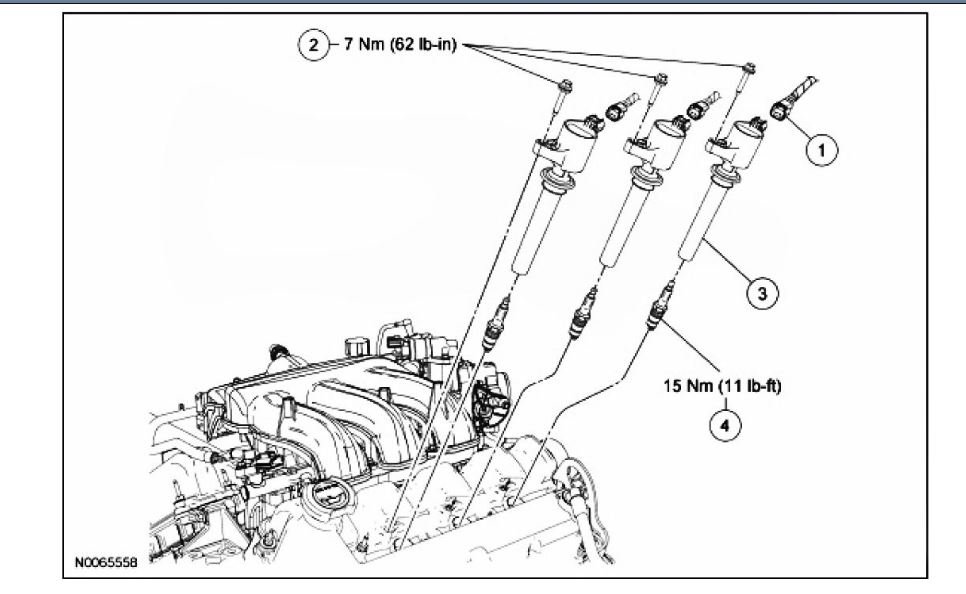

352 Check the coil on number 2 cylinder. check the wiring.
DTC
P0352
Symptom Descriptor
Probable Causes
Coil Damaged
Coil Driver Circuit Open
Coil Driver Circuit Shorted to Ground
Coil Driver Circuit Shorted to Voltage Power
Ignition Start/Run Circuit Open or Shorted

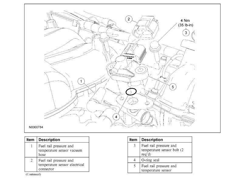

193
DTC
P0193
Symptom Descriptor
Probable Causes
Fuel Rail Pressure (FRP) Relay Sensor Damaged
Fuel Rail Pressure (FRP) Relay Signal Open
Fuel Rail Pressure (FRP) Relay Signal Shorted to Reference Voltage from Powertrain Control Module (PCM) or Voltage Power
Removal and Installation
WARNING:
Do not smoke or carry lighted tobacco or open flame of any type when working on or near any fuel-related components. Highly flammable mixtures are always present and may be ignited. Failure to follow these instructions can result in personal injury.
Fuel in the fuel system remains under high pressure even when the engine is not running. Before working on or disconnecting any of the fuel tubes or fuel system components, the fuel system pressure must be relieved. Failure to follow these instructions can result in personal injury.
1. Release the fuel system pressure.
2. Disconnect the battery ground cable.
3. Disconnect the fuel rail pressure and temperature sensor electrical connector and vacuum tube.
4. Remove the 2 bolts and the fuel rail pressure and temperature sensor.
To install, tighten to 4 Nm (35 lb-in).
Inspect the O-ring seal and install new as necessary.
5. NOTE: Lubricate the fuel rail pressure and temperature sensor O-ring seal with clean engine oil.
To install, reverse the removal procedure.
