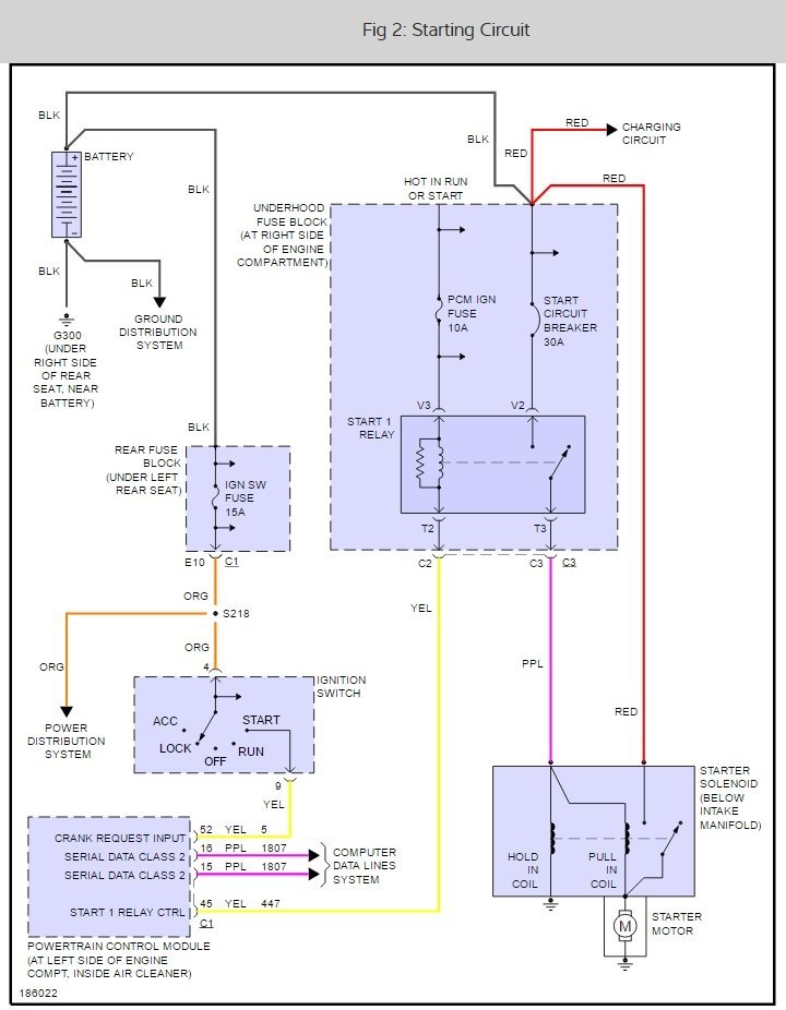

Ok here is the part you are missing. In the SUMMER even a short drive, shut down go back 15 minutes later and NOTHING. No click, no crank. WINTER time can drive forever up to full temp. Shut off, come back, zoom, starts every single time. Not the starter agreed? I am told there are 1or 2 ignition control modules. Must be far enough away from the engine not to get engine heat-soak. SUMMER when warm over 55 will not start. WINTER starts ALL the time. ALL the time w/o fail.
Mar 6, 2017 at 9:05 AM
  • 55,808 POSTS
Hey Mr, Shade,
The ignition models will have nothing to do with the starter. But there is a starter relay is which I would check out first, here is a wiring diagram and a guide to help you check out the problem when it happens.
Please run this test and get back to us so we can continue helping you.
Best, Ken

check battery terminal ends for cleanliness and battery for condition including load test. most places check for free. especially check battery ground under right rear seat. Battery should have at least 770CCA which should be on top of battery. you may also have to drop this off in summer to a mechanic so he can try to repeat the problem.

Did you try the relay?

I wish I could say yes I did, but I fell and tore my rotator cuff completely and have surgery scheduled. I can honestly say that I have never had pain like this in my life EVER!. I am trying to get a friend to do it as moving even a bit the wrong way brings me to my knees. I'm giving you yes just because it makes far more sense than any other. Now here comes Summer again and..........you know what. I was hoping it would be resolved by now. Thank you and when I do find out, you will know.

if the battery was tested by a machine which includes a load test and was rated good then it may be the starter. A pro can test to see how many amps it is drawing to figure that out if it draws to many amps then it will need replacing or auto parts can test there. However you have to pull the intake manifold off to reach it. it may have aflat spot on armature or solenoid is going bad causing problem.
