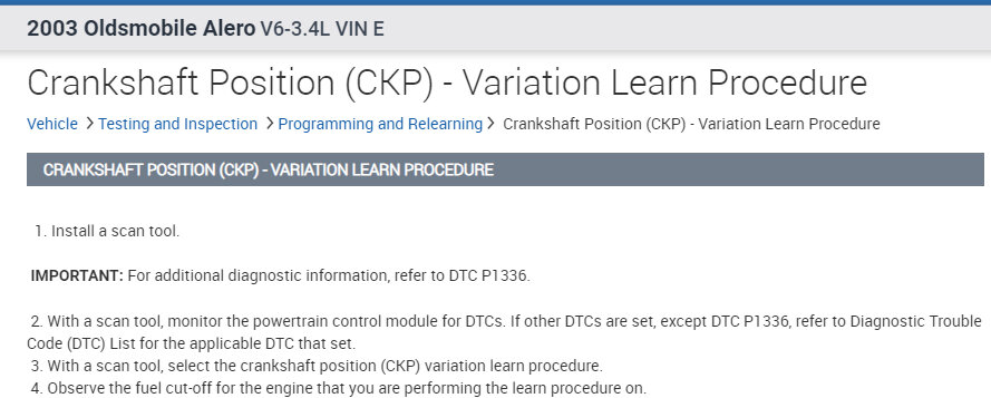

Car lsited above is a GL. would start when engine is cool, but stall while driving at times and difficult to start until after engine cooled down.
I Replaced as of this message: ignition switch, new starter, fuel pump, EGR, MAF, Idol Air Control sensor, spark plugs and wires along with upstream oxygen sensor.
Currently ordered but not yet installed: catalytic converter, downstream oxygen sensor, crankshaft and camshaft sensor as of this message.
I drove the car for short distances like 6 miles since installing the parts listed as being replaced. I did notice a sulfur-like smell coming from the exhaust.
The car has yet to show any lights to which I could obtain an engine code.
There was another sensor seated next to the upstream sensor I could not identify by name. It looked like an O2 sensor. Please advise. It was tied into the same harness as the upstream sensor seated on the driver side manifold. Couldn't identify it by name. Please help

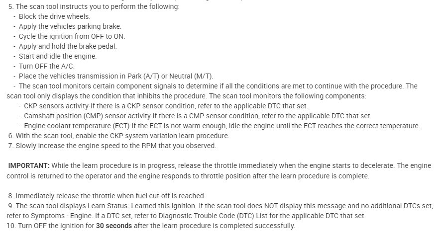

In your opinion what is the cause of no start and stalling? Also does the crankshaft sensor require relearning? Are there 1 ir 2 crank sensors such as 1 behind the starter and 1 or the crankshaft? Need the location??
Thank you for your help. Looking forward to your response.
