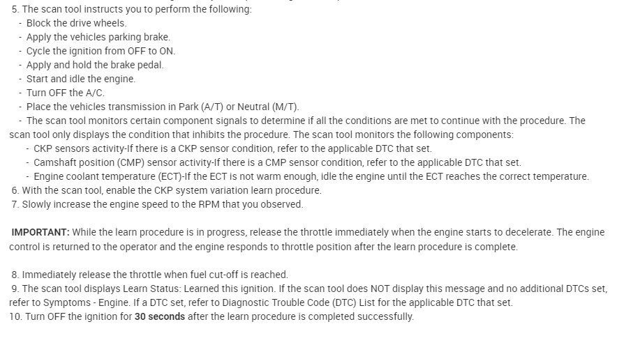

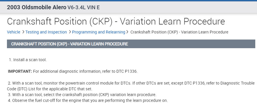

I have a crankshaft sensor for the Alero, but not yet installed it. Does it require a tool to relearn upon installation or not ?

There is a variation relearn that will need to be done, but that won't prevent it from starting.
The relearn does require a scan tool. I attached the directions below for you.
Let me know if this helps.
