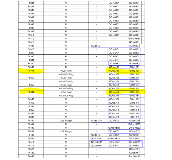

Hello.
When you turn the key to the on position without cranking the engine over can you hear the fuel pump run in the tank for 5 seconds?
Here is the complete trouble shooting for fault p0351 and p0354
JE: Integrated Ignition Coil Pack A, B or C Failure
JE: Introduction See: Computers and Control Systems > Pinpoint Tests > JE: Integrated Ignition Coil Pack A, B or C Failure - Introduction
JE1 Determine which coil is not firing properly
Note:Electronic ignition engine timing is entirely controlled by the PCM. Electronic ignition timing is NOT adjustable. Do not attempt to check base timing. You will receive false readings.
- Determine which coil is not firing properly using information from Pinpoint Test JB or DTC and the table at the beginning of this pinpoint test.
- Record cylinder, coil and PCM pin number from the table.
Have the cylinder number, coil driver and PCM pin number been recorded.
- GO to JE2.
- To obtain required information, repeat go to JE1.

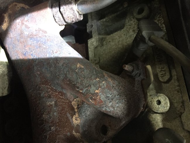

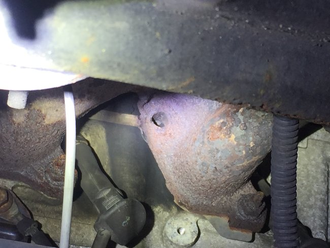

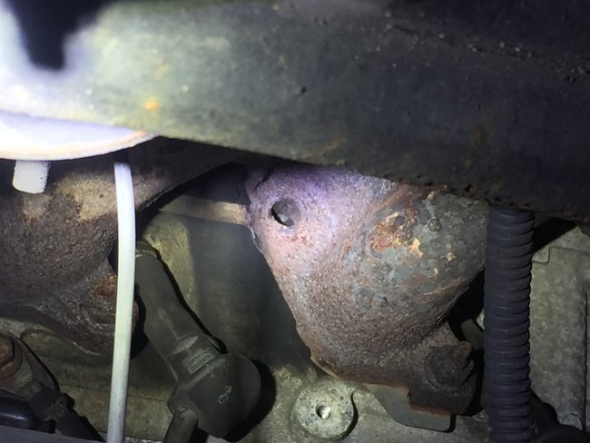

I discovered this today.
Dec 29, 2020 at 4:00 AM
SEVAG P
  • 405 POSTS
Hello.
I don't think exhaust leak causes a misfire. first swap spark plugs to another cylinder if misfire still the same cylinders, swap injectors. Then recheck for misfire.
