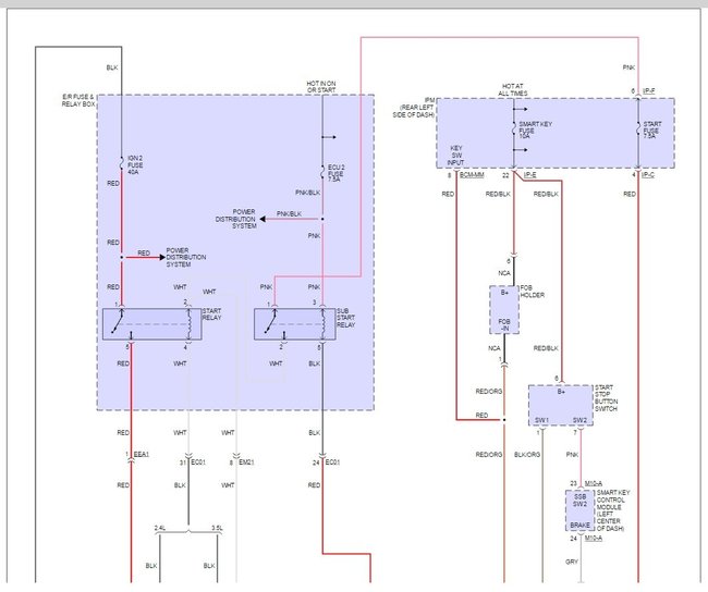

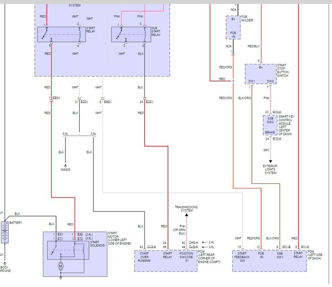

Car will not start or crank. i checked battery and its good. i noticed it rolls in all gears but park and the 40 amp fuse for ignition blows every time you turn the key. I think at start up, but I am not sure. I turn let the go check the fuse.

Hey Mike,
it sounds like you have a starter relay or starter that has shorted out. Here is a wiring diagram and a guide to help you get the problem fixed:
and
and
Please let us know what happens so it will help others.
