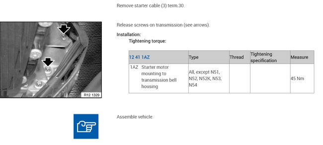

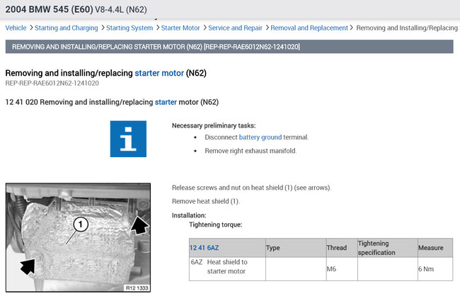

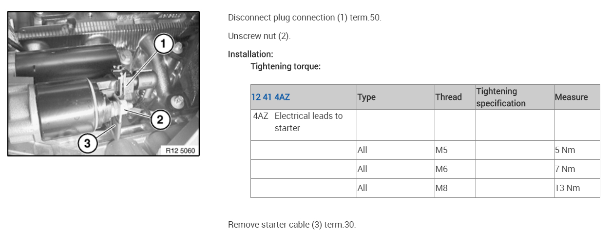

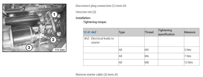

It does sound like the starter is not working correctly. To be sure the guide above will walk you through using a test light how to be sure the starter is bad. Here is how you change out the starter in the diagrams below. Check out the diagrams (below). Please let us know what happens.
