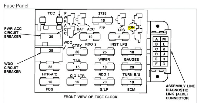

  • 110,248 POSTS
If you haven't, just make sure the fuses are getting power. Because of the model year, I'm struggling to find schematics and legends for the fuse box. I did find one pic showing the ignition fuse. Make sure to check it and confirm there is power both to and from it.
Let me know what you find.

I only have power in fuse box at batt, heat ac, cigar lighter, tail, ctsy, fuses the rest including the ignition highlighted have basically no power am only reading 0.02. thanks

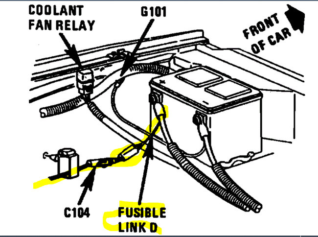

Regardless, I spoke with the site owner about your vehicle. He reminded me that the power to the fuse box in the vehicle is provided via a fusible link.
A fusible link looks like a regular wire, but it functions as a fuse. It may be bad.
I attached a pic below. See if the highlighted wire from the battery positive is there and let me know its color.
Nov 3, 2021 at 1:45 PM
LINCOLNMARK8MAN
  • 7 POSTS
The color is red, and it does have a black fusible link, but I checked with my multimeter and I'm getting 12.4 volts on both sides of the link, and I so appreciate your investment of time in helping me.
Nov 3, 2021 at 1:54 PM

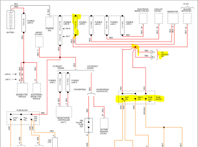

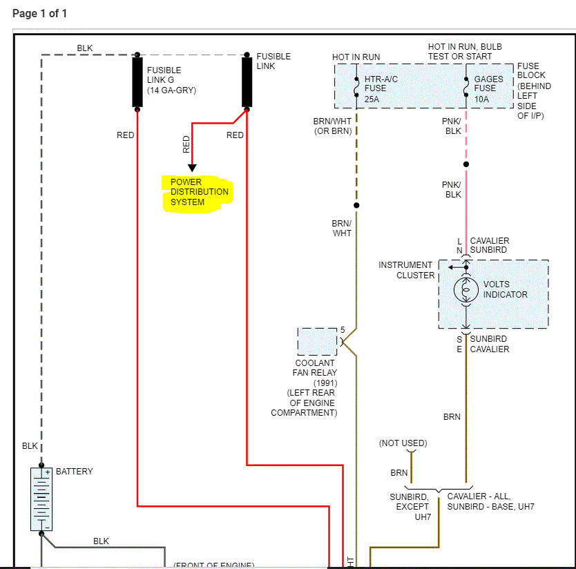

  • 110,248 POSTS

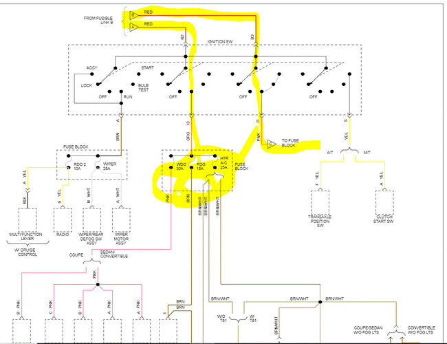

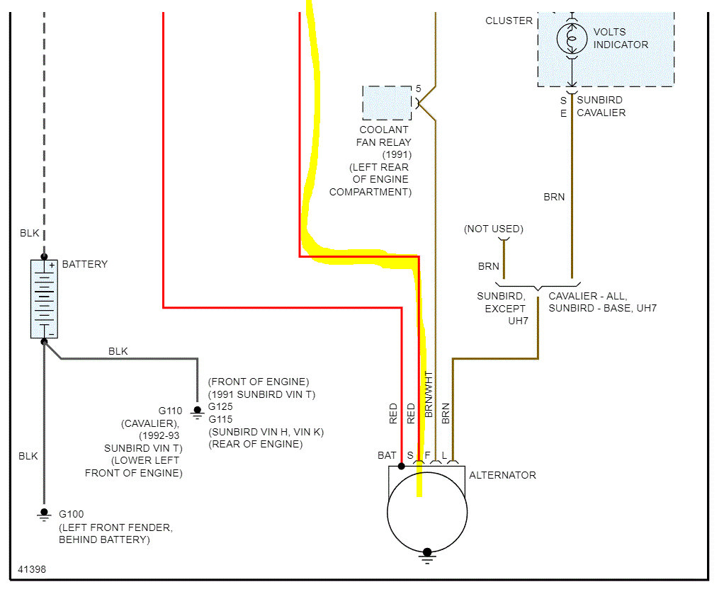

Are there any other links you see? Also, if you go to the alternator, do you see the red wire? Does it have power?
I found one generic schematic showing the fusible link. One from the battery supplies the power distribution system. See pic below. If I see pic below. Also, pic 2 shows where they are on the alt, so you could confirm power at that point.
Nov 3, 2021 at 2:15 PM
LINCOLNMARK8MAN
  • 7 POSTS
Sorry for the delay had a crazy work week but no I didn't see any other fusible links and yes, I do have power at the alternator. thanks for your help.

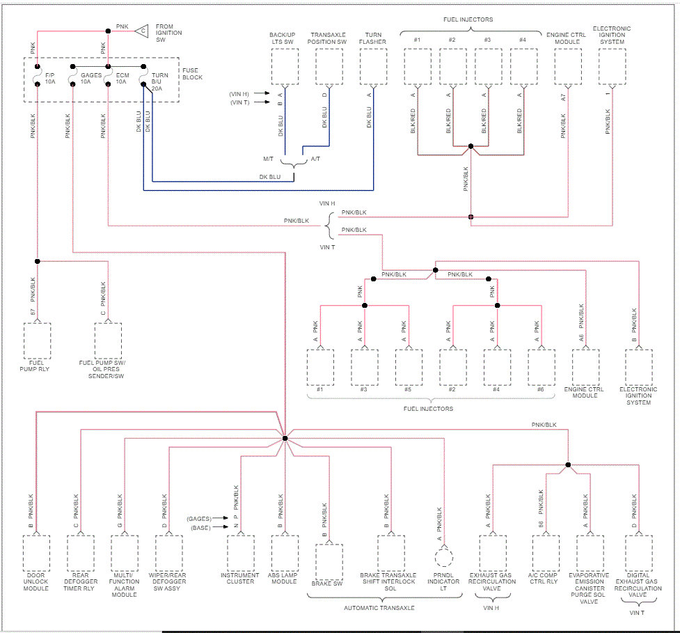

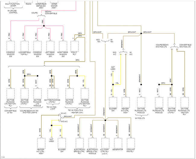

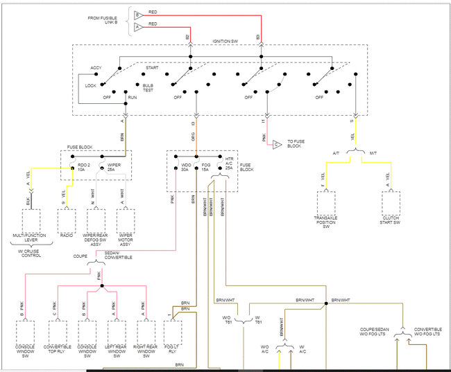

  • 110,248 POSTS
The only thing I was able to go to a newer year. It should be the same or similar.
If you look below, it shows what I thought. Fusible links from the battery send power to the switch and fuse box.
I highlighted the fusible link that I need you to check. See if you are able to locate it on the 1992.
See pics below. I attached the entire power distribution system for a 1994, so it is close in year. I had to cut each pic in half to make them readable for you but overlapped them so you can follow from one to the next.
