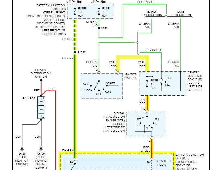

I had the dash cluster go out while driving, no error codes, got home went to start the next day and no go. I have had two certified automotive electricians go over and through every thing three times, I had my PCM repaired $575.00. And still no go, I replaced the PCM because everything pointed to it, fuses and relays are good, no PATS, no chip key, I put a scan tool on today and it threw no error codes but it was not able to read any emissions control items. At my wits end and confused! It has to be something simple! Help, help, help!

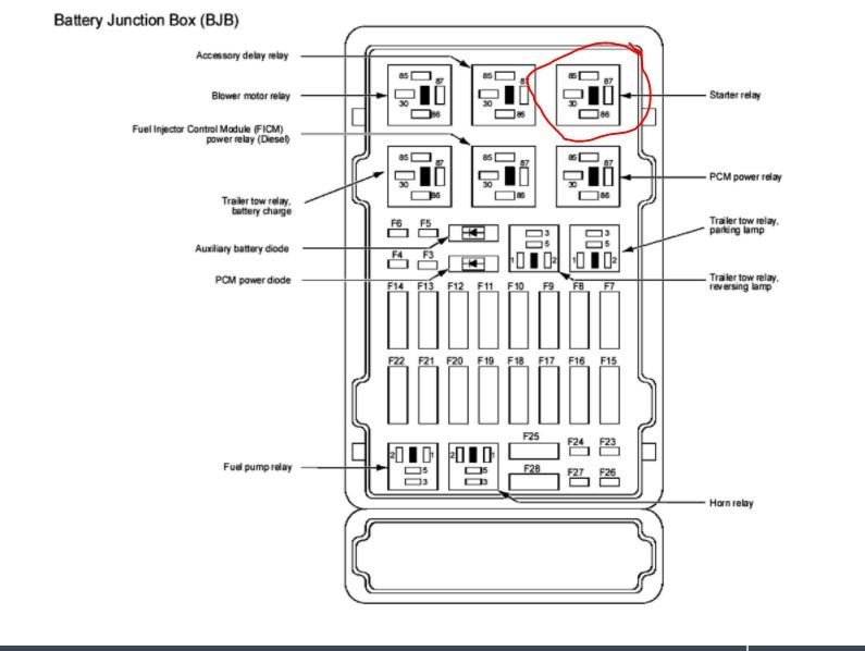

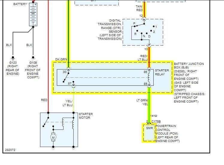

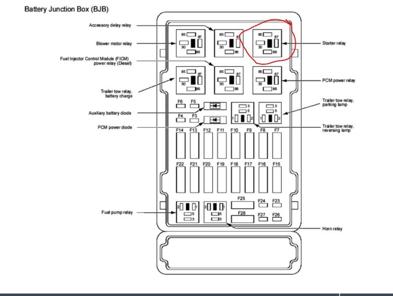

I attached a wiring diagram of the starting system for you to view. You need to do some testing at the relay to be sure you have proper signals in and out of the relay.

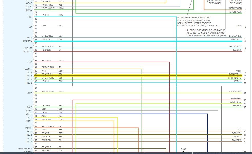

Well, I do appreciate that sir. I know we have been through that relay for sure, only place we couldn’t get power was coming from pin 36 on the PCM. I don’t believe I have a security system as it’s non PATS but it was a fleet service van before so maybe an aftermarket anti theft device! Driving me batty.
Tuesday, October 27th, 2020 AT 2:26 PM
  • 52,797 POSTS

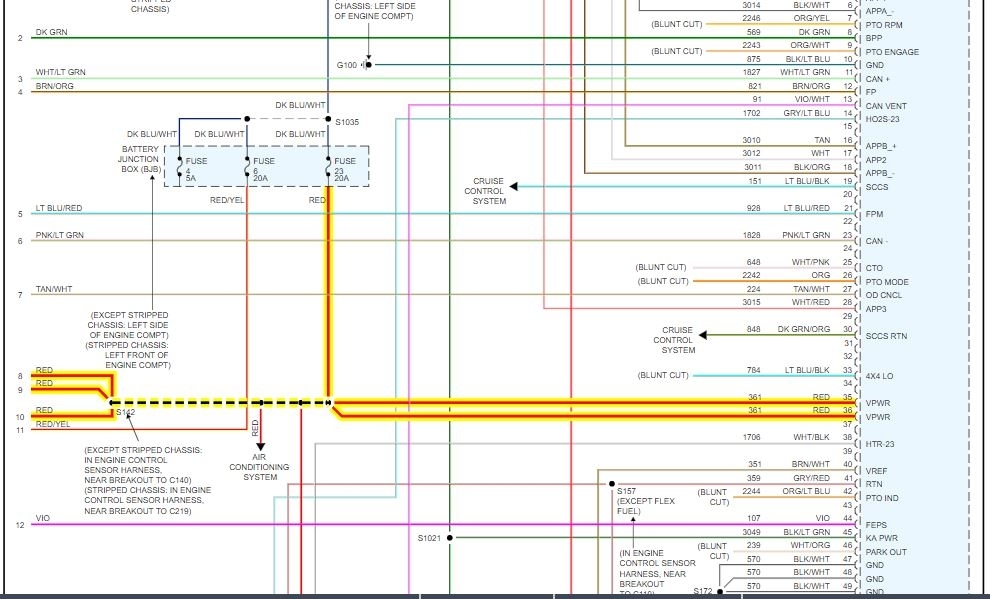

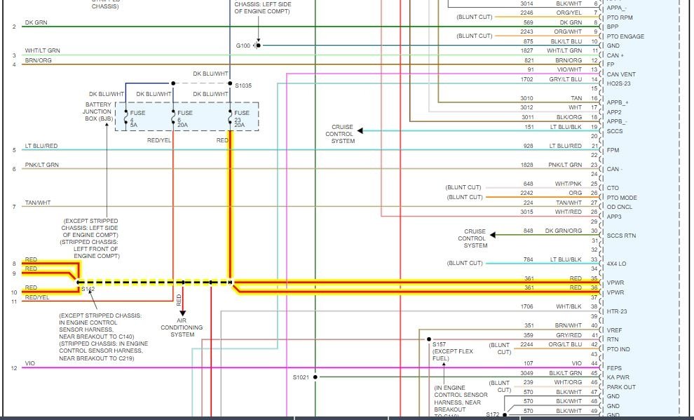

There are 2 pins 36 on the ECM. One is a red wire and one is a brown/blue wire.
Neither provides power. The red is power for the ECM from the fuse in the diagram.
The other does send power to the injectors.
Why do you think it is pin 36?

Only if the fuse has failed for the red wire. You need to test the fuse for power on both sides.

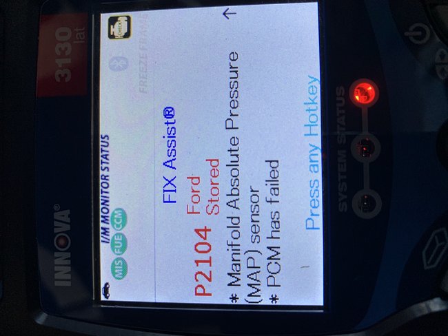

Okay, so here is the present state of my van dilemma: Everything is working except it will not crank using the key. I have power everywhere and I was able to pull up these codes. It will crank but not start if you jump the starter with a screwdriver or at the relay. I don’t have a chip key but i.

I attached the flow chart for 2104.
QE8 DTCS P062C, P2104, P2105 OR P2110: CHECK FOR DTCS IN OTHER VEHICLE MODULES
Check for self-test DTCs in all of the vehicle modules.
Are any DTCs present?
REFER to the applicable Section to diagnose the DTC.
GO to QE9
QE9 CHECK FOR THE PRESENCE OF ANY MODULE COMMUNICATION CONCERNS
Are any communication concerns or communication DTCs present?
For communication concerns in the PCM, DISREGARD the current diagnostic
trouble code (DTC) at this time. DIAGNOSE the next DTC. GO to Section
4, Diagnostic Trouble Code (DTC) Charts and Descriptions See: Computers and Control Systems > Diagnostic Trouble Code Tests and Associated Procedures > Diagnostic Trouble Code (DTC) Charts and Descriptions.
For communication concerns in other modules, REFER to the applicable Section to diagnose the communication DTC.
For DTC P062C, GO to QE16
For DTC P2104, GO to QE10
For DTC P2105, GO to QE11
For DTC P2110, GO to QE15
QE10 DTC P2104: CHECK FOR THE PRESENCE OF PCM DTCS
Clear the PCM DTCs.
Check for self-test DTCs.
Are any DTCs present other than P2104?
DISREGARD the current diagnostic trouble code (DTC) at this time. DIAGNOSE the next DTC. GO to Section 4, Diagnostic Trouble Code (DTC) Charts and Descriptions See: Computers and Control Systems > Diagnostic Trouble Code Tests and Associated Procedures > Diagnostic Trouble Code (DTC) Charts and Descriptions.
GO to Pinpoint Test DK See: Computers and Control Systems > Diagnostic Trouble Code Tests and Associated Procedures > DK: Accelerator Pedal Position (APP) Sensor - Introduction
Monday, November 9th, 2020 AT 12:17 PM

Thanks, in my haste for a helpful solution I failed to mention the following:
Starter relay has power at PIN 86 In start position.
Power good at PIN 30 to 87.
PIN 2 plug C175, PCM SMR does not read ground but the wire OHMS check okay.
I have already cleared all codes that were found but I took pictures of each screen before deleting. Thanks
Monday, November 9th, 2020 AT 12:57 PM
  • 52,797 POSTS
Okay, there should be power at 30 and 86. 87 will only get power when the relay closes as that is the load.
