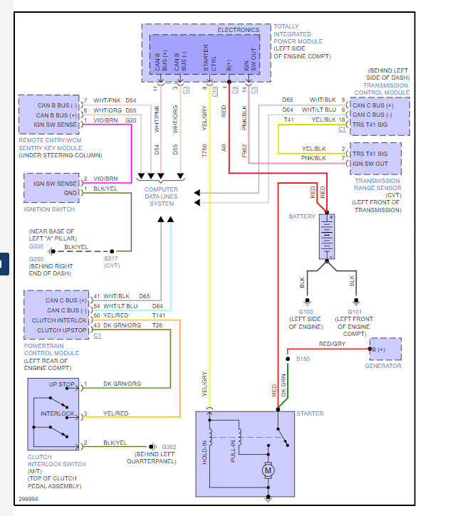

No crank, no start, I thought it was the starter?
2009 DODGE CALIBER
130,000 MILES • 2.0L • 4 CYL • 2WD • AUTOMATIC
CORVETTE99
I replaced it, same no start. I changed TIPM, same thing, checked relays under head light same thing, no start. I'm at a loss. I'm going to check wires around the relay box next.

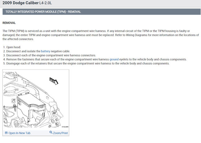

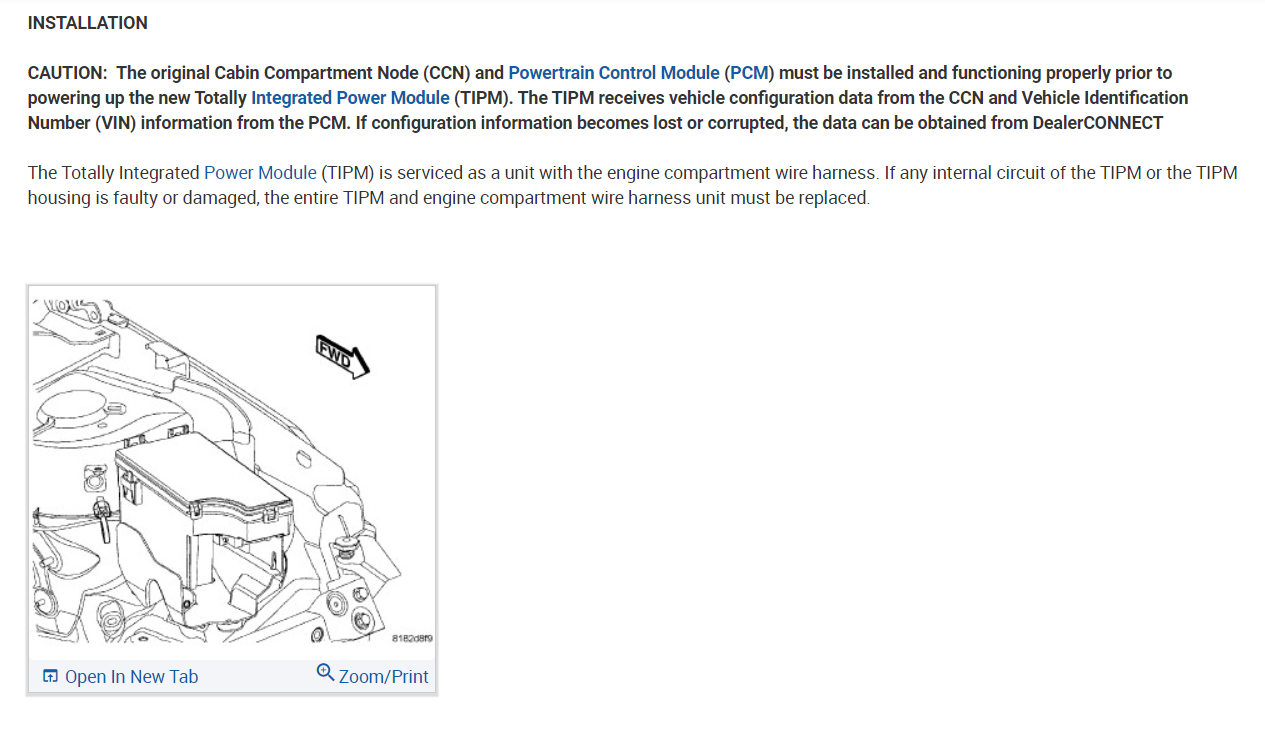

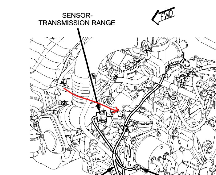

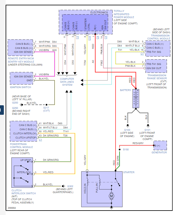

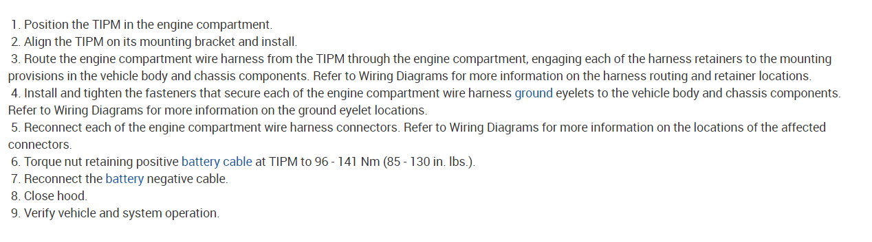

So, there are no fuses that run the system directly, have you tried cranking the engine over in neutral? If this works the gear range sensor is bad which I have left the location for in the images below, if not I would replace the TIPM which is a common problem with these cars, it is easy to replace the because the TIPM self learns and there is no programming needed. Also, I have included the starter wiring diagrams so you can see how the starter system works. Check out the images (below). Please let us know what you find. We are interested to see what it is.
