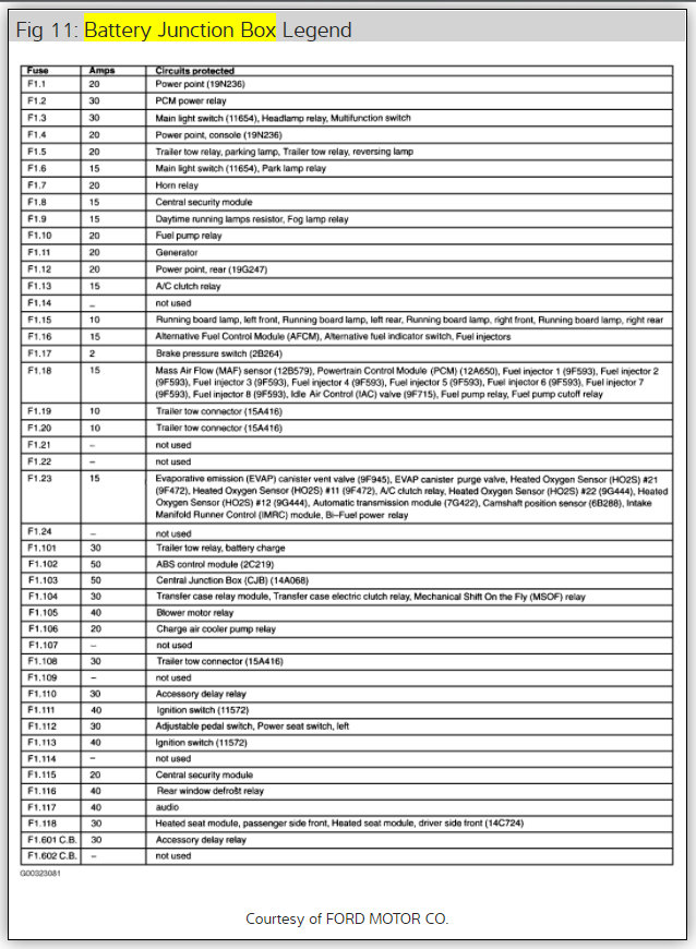

I have changed the starter, changed the battery, changed the ignition switch and the neutral safety switch and I still have no start no crank. I need help I don't know what's going on.
May 30, 2022 at 3:19 AM
  • 55,732 POSTS
Is the security light flashing when you try to crank the engine over? If so, this guide can help you reset the system, also does this truck have an aftermarket alarm system on it?
https://www.2carpros.com/articles/how-to-reset-a-security-system

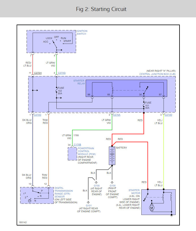

This guide can help us figure out what's going on also I have included the starter wiring diagrams so you can see how the system works.

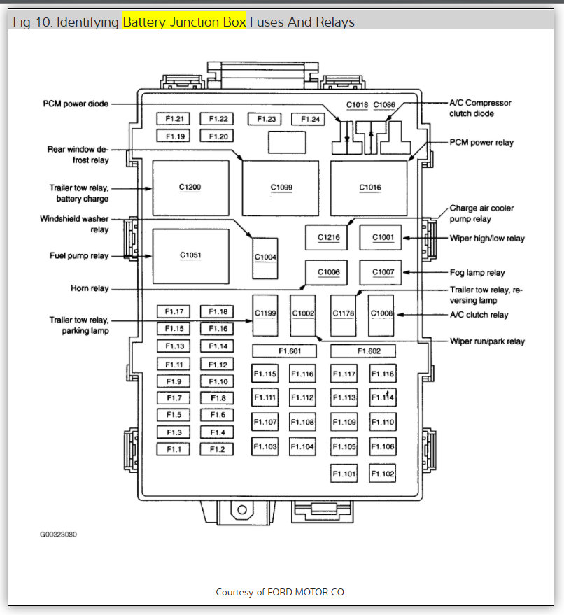

There is a starter relay and fuse # f102 that need to be checked as well located in the interior fuse panel.

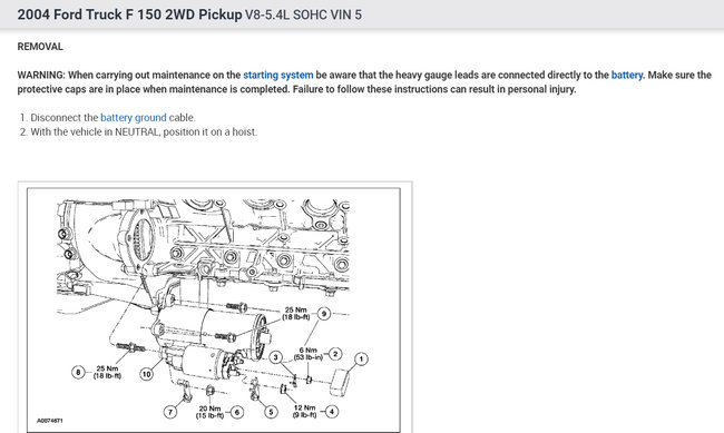

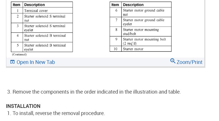

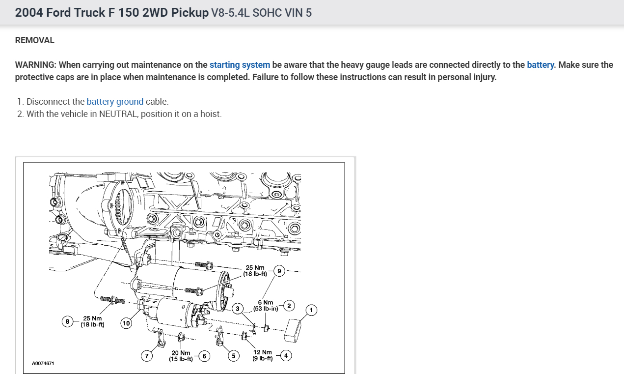

Okay, it sounds like the starter has gone out but to be sure use a test light to check the trigger wire going to the starter. This guide can show you how and I have included the instructions on how to change the starter motor out in the diagrams below:

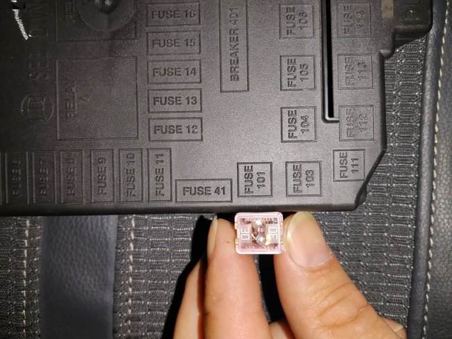

So, I checked the fuse number 101 and sure enough it was blown I swapped it out with another 30 amp fuse and it started right up.
