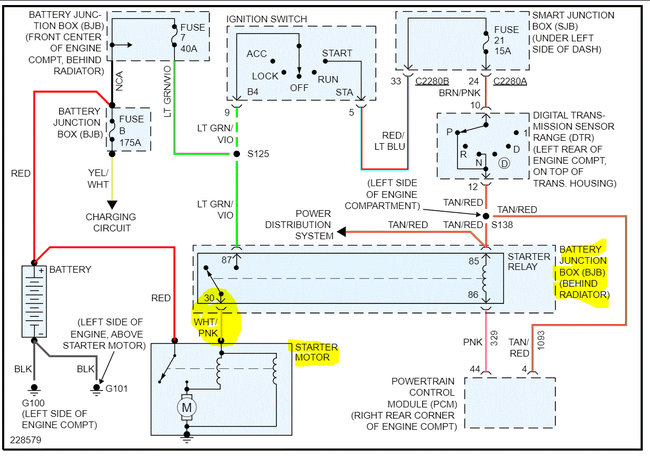

Battery loose bolts. The starter will not turn on fuse box crack positive thermal and negative both has volts 11.4. cylinder on starter don’t have a trigger wire. can you help me to understand what’s going on?
May 18, 2022 at 8:29 AM
  • 110,248 POSTS
Does the starter engage, and the engine not start? Also, a loose battery terminal can cause a weak connection and prevent the starter from engaging. The voltage is also a little low and the starter should have a trigger wire. It should be the smaller gauge white wire with a pink tracer.
I attached the wiring schematic below for you to review. Take a look through it and confirm the fuses are good, the starter relay is good, and there is a trigger wire on the starter motor.
Here are two links you may find helpful:
Let me know exactly what is happening and what has been done so far. Based on the issues you mentioned, I'm not sure where I need to start.
Take care and let me know as much as you can.

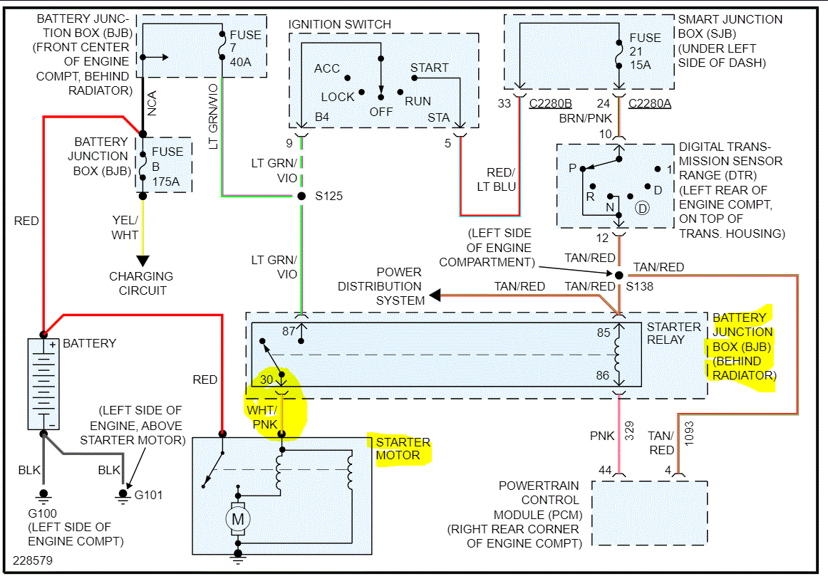

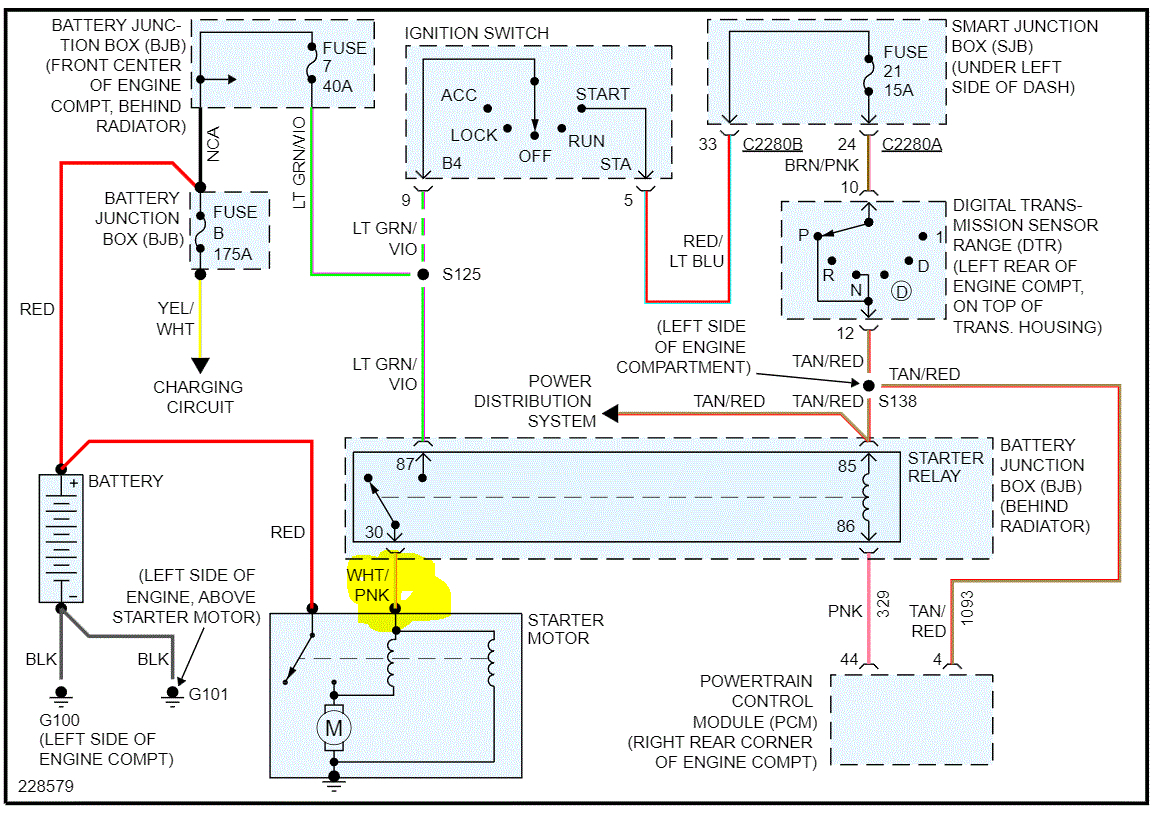

Trigger wire on starter cylinder cannot locate the wire how and where do I find it and what size wire?
May 20, 2022 at 7:06 AM (Merged)
  • 110,248 POSTS
The trigger wire is a white wire with a pink tracer. It runs from the relay box under the hood to the starter motor. I suspect is a 10-gauge wire and is much smaller than the red wire from the battery to the starter.
See pic below.
