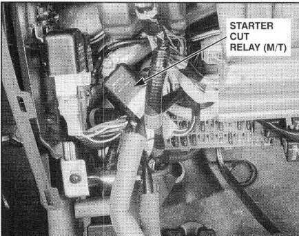

Is this the relay you replaced? This is the starter cut relay which if it is not working the starter will not operate. Check out the images (below). This relay is on the drivers side so if you didn't mess with it I would check for power at the starter trigger wire when the key is in the crank position and if so the starter is bad. This guide can help you
Please upload a short video in your response of the problem, so I can see what's going on.
Dec 17, 2025 at 1:06 AM
FARR_2007
  • 83 POSTS
That is not the relay I replaced should I look into that? The relay I replaced is in the image and that is in the passenger side you have to drop the glove box

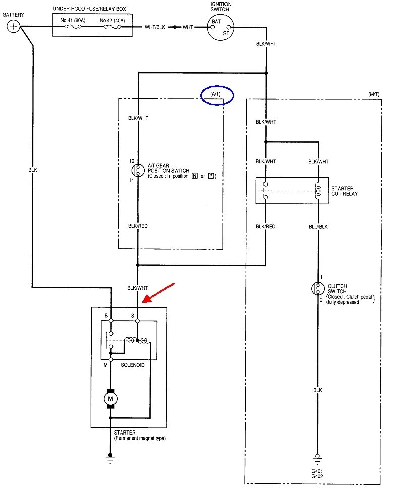

Where is the starter relay located I’m having a no crank no start happening, I recently had to replace the main relay on passenger side near glove box, also when I opened door one day the alarm went off randomly out of the blue
Why is it not cranking or doing anything when I turn key and battery is new
Dec 18, 2025 at 5:20 AM (Merged)
CARADIODOC
  • 34,383 POSTS
The starter relay is only used on models with a manual transmission. Both circuits are shown in the diagram. Use just the part with the blue circle over it. This circuit is very simple to diagnose but you'll have to be able to reach the starter. Measure the voltage on the smaller black / white wire on the starter solenoid. When a helper turns the ignition switch to "crank", you should find 12 volts there. If you do, but the starter doesn't engage, the solenoid is likely defective. If the solenoid makes a single, rather loud clunk, it's engaging but there's a bad connection on one of the battery cables or burned contacts inside the solenoid. For this test, it's best if you use an unpainted, rust-free part of the engine for the voltmeter's ground lead rather than the battery's negative post. Doing so will include the negative battery cable in the test.
If you do not find 12 volts on the black / white wire, we'll have to narrow this down to the individual failed component, but first, let me know what you find with this test.

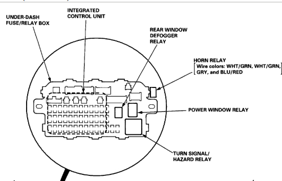

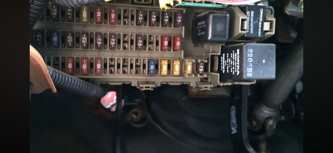

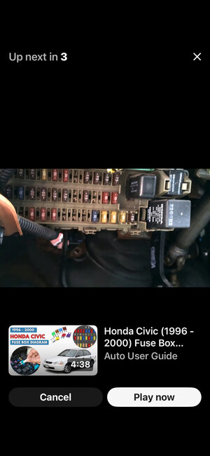

What are these relays for under dash panel on drivers side of car, do any of them make the starter work because last time i tapped on them and the car would start, i have attached a pic
Jan 4, 2026 at 1:56 AM
  • 55,433 POSTS
Did you check the fuse for power as I suggested? Also, try tapping on the starter to see if that makes a difference. Here are what those relays do, nothing to do with the starter. Check out the images (below). Please let us know what happens

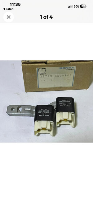

What are these relays for on the drivers side behjnd panel they are held in with two bolts, is it possible my ignition is going bad? To get it to start i keep turning the key until it eventually fires up and engages the starter, ao again i turn the key and nothing happens i keep doing that until it starts which makes me believe its a ignition switch problem
I have attached photo of the relays in question as they loom like this but not sure on the part number
Jan 5, 2026 at 1:40 AM
FARR_2007
  • 83 POSTS
When i turn the key nothing happens, i fixed it by tapping on these relays which i will put in the pic, now its not starting again what can cause this as starter is good and battery is new
I have attached pics of relays in question
Jan 5, 2026 at 2:32 AM (Merged)
  • 55,433 POSTS
So you need to check for power at the fuse to confirm the starter trigger is getting power. It is fuse #31 7.5 amp in the fuse panel under the dash when the key is in the crank position.
