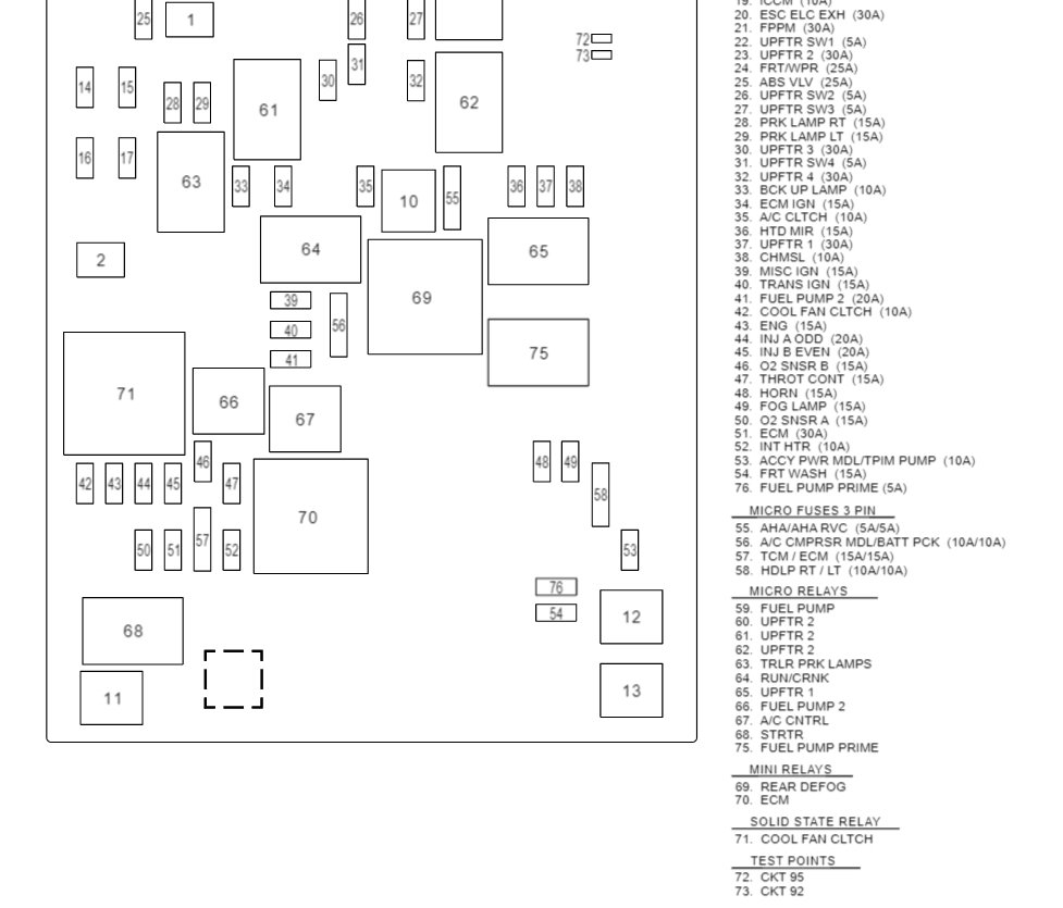

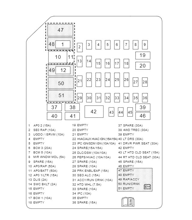

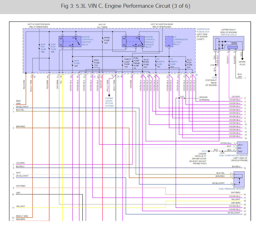

I accidently shorted the connections to the run-crank relay in the X50 underhood fuse box and now the truck won/t crank. The run-crank relay is not getting a signal to the grd pin to activate the relay. If i hold the relay closed the engine will start with the ign key on but will not shut off with the key until I release the relay. I apparently shorted something but not sure what

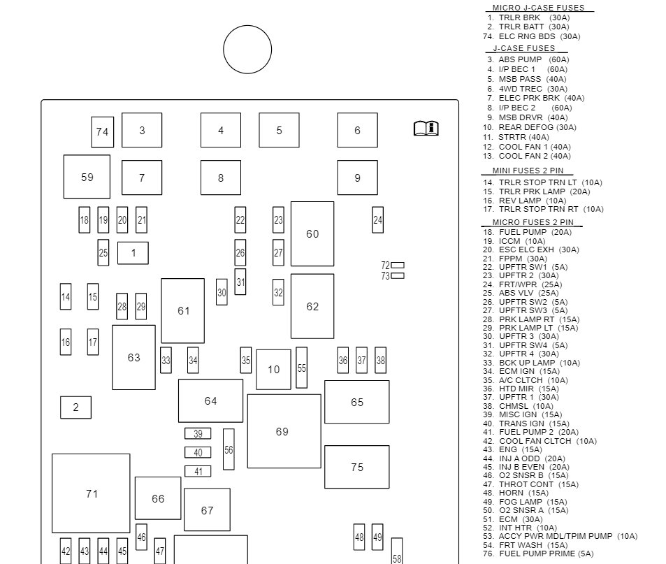

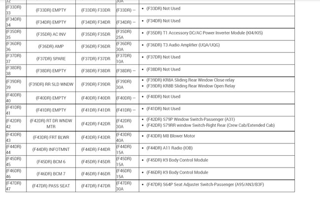

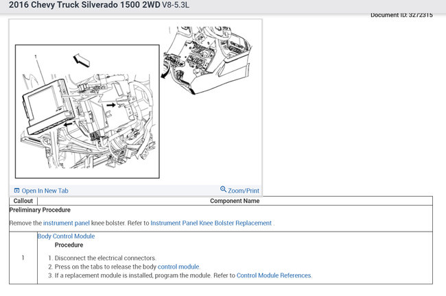

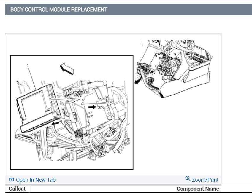

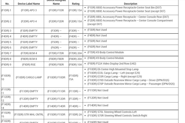

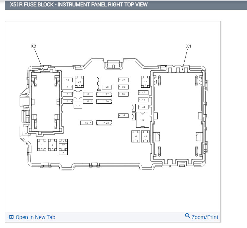

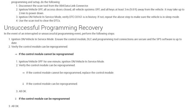

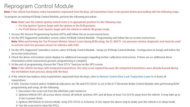

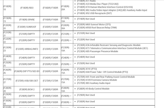

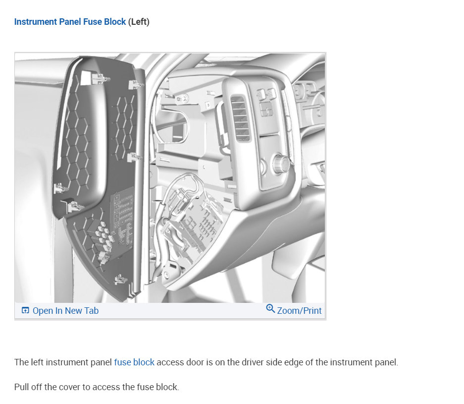

The first thing to do is check all fuses. Here is a guide to help and the use location in the diagrams below. Also, check the BCM fuses with the key on.
If all fuses are okay, we need to do a CAN scan which is easy. You can get a CAN scanner from Amazon for about $30.00.
https://youtu.be/u-4syLc-ifQ

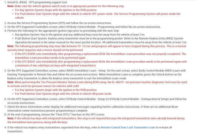

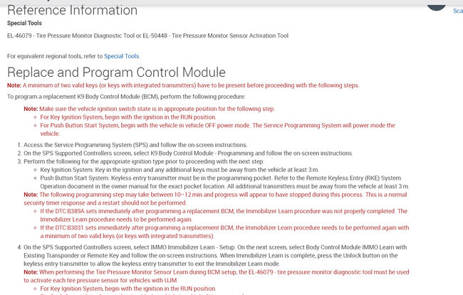

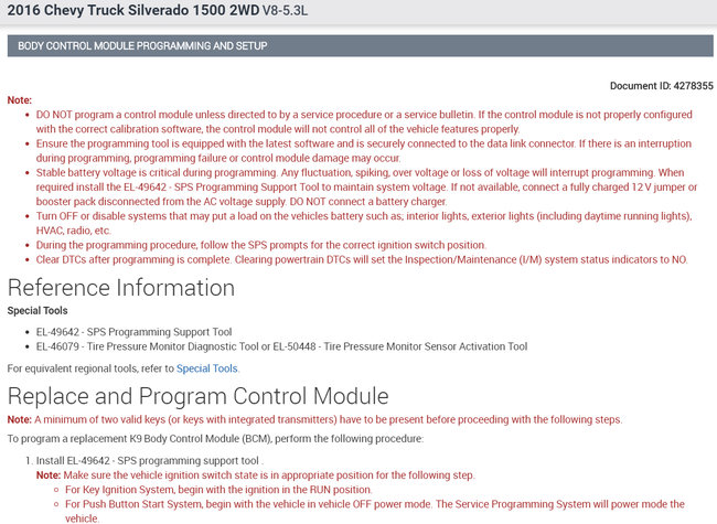

If the BCM is bad here is how to change the BCM out in the images below. Let me know what happens.

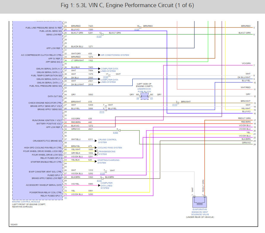

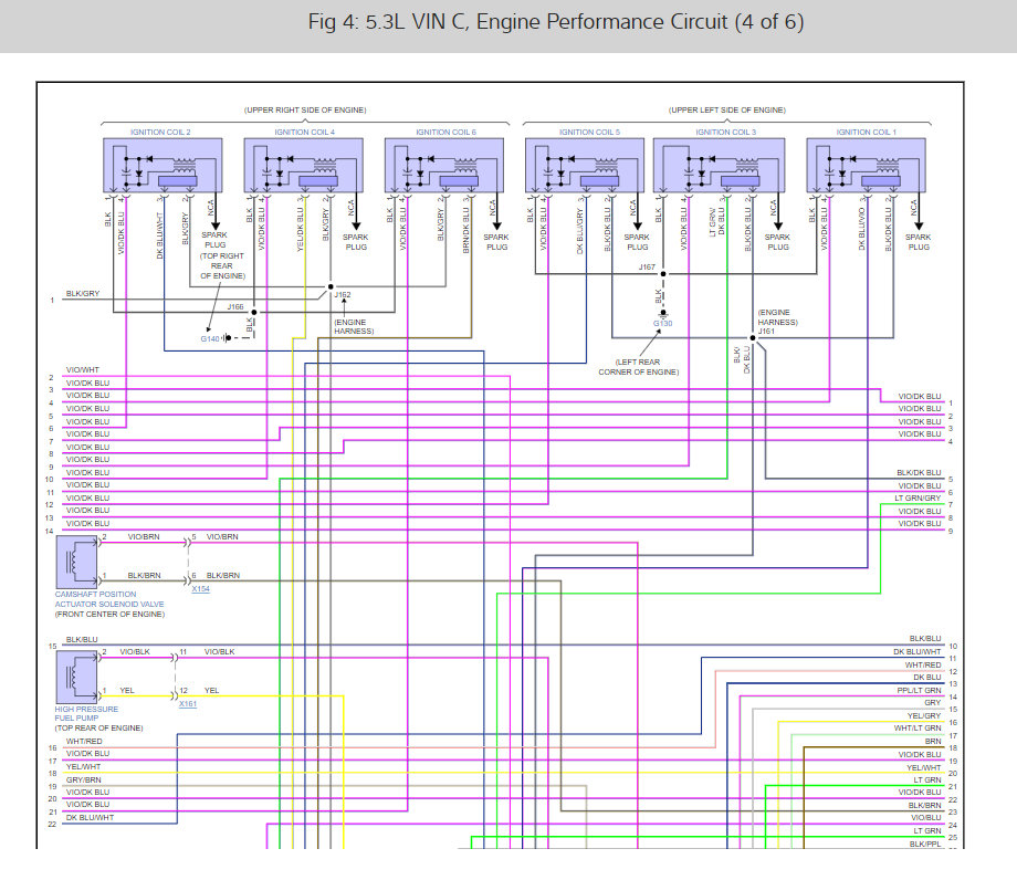

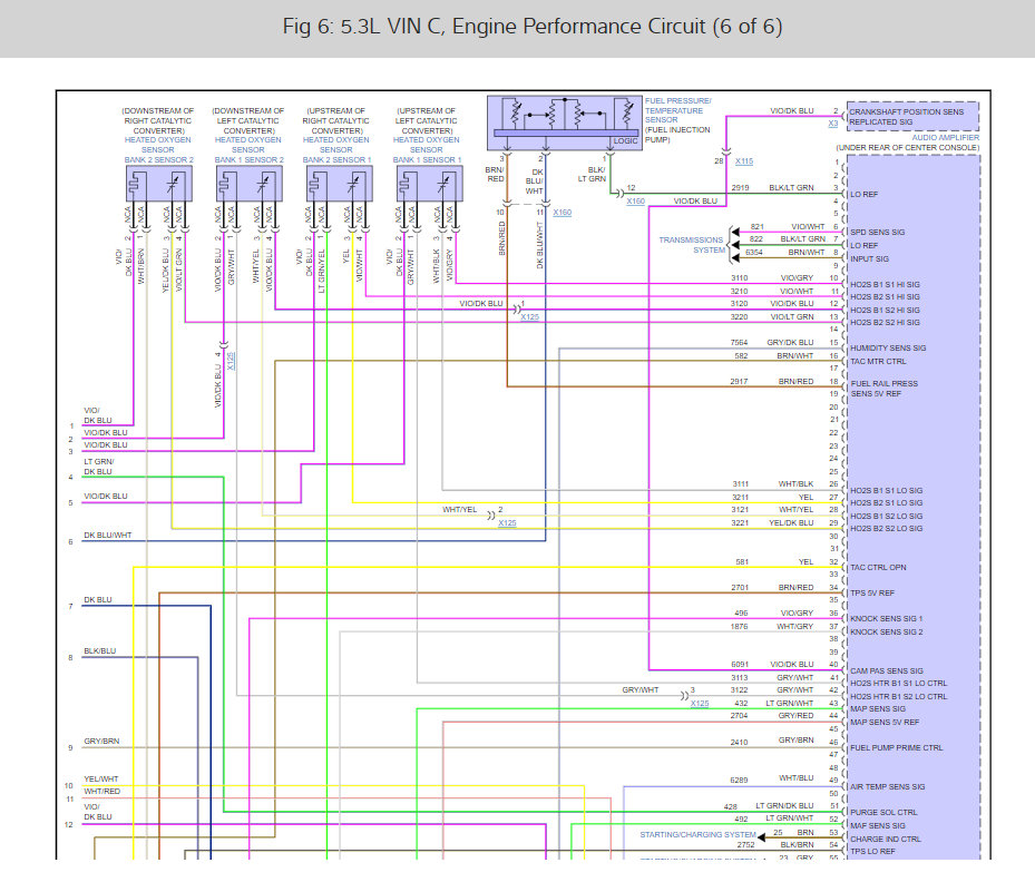

  • 55,797 POSTS

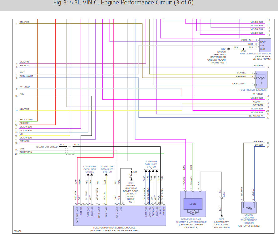

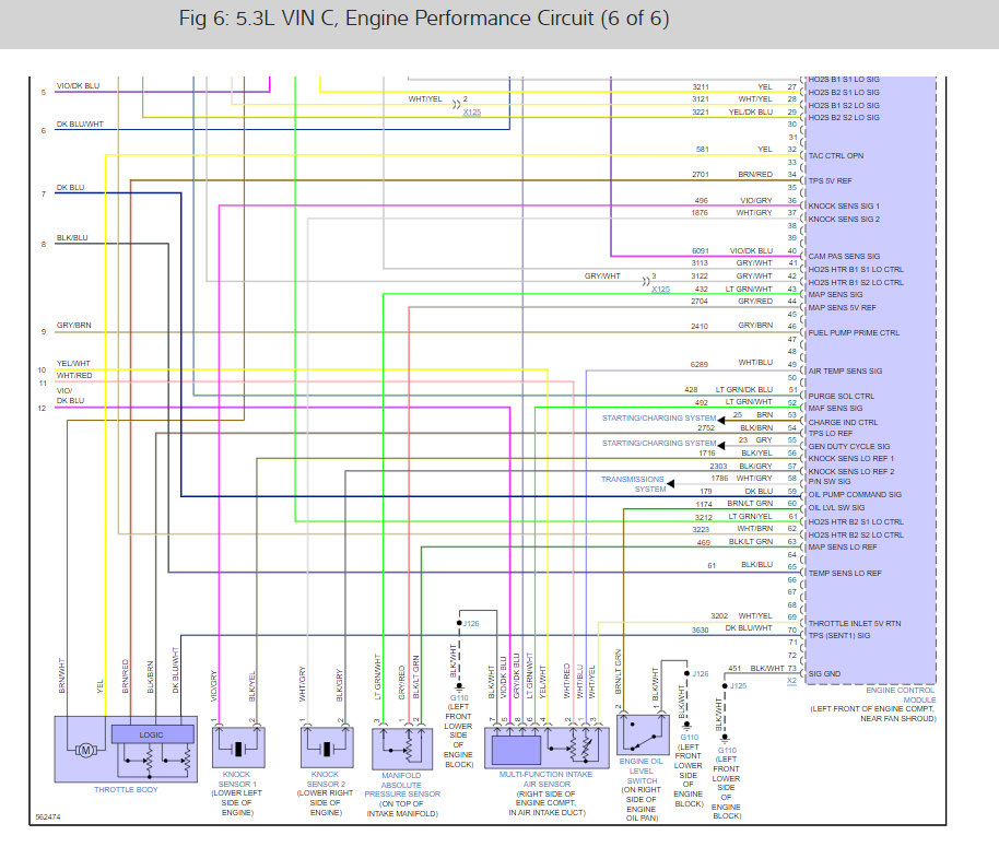

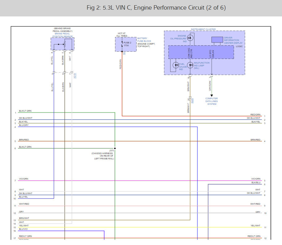

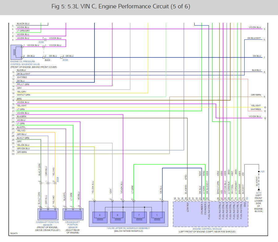

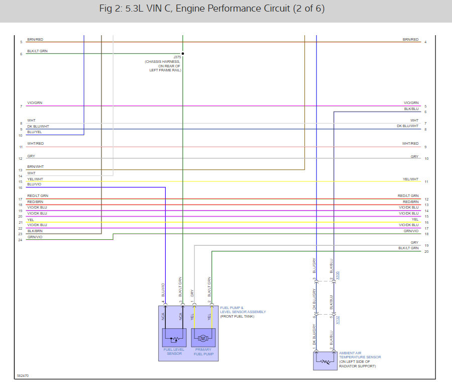

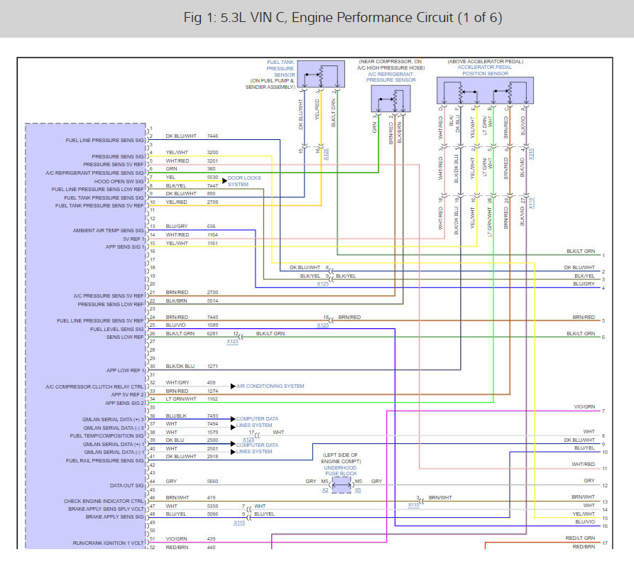

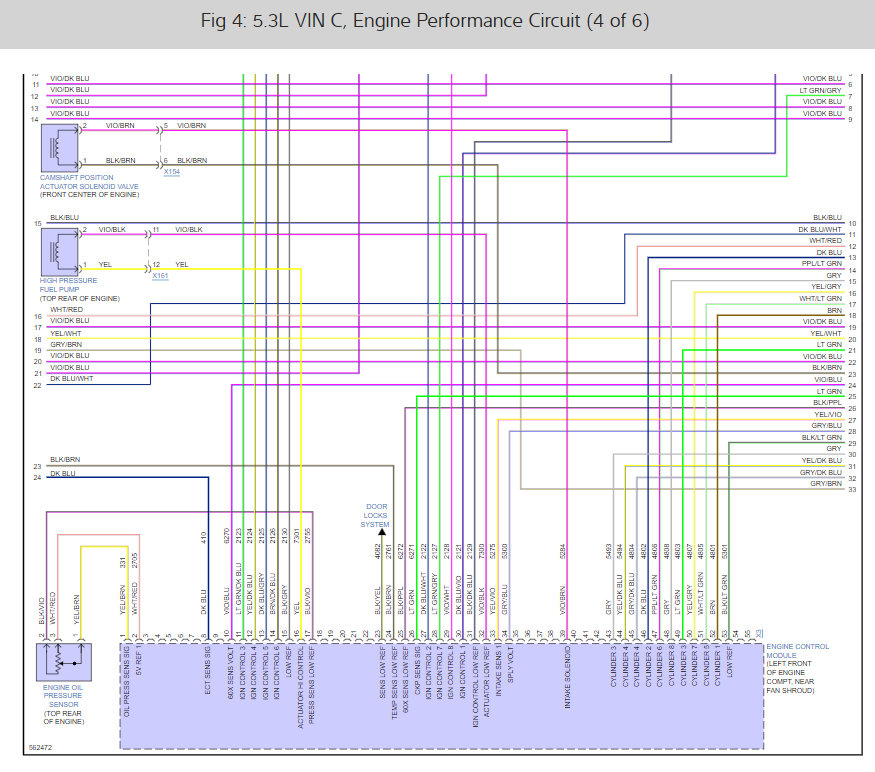

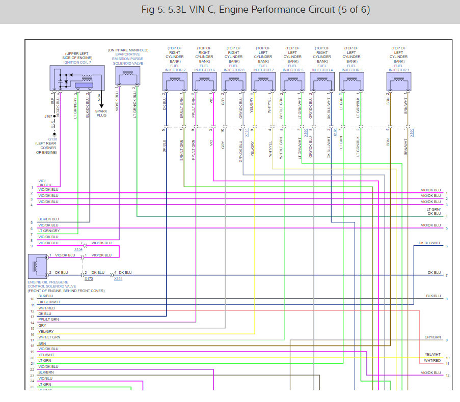

Will your scanner do a CAN scan and if so are there any codes? I see the fuel pump module in the engine wiring diagrams but not the fuel pump relay though I see the relay in the fuse panel. Here are the engine and PCM wiring diagrams so you can see how the system works. What is the manufacturing date of the truck? I don't see the crank/run, start relay either?

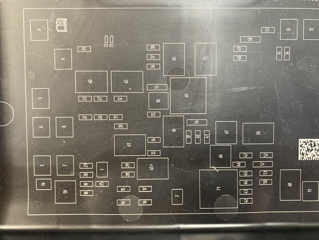

MINNERMP
  • 6 POSTS

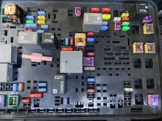

You can see in this fuse panel that number one in the upper left-hand corner is the starter relay and number two in the middle of the fuse block is the run crank relay and the relay in upper right corner of the small square one is the fuel pump relay.

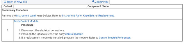

  • 55,797 POSTS

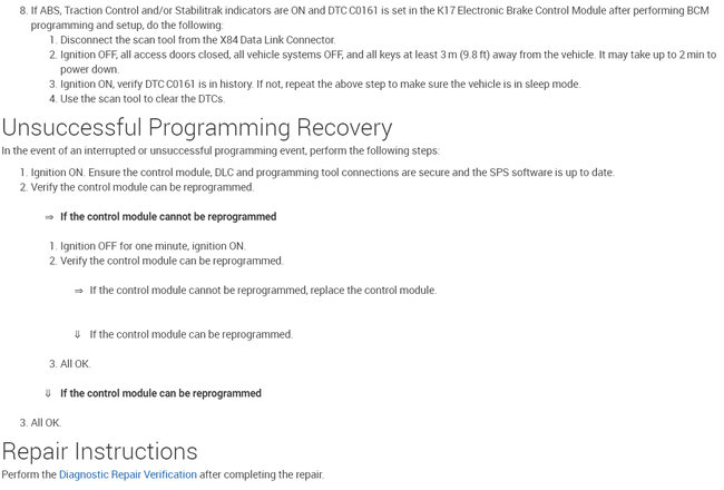

This leaves the BCM not triggering the relay. here is how you can change out the BCM which you can get programmed by searching Google.

I was kind of thinking that maybe it fried something in the BCM. I just wanted to make sure before I ask to replace it because it’s probably going to be expensive it has to be programmed..

I tried to change out the PCM with the one from my buddy's truck which is almost the same, but then I ran into an immobilizer problem.
Aug 25, 2022 at 10:23 AM
  • 55,797 POSTS

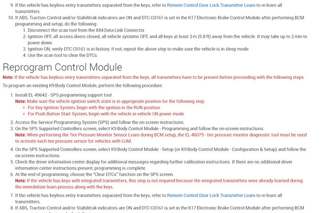

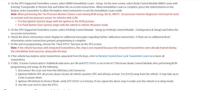

Yes, you mean the BCM right? the BCM needs to be programmed to the car and key. There are services online that will do it for you.
