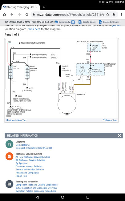

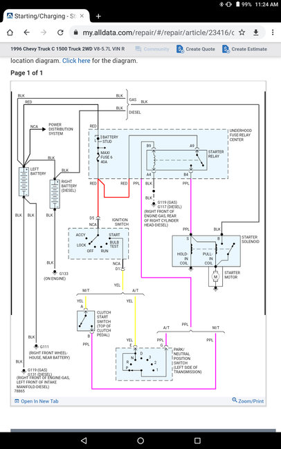

Is the alternator putting anything out while it's running? From the alternator post to battery negative. Do you need to leave the jump box on it to run? Here is the charging system diagram. You should have power on the black/red wire and the brown wire, this is one of those systems that keeps 12 volts on both sides of the bulb circuit until the alternator stops charging, that grounds the brown wire and turns the bulb on. Also check that fusible link. They get corroded inside. There's actually a lot of charging and electrical system technical service bulletins on this truck.

We haven’t been able to start it in over a week, this includes having the jumper box on it. And there’s very little to any noise when trying to start it. The battery shows a charge of 12.5/12.6 this is without the charger on it going out the next day.

Have you checked the 2 wires going to the starter? The black wire should be power at all the time and the purple wire is power during cranking. That's a good reading on the battery. You may have a wiring issue, you're going to have to check down at the starter. If you can reach check for power on the 2 wires at the starter and the negative lead of your multimeter on battery negative.
