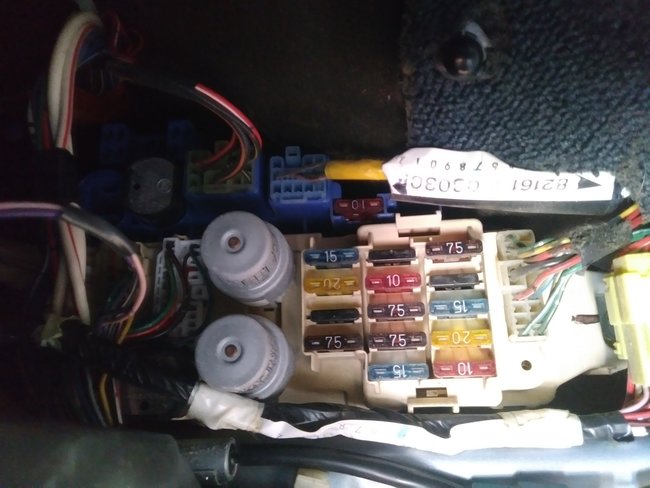

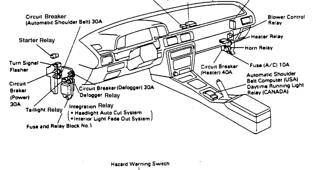

I got in my car the other day and turned key everything lights like they should turn to start and nothing. Not even a click. Getting power to starter and apparently switch but nothing from switch to starter. Can someone maybe tell me where relay may be at?

Good evening.
I will attach the location of the relay for you to view.

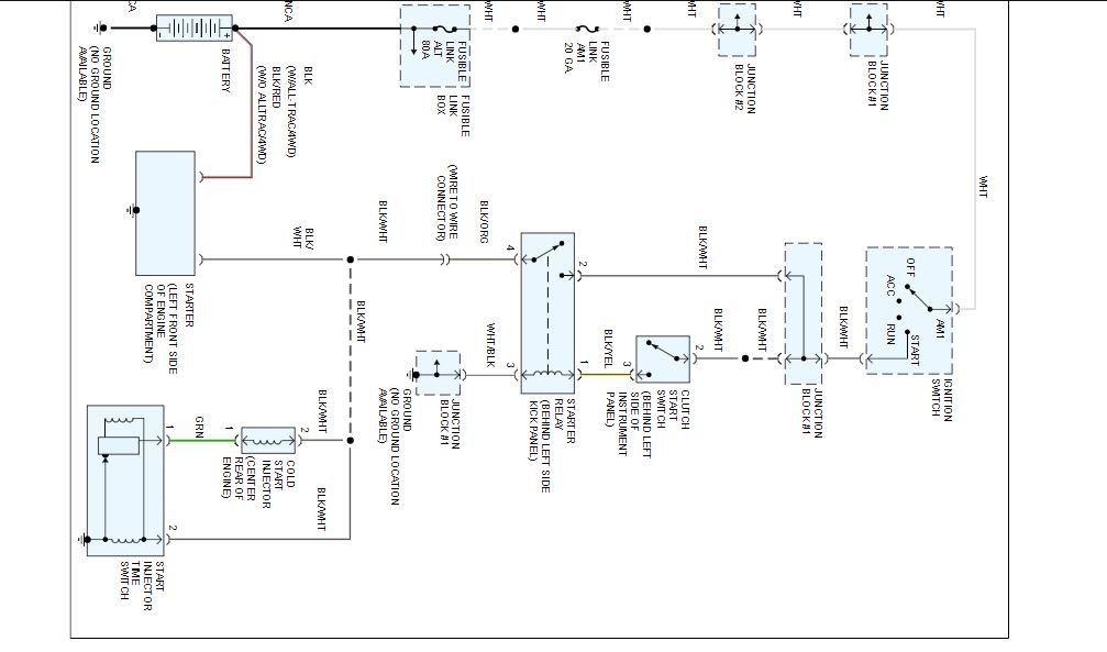

Check out the diagrams (Below). Please let us know what you find. We are interested to see what it is.

Yes, I tried moving shifter and still nothing. Battery tested 12.9, so pretty sure it is good. I just was not sure if one of the relays I found were the starter relay as I do not have cover with diagram. Will replace and let you know what happens. May be couple days as I am not in walking distance to parts store so have to wait on available ride.

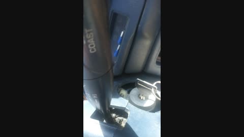

Well I haven't been able to replace relays yet but I did bypass and install toggle switch to start it with one wire plugged into where switch would plug into starter and my hot wire coming from an 30 amp fuse off positive terminal of battery excuse language please in video but she purrs like a kitten now thx for your information on finding the relays keep up the good work
