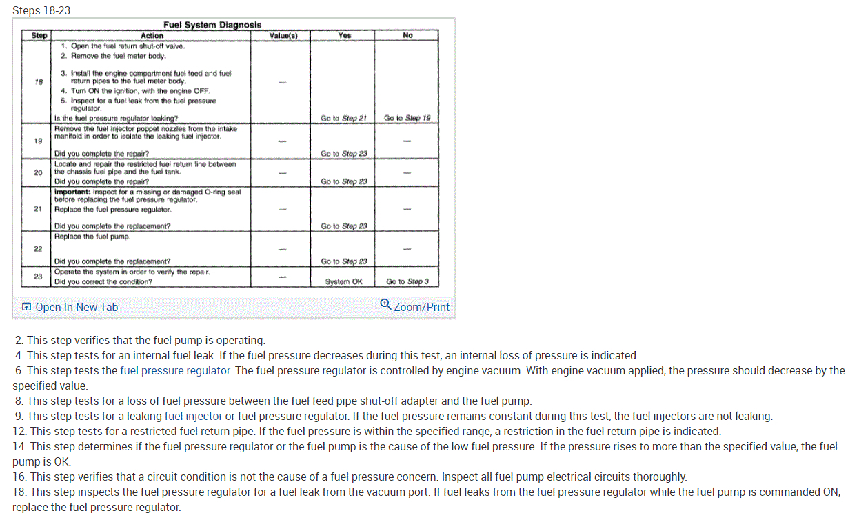

Replaced intake gaskets. truck fired right up no problems drove for about 2 days no problems whatsoever. Pulled in the driveway truck just shut off like I turned the key off. No noise shudder or anything now it will crank but wont start. Changed fuel pump, filter. It will start right up if I put gas straight in the throttle body. But will not run. I'm stumped. any help is appreciated.

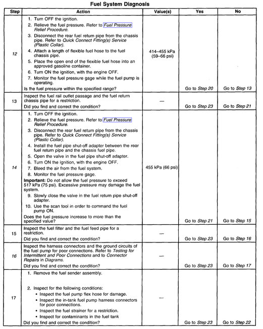

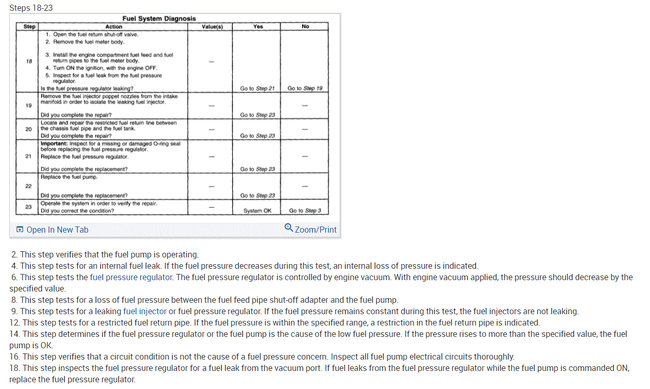

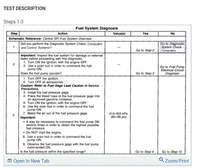

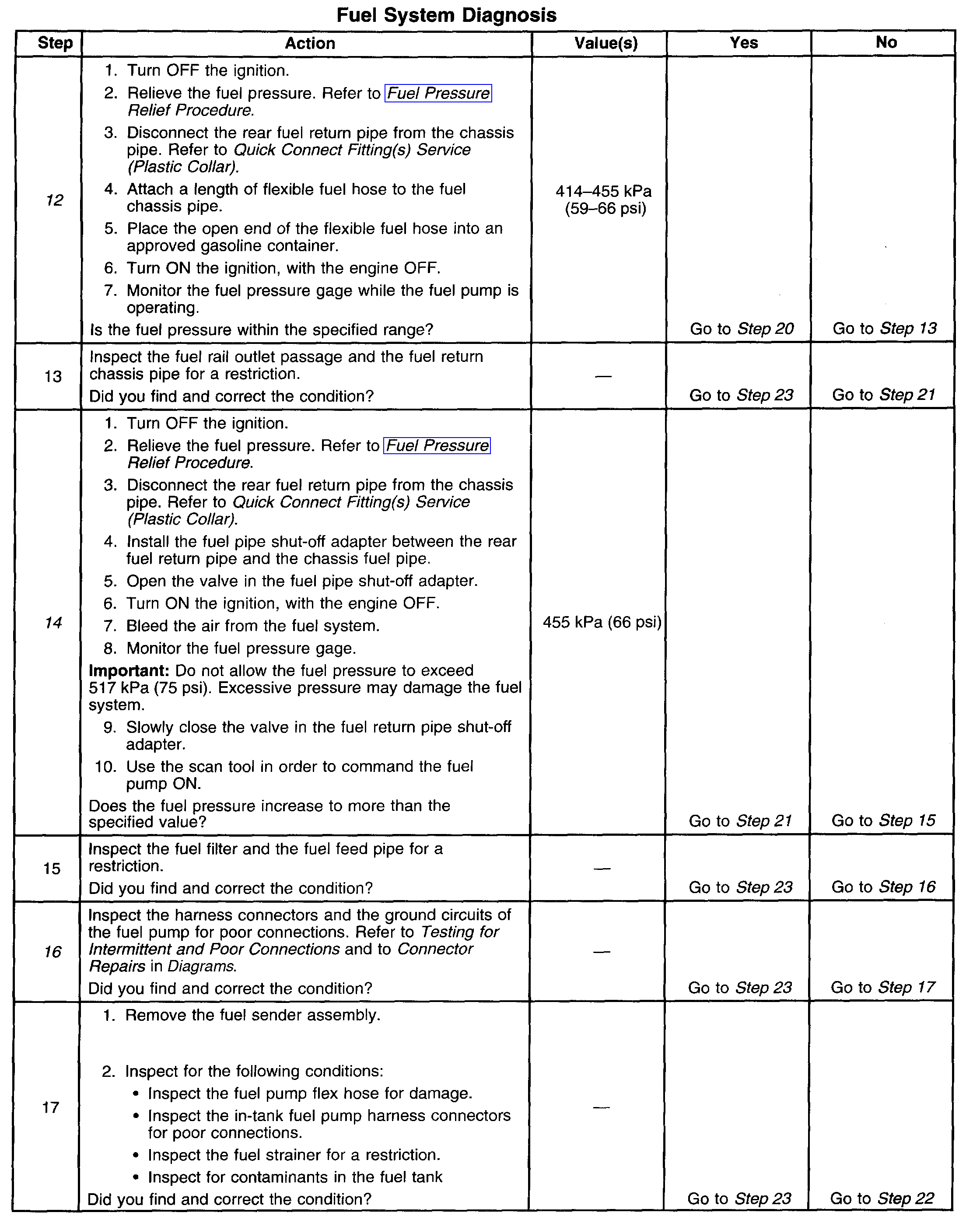

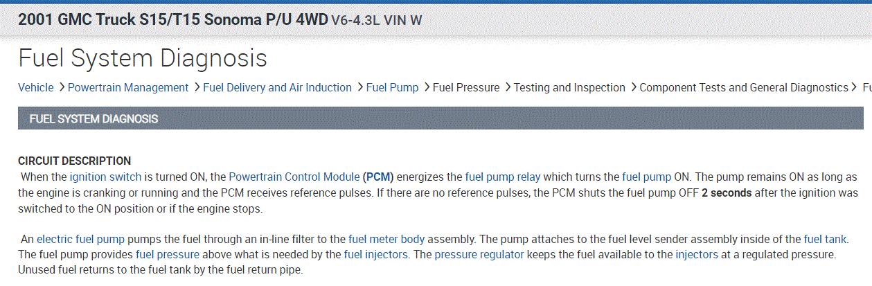

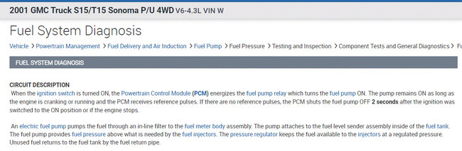

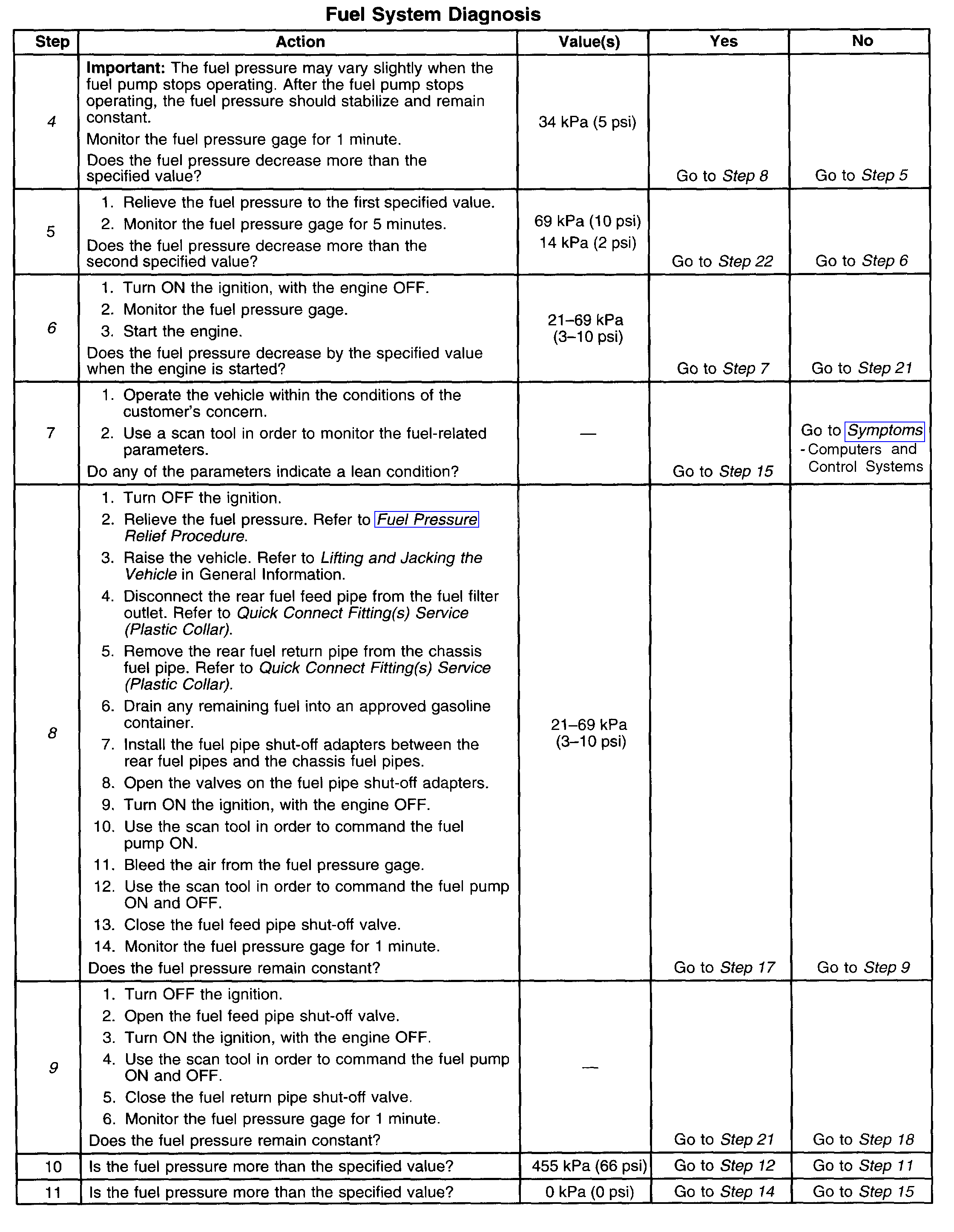

Have you checked the fuel pressure to confirm it is within spec? If not, here is a link that shows how it is done:
If you look at the attachments below, they include the diagnostics for fuel system problems. Since it starts when you feed it fuel, we know it is a fuel-related issue, so I thought this may be helpful.
