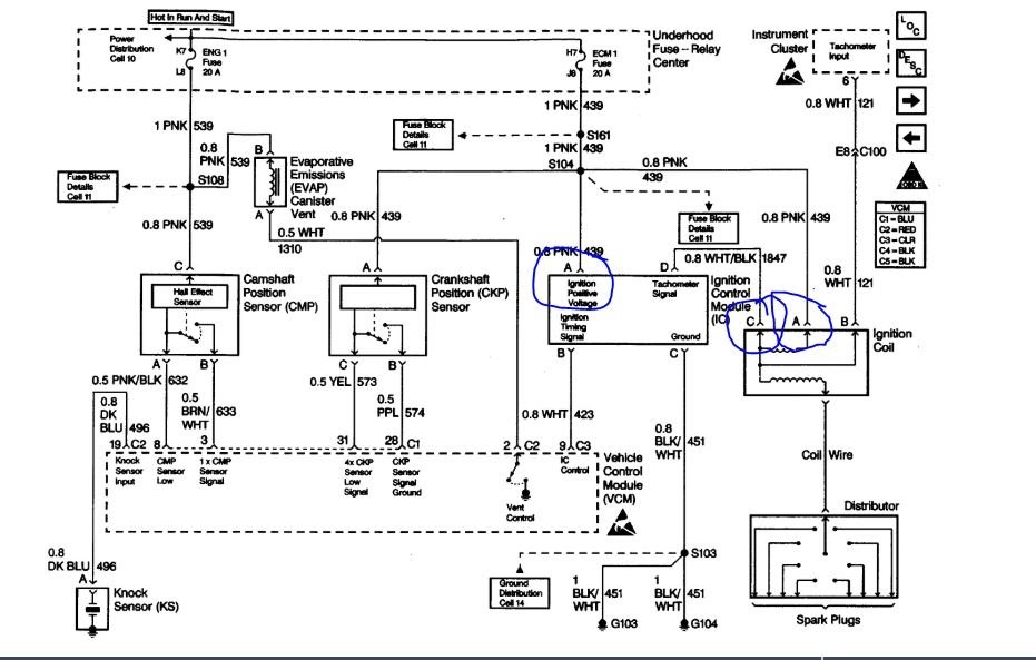

I replaced my distributor cap and rotor a couple months ago and truck hasn’t started since. I noticed the top of the distributor was rusty but was told that shouldn’t cause it to not start. Starter is new, but when trying to turn over it feels like it doesn’t even attempt to create a spark. Any ideas where I should start on this issue? Plugs and wires or ignition coil? Thanks in advance.

We need to do some testing at the ignition coil to see if the coil or module is the issue.

Okay, you can get a test light at a parts store for under $10.00.
:Let me know when you get it and we can do some testing.

Okay, check the white/black wire at the ignition. Turn the key to on and test to see if the light comes on.
If it does, go to the other side and the light should on as well. Then have someone crank the engine and the test light should flash while cranking.

Again, sorry it has taken so long to reply. With all that is going on right now, I was furloughed for a month. I was able to have someone help me look at everything under the hood and found I had no spark go to the ignition module. I was told to start with replacing spark plugs. Thanks for your help with this.

Hi, this is Tom reading your post this was running fine until you changed the cap and rotor? if so the problem most likely is right there on the distributor. it would be very unusual to have something fail from just changing the cap and rotor. Double check the rotor is seated correctly check the plug wires are in the right order, it's probably something right where you worked. I would double check everything at and around the distributor.

Did you do the test I requested for the coil?

This is done at the ignition coil.
Please read my response on how to test it. You need a test light and a second person to help.
This was my response.

The easiest way to test spark is to pull a plug wire stick an insulated screw driver in the end of the wire and hold it next to a metal spot on the engine. Then have someone turn the key and a spark should jump from the screwdriver shaft to the engine. If no spark on a plug wire then go to the ignition coil wire, the center one and do the same thing.
