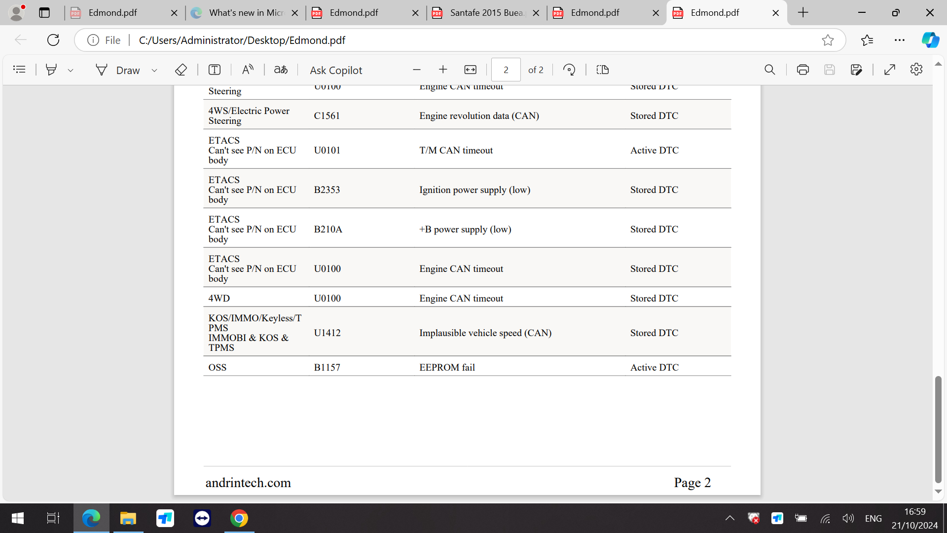

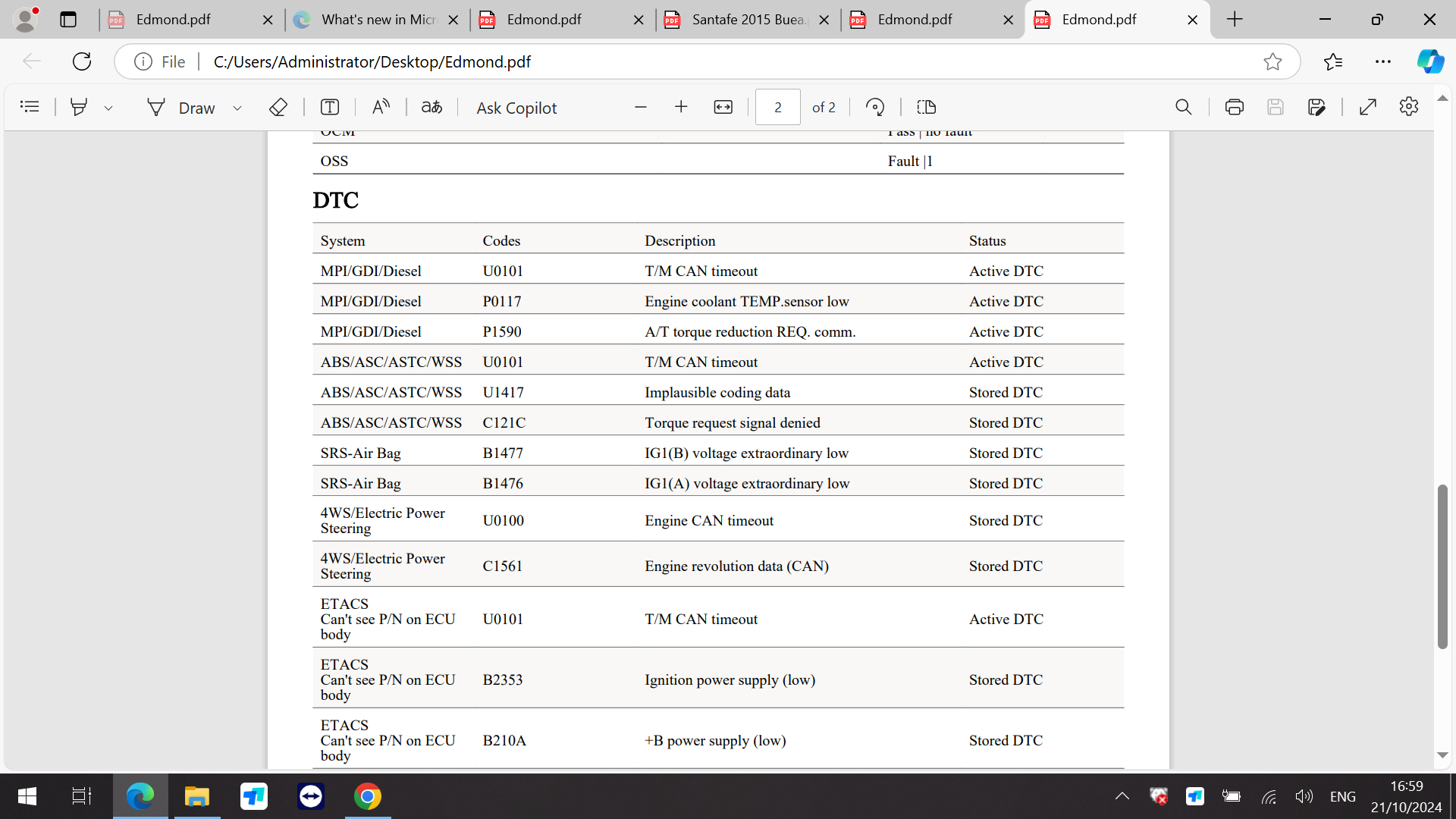

Hi, please i need a great help on this Outlander Sport. VIN 4A4AR4AU0EE028967. The engine won't run over when the push button is pressed and the brake-pedal. I have attached the Diagnostic report. Please help me to analyze and with some diagrams for the can bus system to the Transmission module.

Please clear the codes, then turn the ignition system on without trying to crank the engine over and then run the codes again, this will give us the most relevant codes. Let me know.
