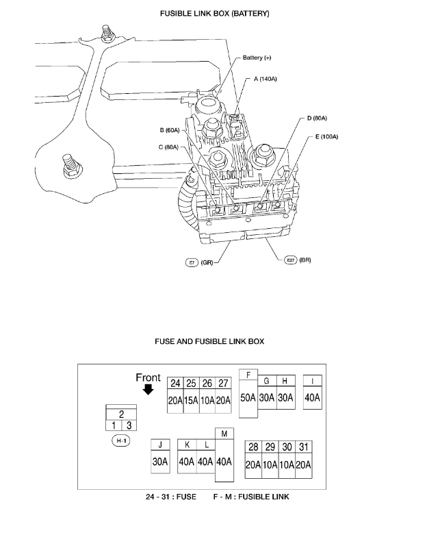

Will not crank will not start there is no power with battery fully charged. nothing has no communication with ignition or engine.
Sep 13, 2022 at 1:15 PM
  • 55,433 POSTS

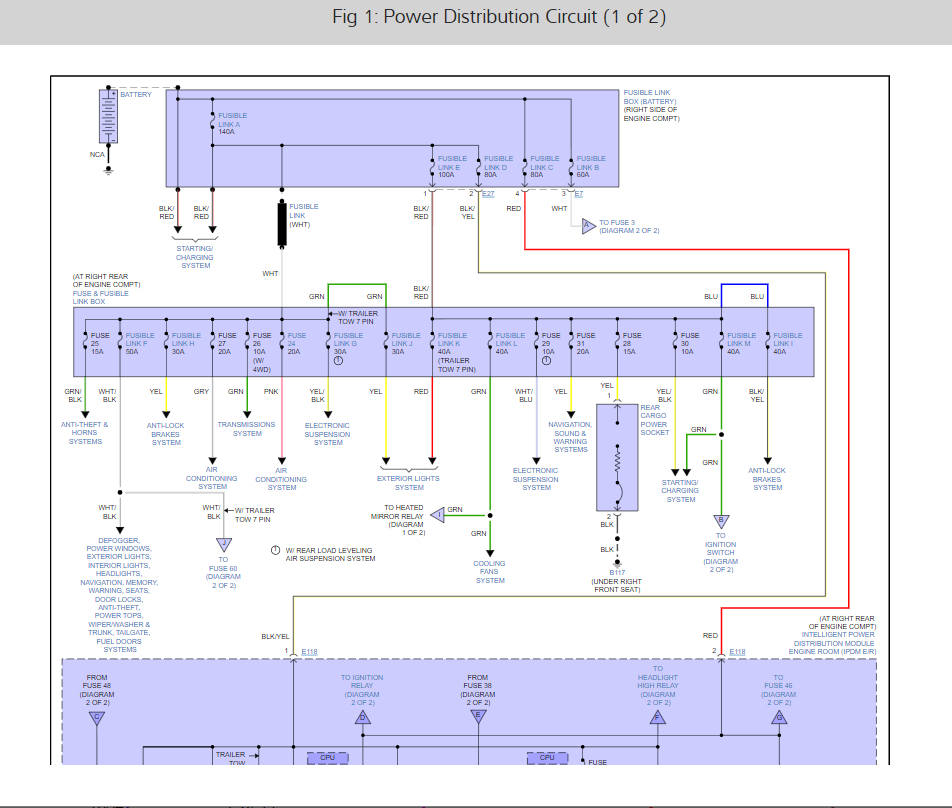

We need to check the fusible links. here is a guide to help you check for power and the fusible link locations below. Also, I have included the wiring diagrams for the links so you can see how the system works. And let's clean the battery cables.
and
Check out the images (below). Please let us know what you find.
