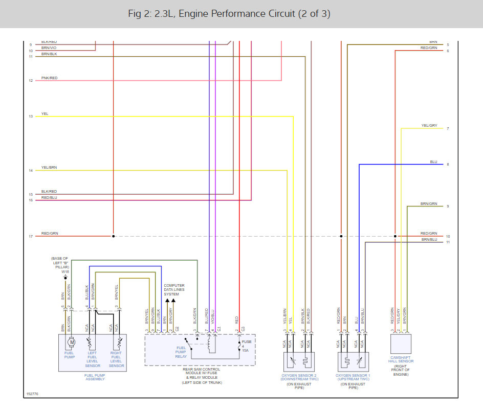

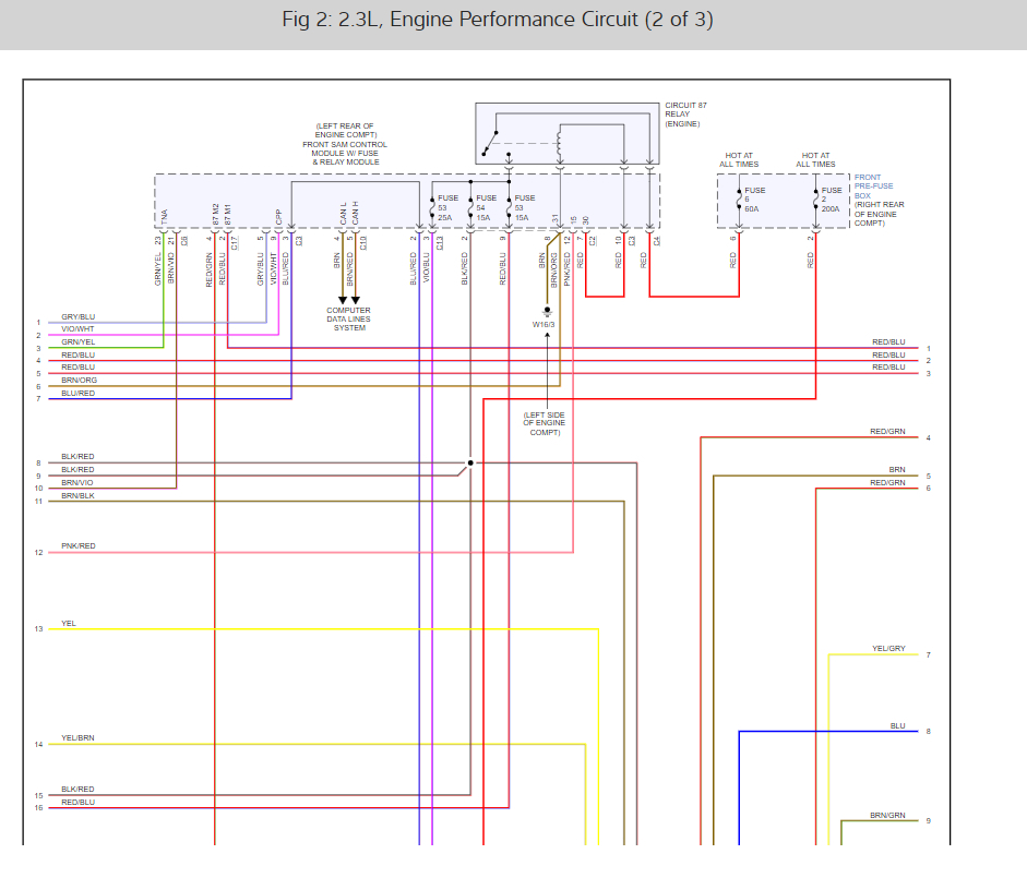

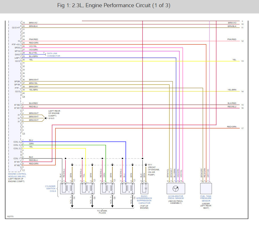

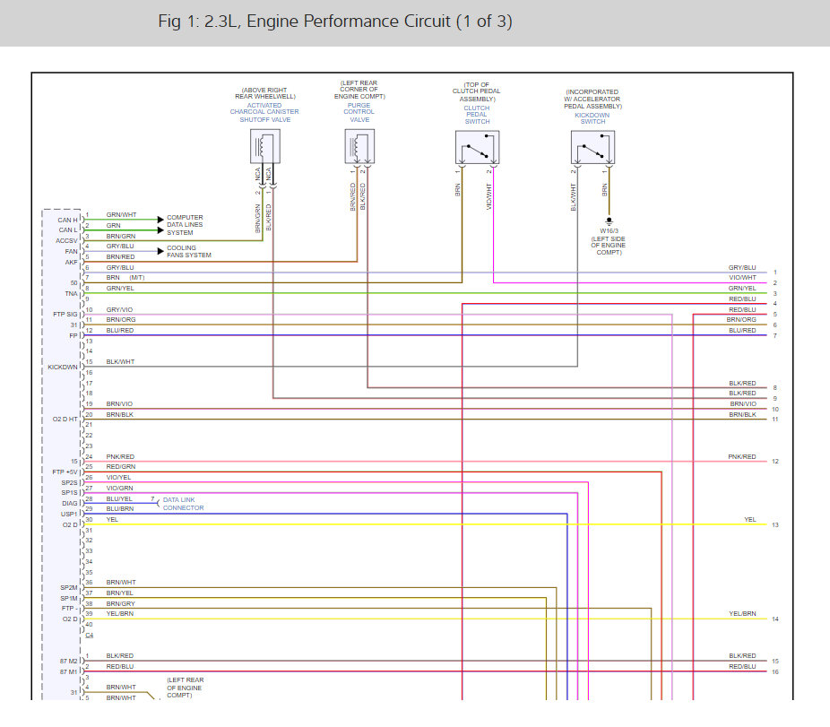

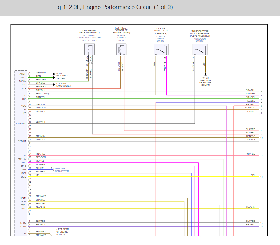

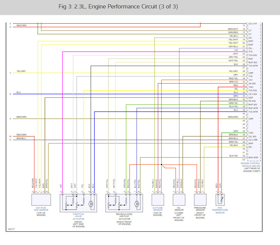

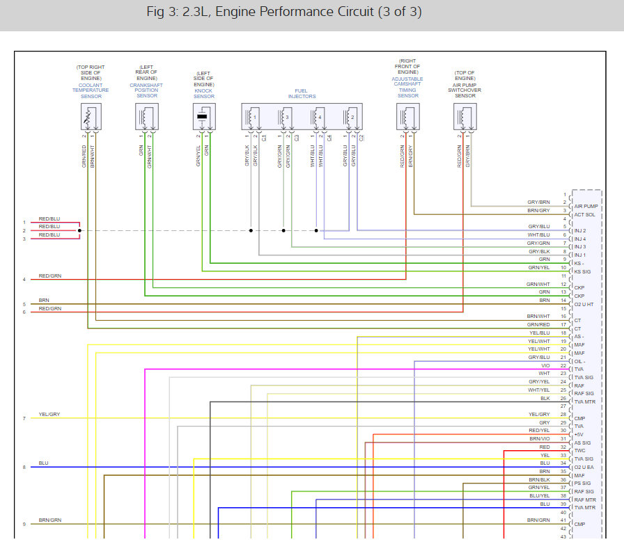

I have no current going into the ECU. Please can i have a chat diagram for the ECU pin out, electrical diagram to follow the ECU voltage. Thanks
Dec 28, 2020 at 10:02 PM
  • 55,710 POSTS
Here is the ECU and engine wiring diagrams which show the fuse and grounds to make sure the system is powered and grounded correctly with a guide to help you test the wiring as well.
