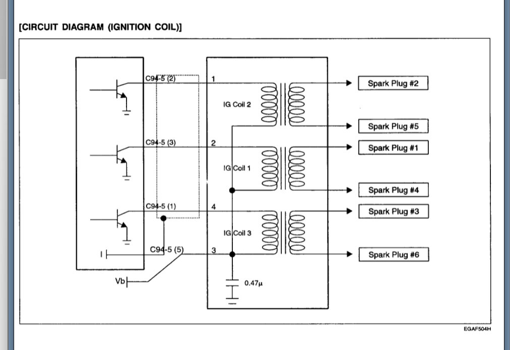

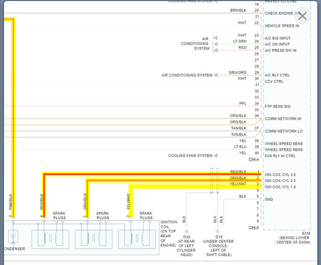

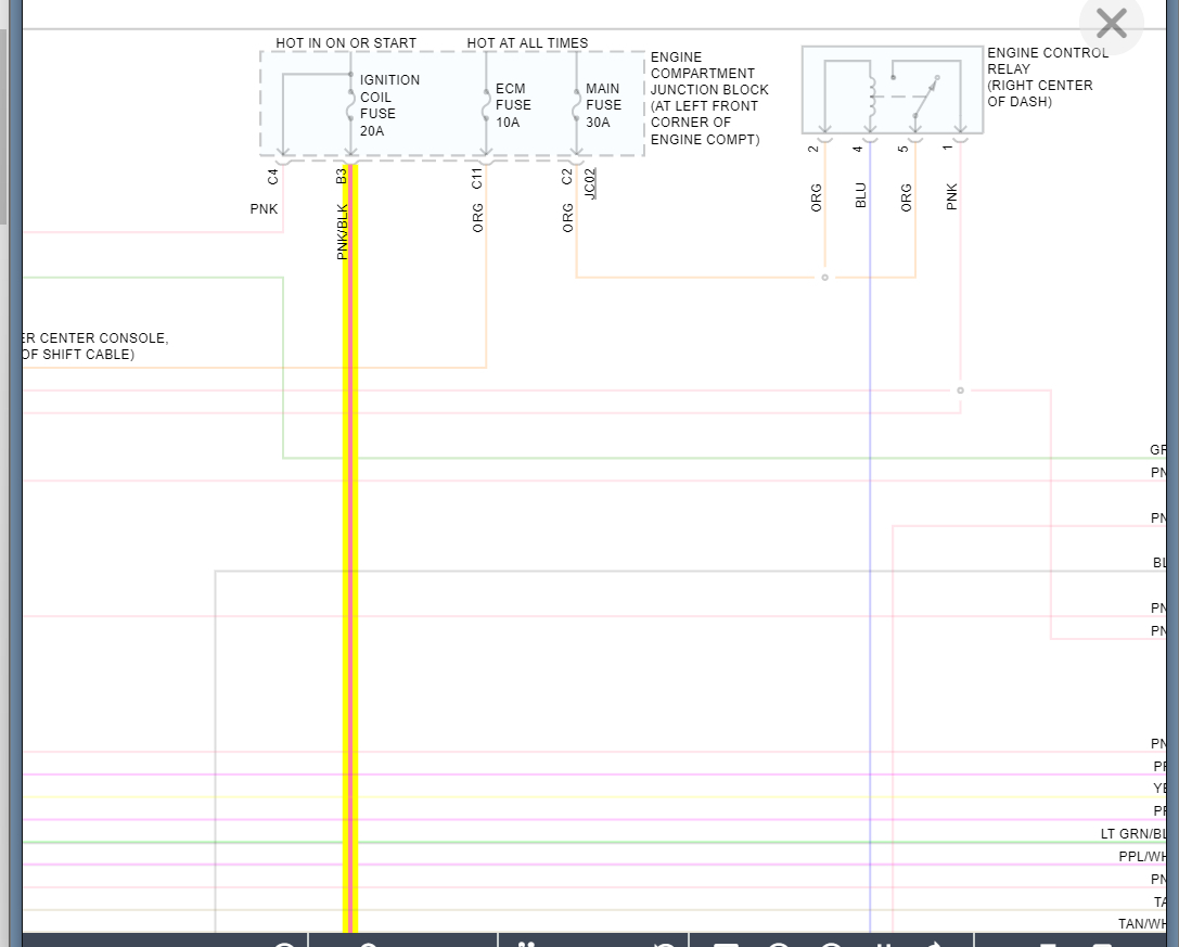

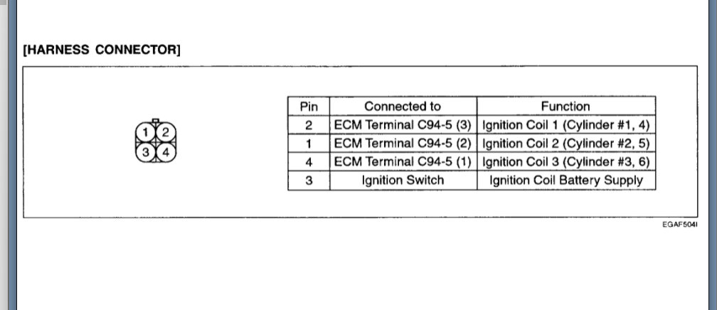

What color of wire on the 4 pin coil pack goes were on the plug
Oct 31, 2021 at 11:12 AM
I assume you are meaning the layout of the wiring within the connector.
If so, I am attaching this info below. Here are a couple guides that will help with this:

Below is the info you requested. Thanks
