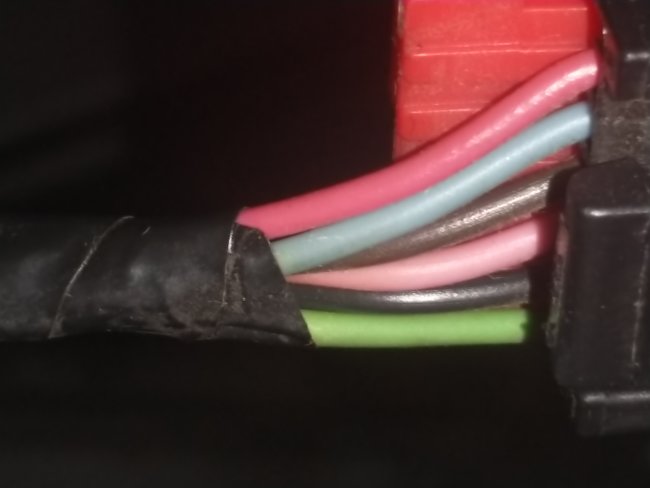

I've got a no start it cranks and a brand new starter, brand new battery, brand new battery cables, and a brand new BCM. I've checked the fuses, the relays, replaced all those. I even took off the panel and send it down anything that looks like a previously blown. my serpentine belt is brand, new brand new timing chain, top dead center was reached. it turns like it wants to start but it just will not. I sprayed some stuff still going to start. I bought this car used I have found under the dash panel at six pin that I have no idea where it goes to it's light green brown black pink red and gray it's attached to the wires that go to the BCM but it's it's off on its own. does anyone know where this goes? is that my cause or is that my reason? I have been working on my car for 5 months I need to be done.

This is it here:

Just to be clear, this is a connector that plugs into the BCM or the other end of this is plugged into the BCM but this connector that is leading to something else is not connected?

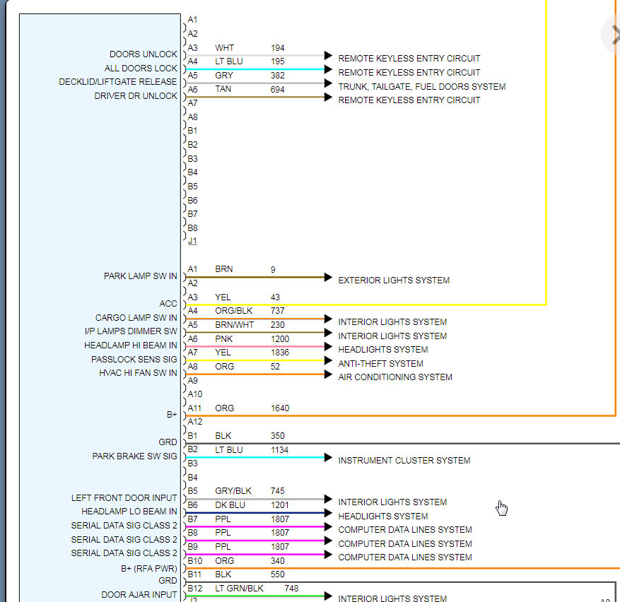

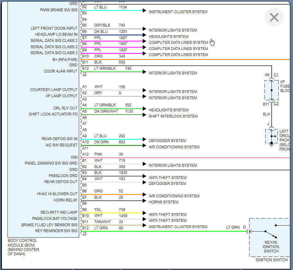

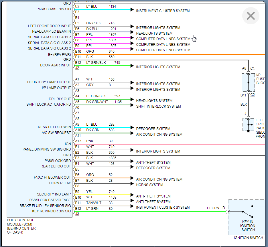

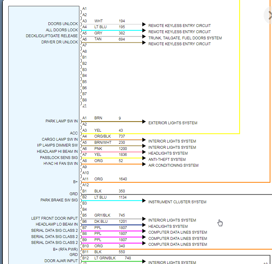

I attached the wiring diagram for the BCM. Some of these wires match but not all in one connector with just these 6 wires so I am thinking it is an inline connector.
Where exactly is the connector hanging? Can you find any components that are within the reach of the connector? Where ever it goes, it should reach pretty easily.
Let us know about this info and we can go from there. Thanks
