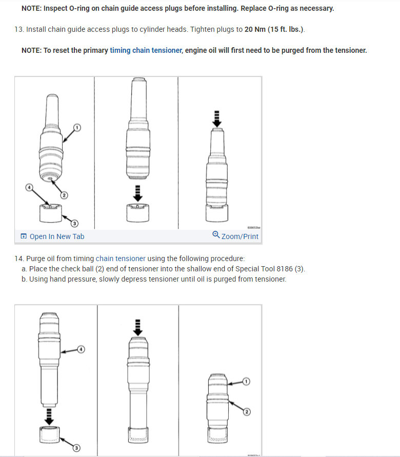

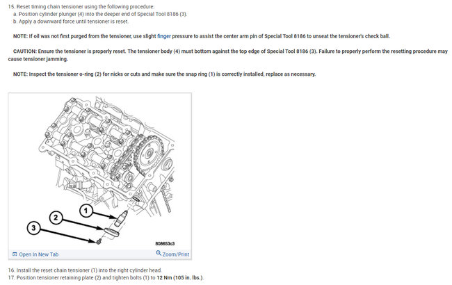

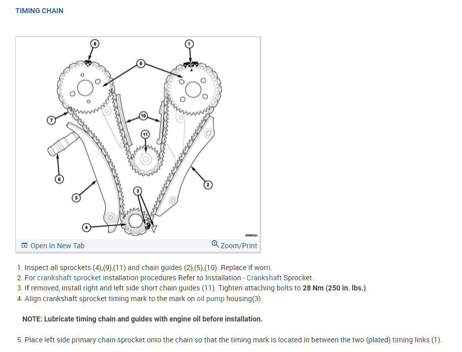

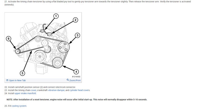

No start after I changed out the timing chain, codes b212d, U1415, U1414, and P0706
2007 DODGE CHARGER
200,500 MILES • 2.7L • V6 • 2WD
DARYLPASTO
  • 6 POSTS

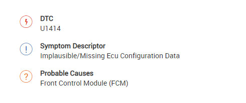

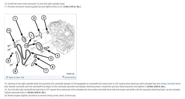

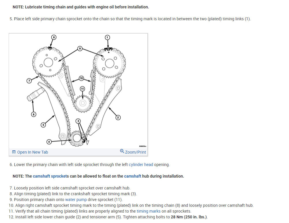

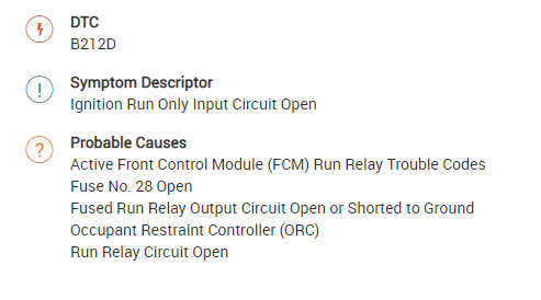

Seems like it wants to start up at first but then cuts out. I did ask and I can look for codes first car with a b212d ignition run only and input circuit open. Second code U1415 missing data.Third U1414/missing control unit network. Fourth P0706/transmission range sensor. I checked fuses and relays found nothing blown. Is there something connecting them together. I'm stumped.
Jul 21, 2021 at 4:20 PM
Good morning,
I would first start with a compression test to be sure you have the timing correct. If the timing is not correct, it will not start. The compression should be 140-160 pounds on all cylinders
Did the old timing chain fail? If it did, there is a chance of damaged valves as this is an interference engine.
The other codes are for the restraint system, not the engine system.
