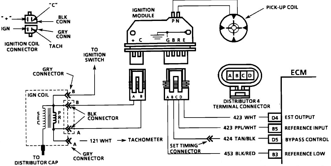

I'm getting fuel and spark to the distributor but not to the plugs ive checked and cleaned the grounds I've put all new parts n the distributor still the same so I put a whole new one in nothing changed so I put a new computer new electronic spark module on it and it's still doing the same and everything in the distributor has power and it has no crank sensor

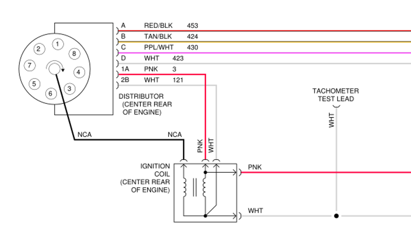

I would suggest next testing the wiring from the distributor 4 pin connector to the PCM.
Also see wiring diagram in picture below.
Pin A, red/black wire to pin B3 at PCM Distributor reference low
Pin B, tan/black wire to pin D5 at PCM IC bypass
Pin C , purple/white wire to pin B5 at PCM Distributor reference high
Pin D, white wire to pin D4 at PCM Ignition control
How to test wiring.
Hope this helps.
Cheers, Boris
