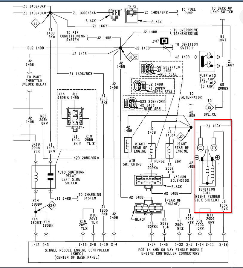

The engine does crank over. found a wire lead going to the positive side of the coil not connected to nothing. had a local garage work on about a year and a half ago. my guess is that they ran that to a source in the cable harness , the problem is that it is a pink wire that doesn't show a broken pink wire on the fire wall harness. there was a broken wire in the harness that smoked when I tested it. the truck was blowing fuses the crank no crank problem. it's a great truck when running. would you happen to have a good shop wiring diagram?
Mar 31, 2020 at 5:43 AM
Yes. We have access to OEM and aftermarket diagrams, however we will need to narrow this down a little to be able to send you what you need. Otherwise I will be sending a ton of info. You said the wire is coming from the coil but as you can see on the diagram attached the coil only has two wires and neither of them are pink. I suspect they added something or someone did and just picked up 12 volts from the coil to run whatever it was. Clearly not something we want to do so I assume we may not find it in the wiring info.

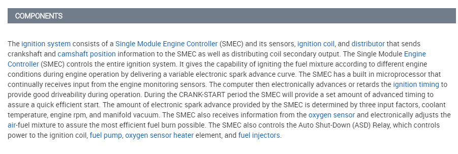

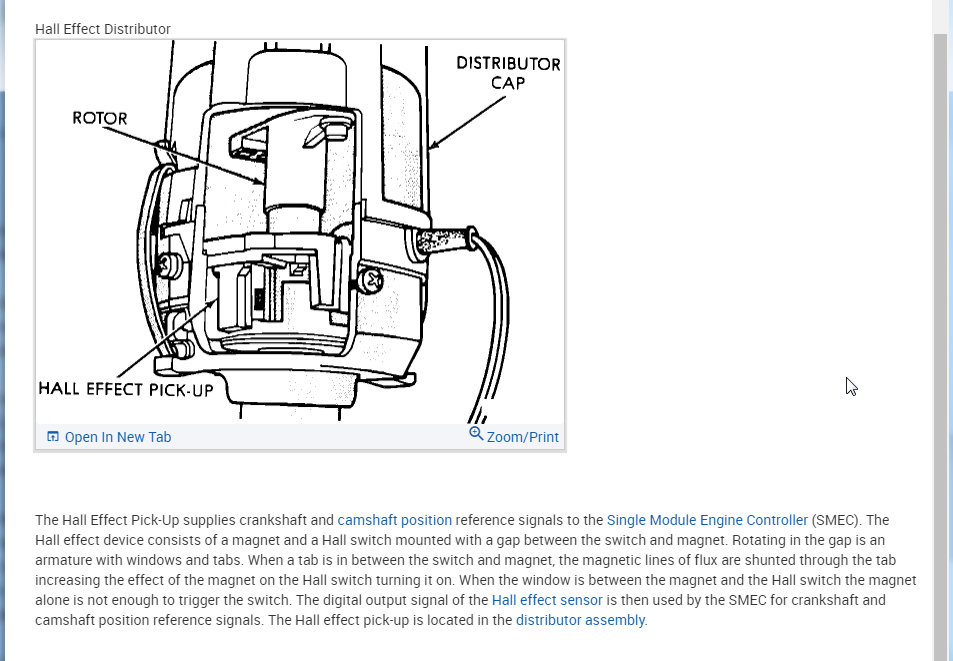

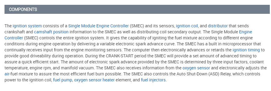

When you say it was blowing fuses for the crank can you tell me what fuse that was? You have an ignition system that has the distributor which acts as a crank and cam sensor. It sends the position to the SMEC. See the attached info.
Since the engine cranks we need to start with checking for spark. Just pull a plug wire and use a screw driver or hold it close to a bolt and see if there is a spark. If there is spark, spray some starter fluid in the intake and see if it fires.
