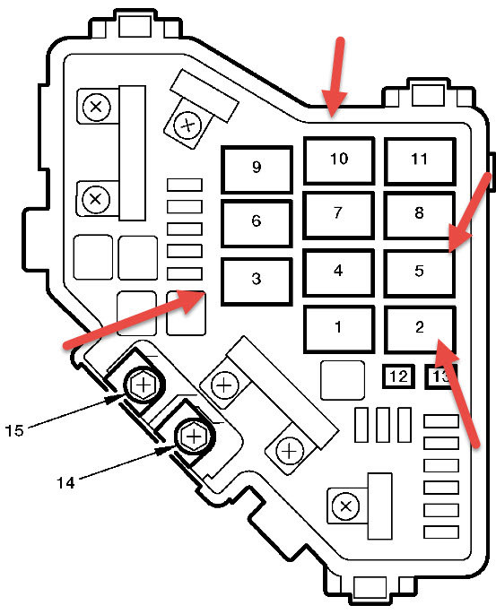

HMAC300
  • 48,601 POSTS
yes both models are there are two so I kind of doubt it's a filter probably a weak pump.see pic #2 is ignition coil rest are pgm relays. see article for relay test
Mar 11, 2021 at 10:09 AM

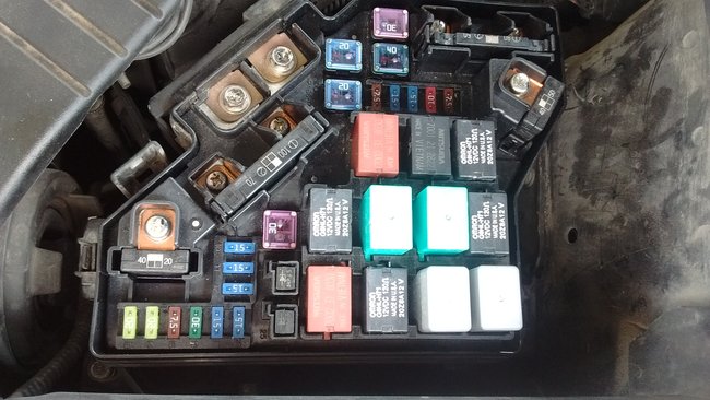

KARKID19528
  • 12 POSTS
the fuel pressure at 45-47 lbs when key on is low? on the image, what are 14 and 15? and relays 1,3, 5 and 10? I am sending you images of the fuse box and lid .
KARKID19528
  • 12 POSTS
Aren't the fuses for the main and pgm next to 15 and 14?
KARKID19528
  • 12 POSTS
I checked relays 2,3, 5 and 10. They click with the key on and I remove and replace them. I have spark at the plugs, injector pulse when I test with testlight while cranking engine. fuel pressure at 45 to 47 lbs. with key on. what do you think?
