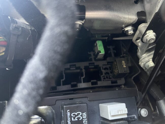

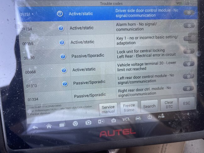

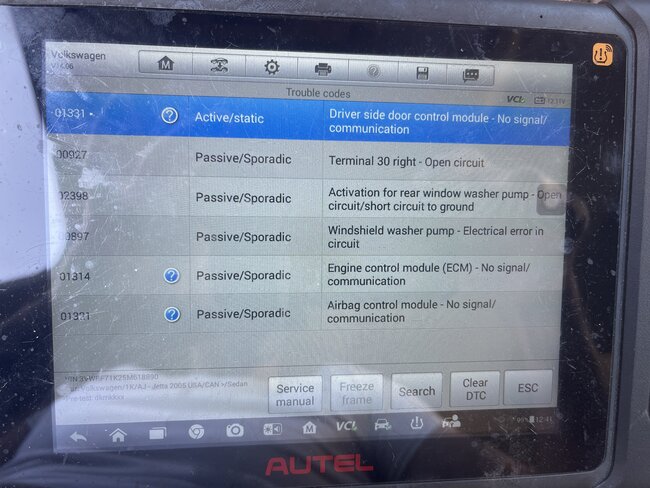

a friend is moving to another state and towed this car to me to sell it after fixing it. Basically he started having issues with it with regards to starting. It's manual, if he pushes the car and put it in gear it will start, but when you turn ignition on and try to start it , it won't turn over. I read the codes and they were all over first because the battery was disconnected and car was parked. He said the starter connector is loose. I checked it and you can easily remove it and connect it without hearing a click as I think the tab is maybe broken to lock it in place. I tapped the starter with no success. I want to see whether the wire has any signal first, I can't remember whether this wire has one or 2 wires, when should I see a signal? upon starting or as soon as ignition is on? also, is it possible the clutch pedal switch has an issue?

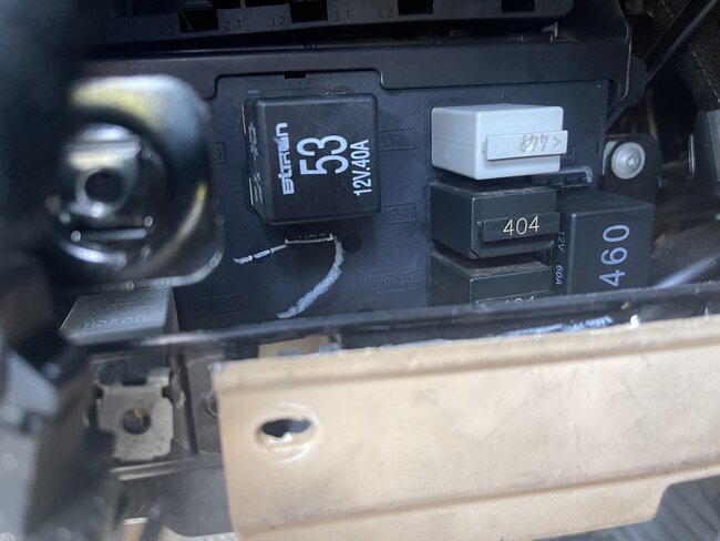

no power to starter wire, and the relay if right is clicking.

attached. and there is no clutch pedal switch on this one

also, windows open from each own switch but not the main switch, gas door does not open not sure if its electric as it has a small lever. radio and A/C blower work, trunk does not open , mirrors do not work.

deleted all only thing left was the driver door code, so not sure.

Sorry for the repeat, the site had issues but it is fixed now. No codes will make the engine not crank over, I would check the fuse # 15 in the3 fuse panel under the dash for power while the key is in the crank position. This guide can help:
Please go over this guide and get back to us.
