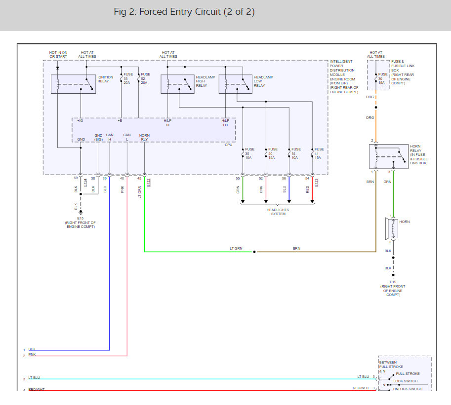

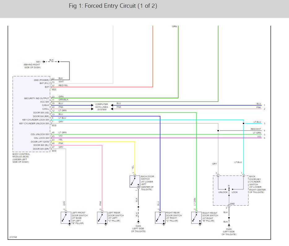

  • 55,732 POSTS
It sounds like the car battery could be weak losing the memory. lets try load testing the battery by following this guide:
Jun 12, 2019 at 9:16 AM
CHECKEREDFLAGLI
brand new battery, still the same.
Jul 8, 2019 at 10:11 PM

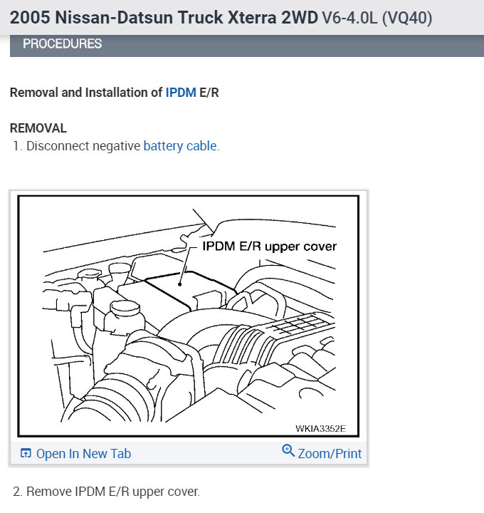

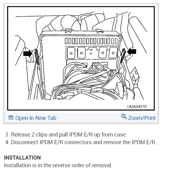

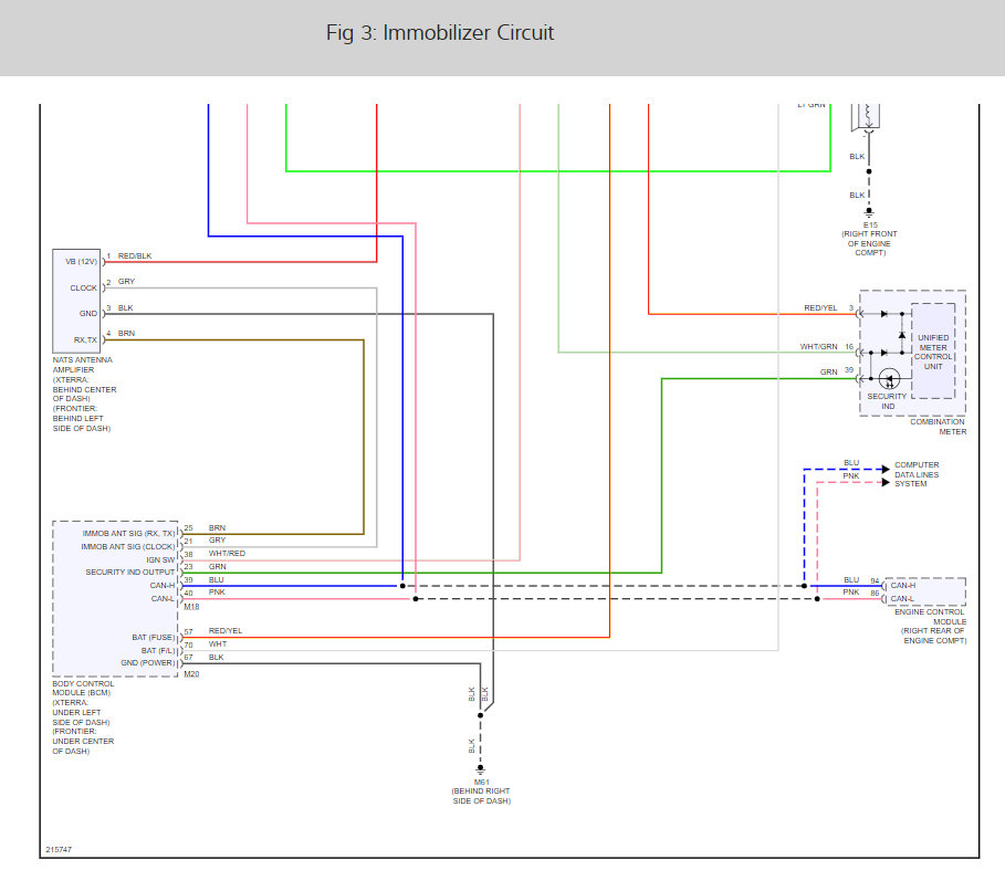

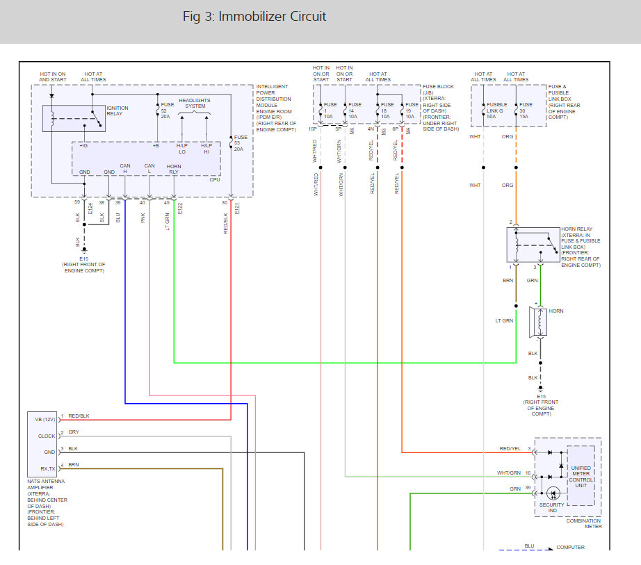

  • 55,732 POSTS

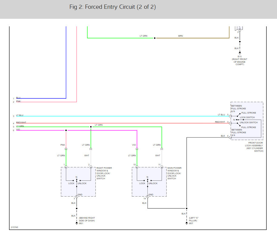

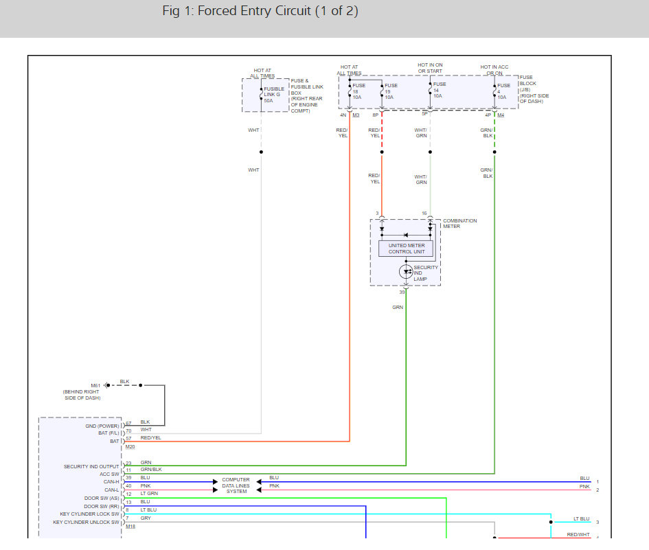

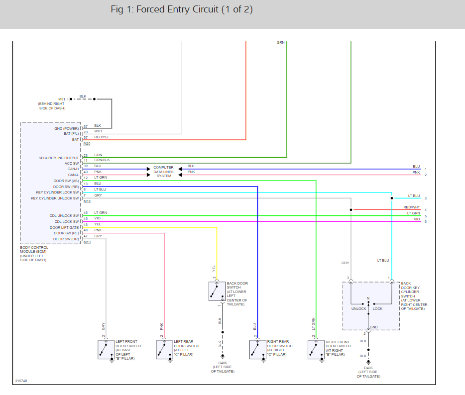

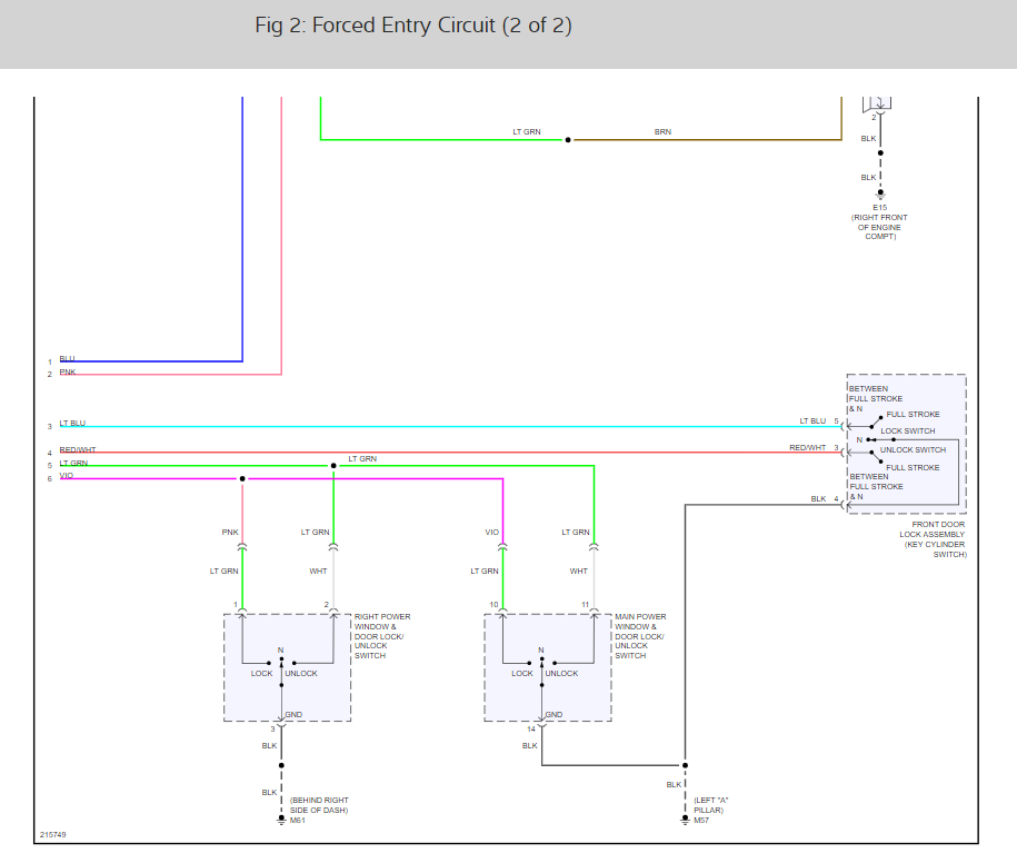

These cars had problems with the IPDM which it sounds like is the problem with your car. Here are instructions on how to change it out and the location of the unit with wiring diagrams that show you how the security system works. I would use the wring diagrams to show you which fuses to check (bunch of them).
