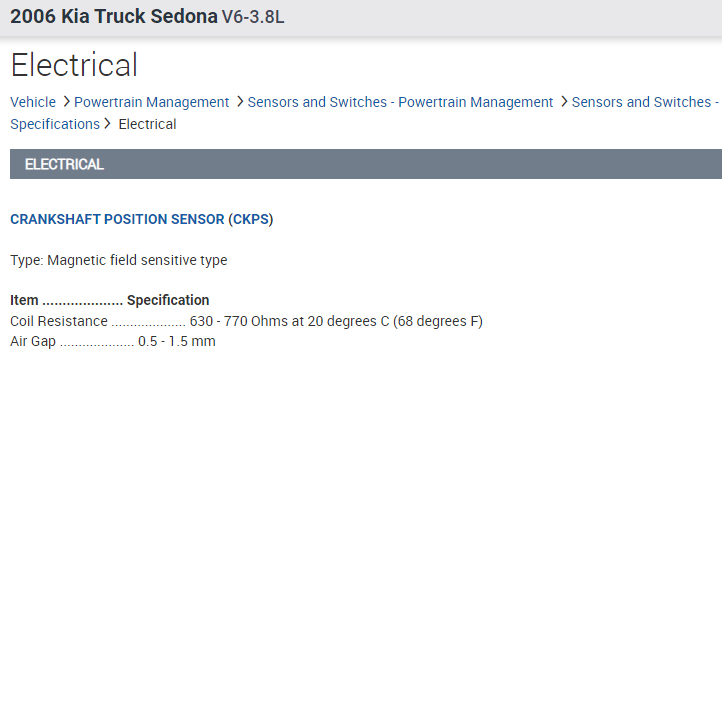

One of the symptoms of a bad crank position sensor is stalling as you are driving down the road.
Typically the engine will crank but not start.
When a vehicle unable to start due to a bad crank sensor it may or may not trigger the check engine light.
The crank sensor should have 630-770 Ohms or resistance.
You said the check engine light is illuminated. What are the trouble codes that you are getting?
Let me know what you got.

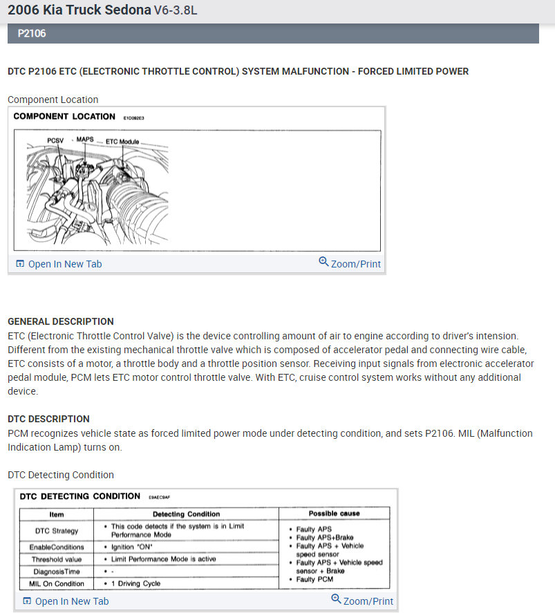

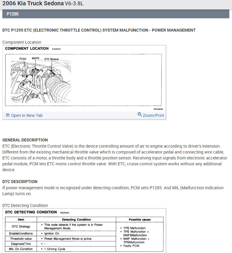

P2106 and p1295.
Sep 15, 2021 at 6:40 AM
SQM
  • 6,383 POSTS

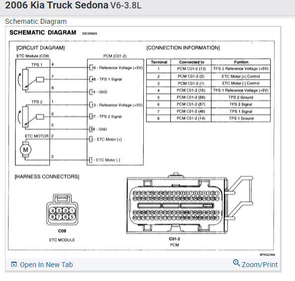

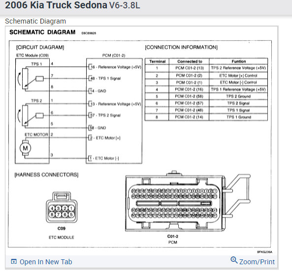

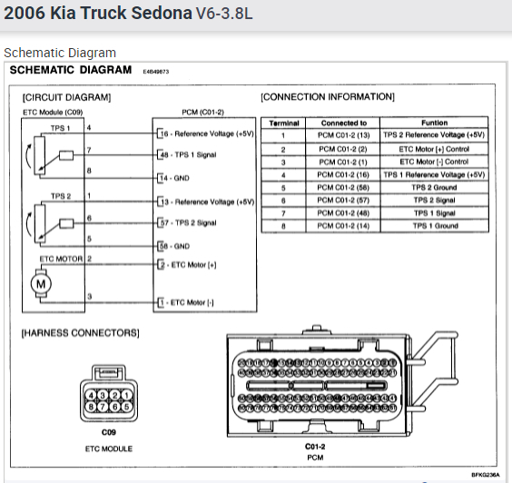

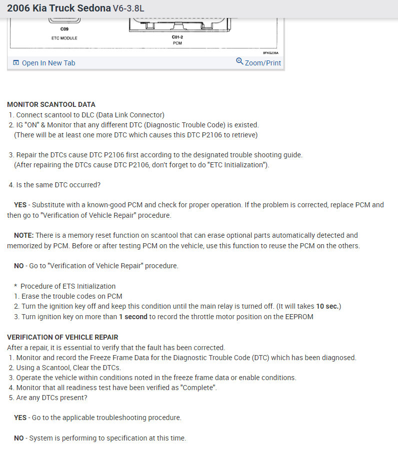

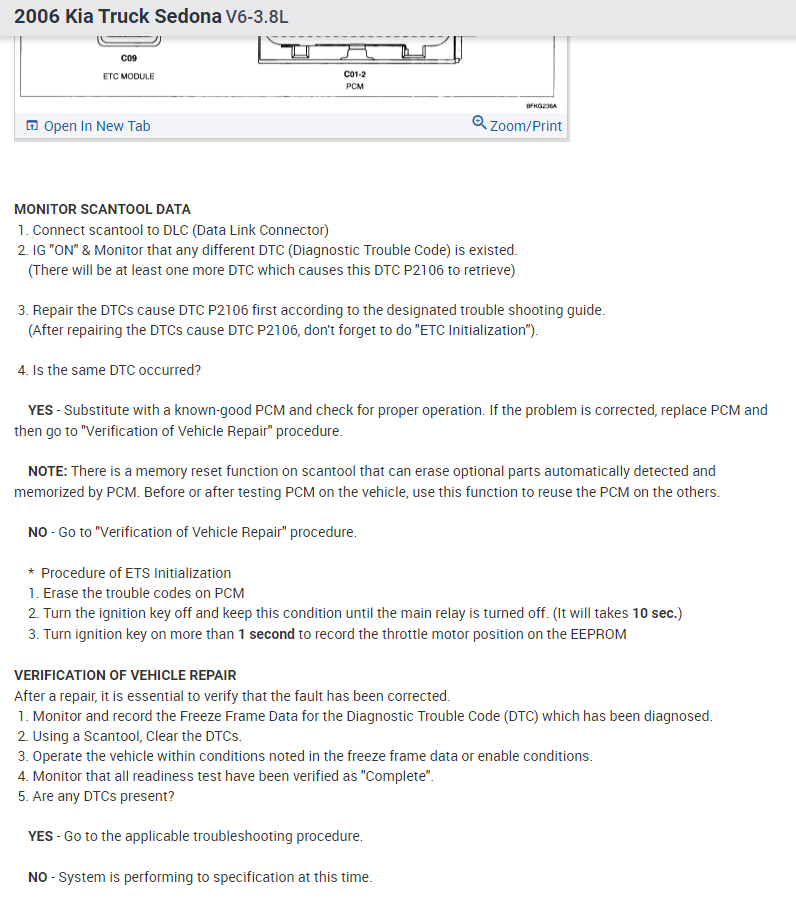

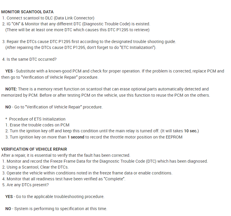

Both of those codes are for the Electronic Throttle Control module.
P2106: ETC System Malfunction - forced limited power
P1295: ETC System Malfunction - power management
They can be triggered for various reasons, from a faulty PCM to the TPS.
I have attached the diagnostics for those codes.

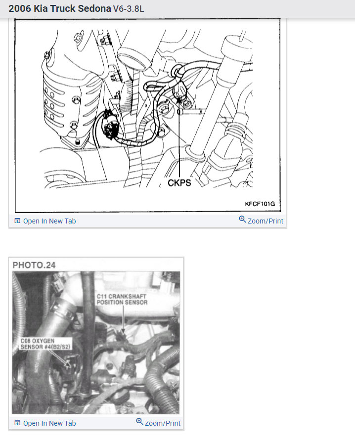

Your crank sensor could be the culprit. Are you getting a crank sensor code?
Sep 15, 2021 at 7:38 AM
CHARLES11Q
  • 8 POSTS
No crank center code at all.

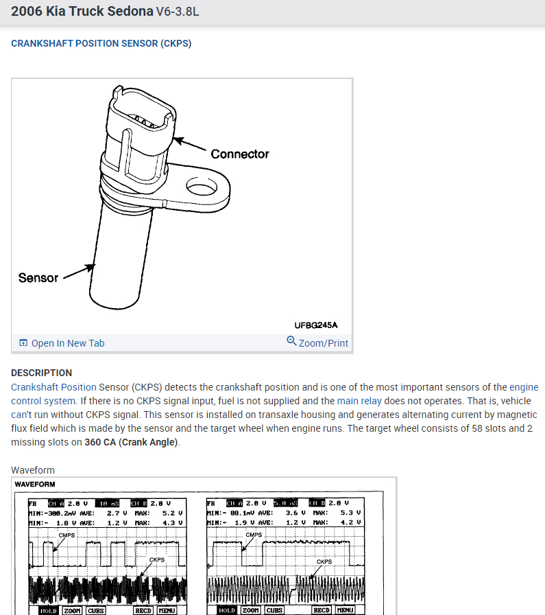

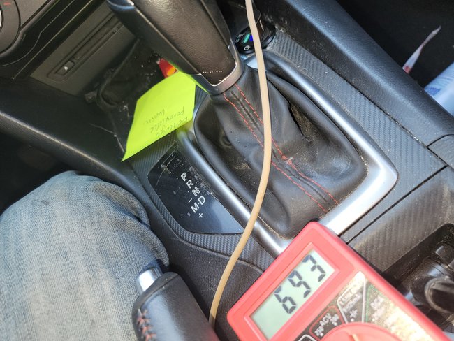

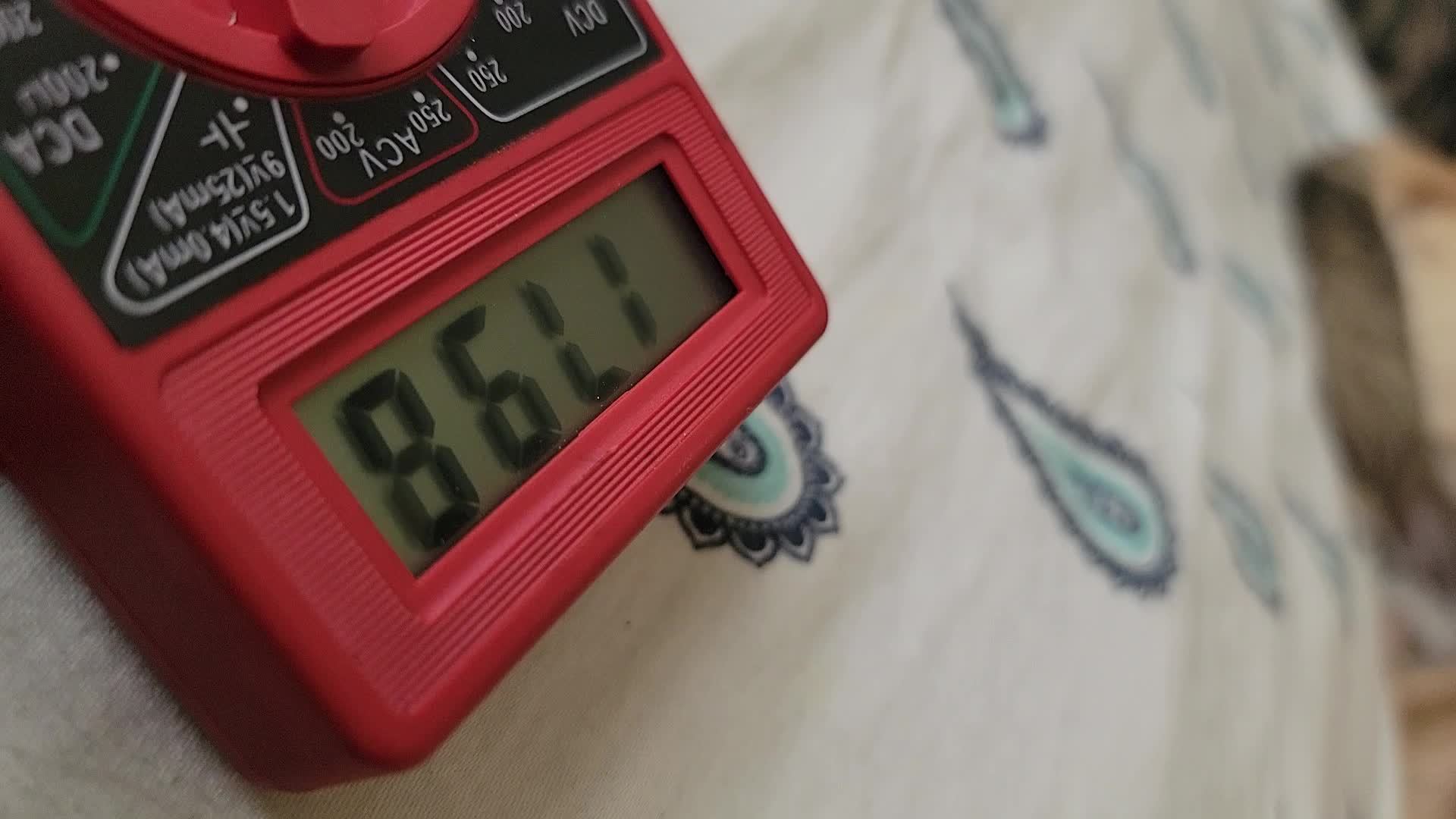

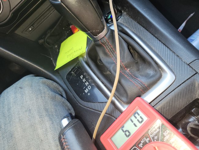

This is what the crank sensor reads, no magnet and then magnet.

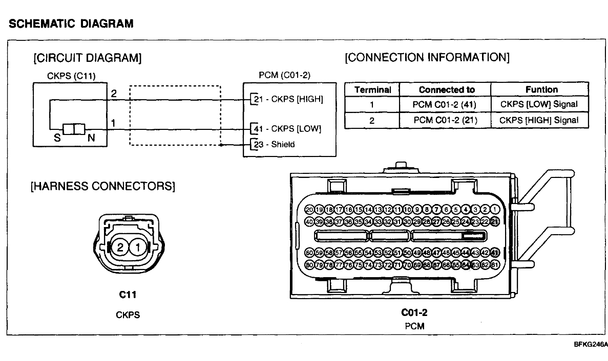

Are you getting 5V to the crank sensor connector?
Sep 16, 2021 at 3:03 PM
CHARLES11Q
  • 8 POSTS
Yes.
Sep 17, 2021 at 8:39 AM
SQM
  • 6,383 POSTS

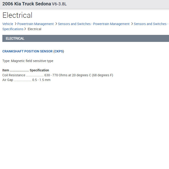

What is the resistance on the crank sensor pins?
It should be 630 - 770 Ohms at 20 degrees C (68 degrees F)
Air Gap .................... 0.5 - 1.5 mm
If it is out of this range that likely a bad sensor.
Sep 17, 2021 at 11:37 AM
CHARLES11Q
  • 8 POSTS
650.
