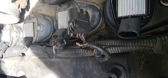

DTC P030, I tested and found out the coil pack was faulty. So, I changed in the parking lot of the parts store. I started it and it ran smoothly like it should. As I was leaving the parts store, I backed up then the engine just shut off and wouldn't start back up. I tested the fuel pump relay; I could hear nor feel a click in the relay when the key got turned on. Checked for voltage, the fuse box, one side of the relay gets a steady 12 volts, the other side gets nothing when the engine is cranking over. I cannot smell fuel at all when trying to start the engine. I checked the fuel pump fuse, it's still good. This has me puzzled because I usually can figure things out. In your opinion what could give me this problem?

The fuel pump relay will have a constant 12v on the secondary side and 12v on the primary only when the key is first turned on for a couple of seconds. After it primes, the engine must start and there be an ignition signal for the PCM to continue running the pump.
Do me a favor. See if the engine starts for a couple of seconds using starting fluid. If it does and then stalls, we can confirm its fuel related. If there is no change, check to see if there is spark to the plugs. Here is a link that explains how that is done:
https://www.2carpros.com/articles/how-to-check-for-ignition-spark
Based on your description, it certainly could be either fuel or ignition related. However, the idea that it is stalling prior may indicate a faulty crankshaft position sensor. If you have a tachometer, take notice if the needle moves a little when cranking. If you have a live data scanner, see if there is an RPM signal. If there isn't, suspect the crankshaft position sensor has failed which will cause no spark to the plugs.

You won't believe what the problem was. I thought about checking the PCM fuse which is a 15 Amp fuse. Well, it was blown. I changed the fuse and now everything is back to normal.

Something keeps blowing the fuse for the PCM. I checked the wires on the pigtail for the number 1 coil pack. One of the wires broke. Do you think I can put a butt connector on this?

I tried putting a pig tail connector on the number 1 coil pack. I'm not quite sure if I put the wires right. Something keeps blowing the fuse for the PCM. Everything was fine until I changed the coil pack for the number 1 cylinder. What would happen if the wires got crossed? Would it fry the PCM, or would it just blow the fuse?
Jul 4, 2022 at 8:01 AM
  • 110,241 POSTS
If you crossed the wiring, there would be power to the PCM at all times from the circuit. It shouldn't damage the PCM, but it could cause the fuse to fail.
How quickly does the fuse fail? If you carefully separate the wiring at the connector for the coil pack so nothing can short, does the fuse still fail?

The engine starts and runs for a couple seconds then shuts off due to the burnt fuse. When I put the pig tail on, I also taped it up pretty good with black electrical tape.

I found the problem. The new coil pack I put in on Friday is defective. I unplugged the coil pack then started the engine. It ran without blowing the fuse. When the old coil pack is plugged in, it runs with a misfire (PO301). That's why I changed the coil pack to start off with. When the new coil pack is plugged That's when the PCM fuse blows so it's a defective coil pack.
