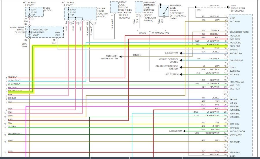

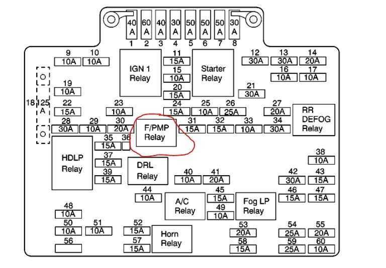

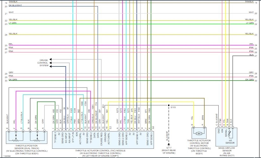

I bought a non running project truck (listed above). My problem is a few actually, first I'm not getting power or ground to the fuel pump. Fuel pump, and filter are new and can force pump to run by running straight from the battery. I have checked all fuses and relays... Truck will run at this point.

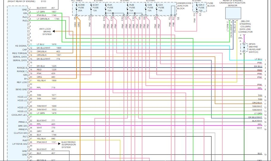

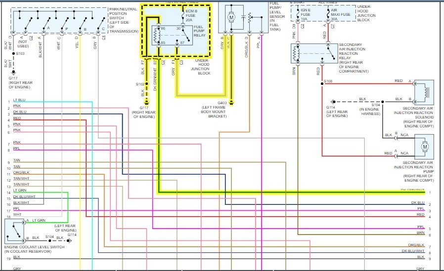

I attached the wiring diagram for you of the fuel pump and the engine control system.
Check at the relay for power at terminal 30 with the key in the on position. You should also have power at 85 for 2 seconds with the key on. Then when you crank it, it should be full voltage.
May 2, 2021 at 10:02 PM

I have checked fuses and relays but I will check some of the sensors to see if maybe that could be the issue. The truck will start and run if I run the fuel pump direct from the battery. One of the most confusing parts is the issue with the cluster.
May 2, 2021 at 10:53 PM
It is not a sensor at all.
You need to do the voltage checks I suggested to see what is not allowing voltage to the pump.

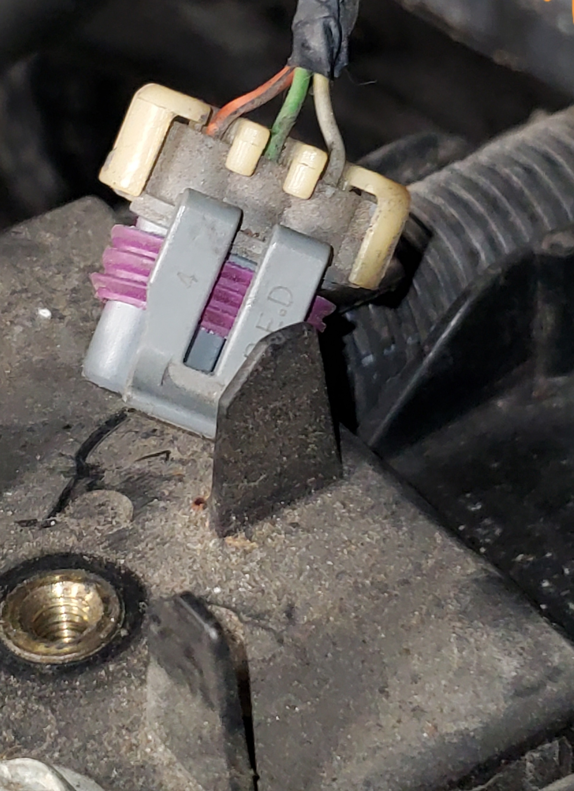

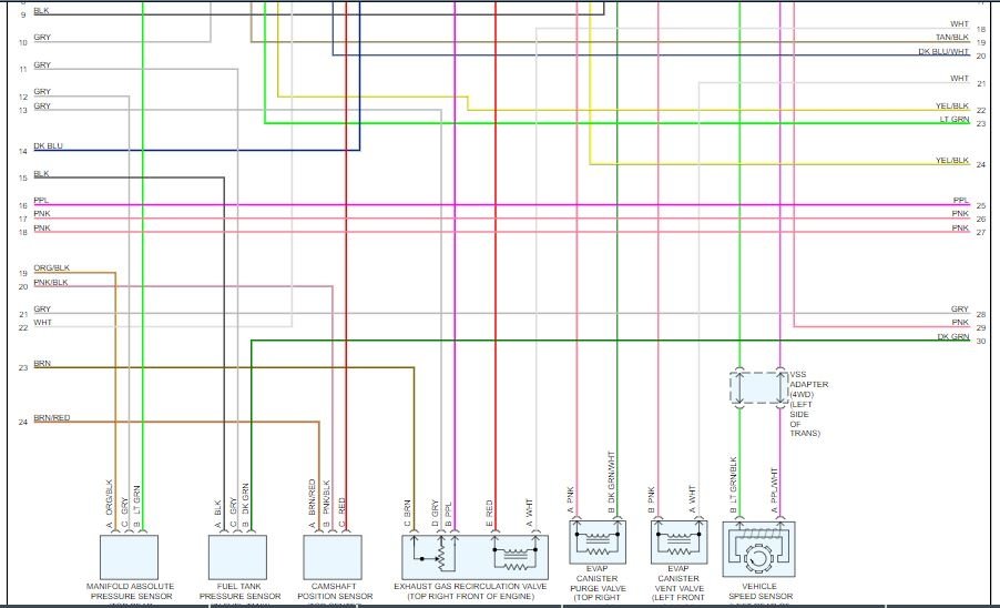

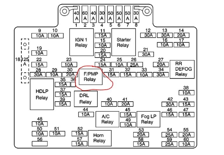

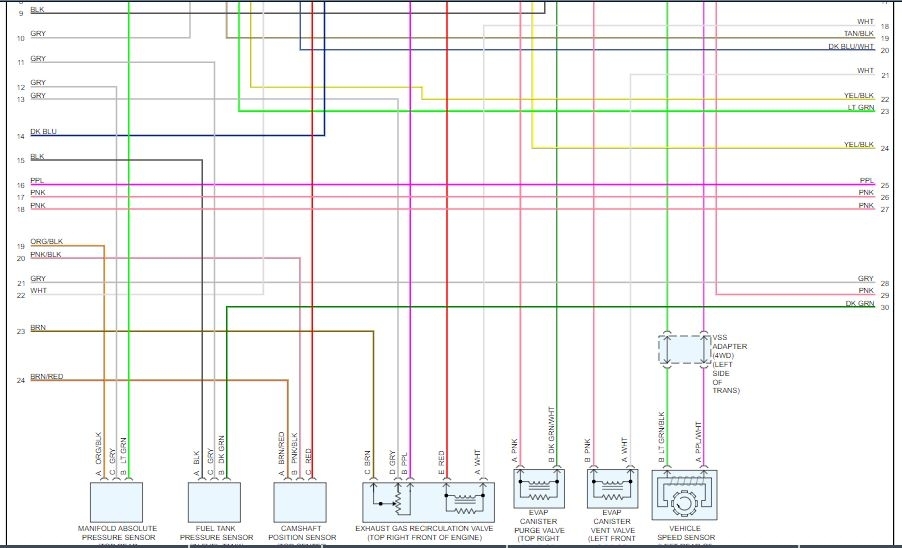

Checked voltage at cam position sensor and have 5 volts on white wire (far right in picture). Also checked fuel pump relay terminals and getting power on 30 and 2 seconds on 85. Had helper cycle key and rechecked at pump still no prime or power while cranking. Also appears no ground either.
May 3, 2021 at 10:51 AM

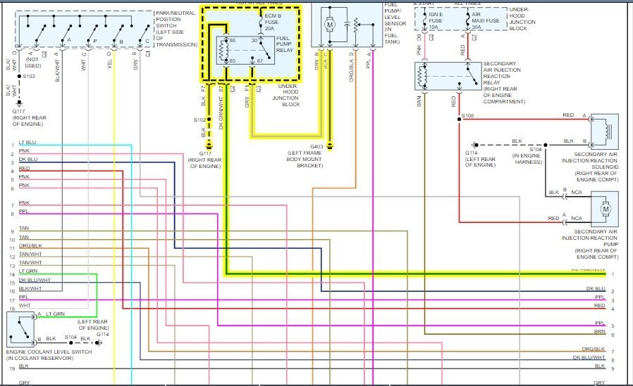

Okay, when you turn the key to the on position, does the relay energize and click?
If it does, check the wire from 87 to the pump. If it does not, then yes, it could be the ground for the control side of the relay. The ground is G117 in the diagram and it is located on the rear of the engine. It is usually on either the cylinder head or it could be attached to the bell housing bolt.
May 3, 2021 at 8:16 PM
SSROBERTSON
  • 80 POSTS
The relay does click. I had a feeling it could be that wire was damaged (I had to do this on a friend's truck before, seems like it's common). I will try to run a new wire and see if it resolves my issue. I will keep you posted. And I did put through another question for the cluster issue. Thank you for your help Roy!

Update: I ran a new wire from 87 to fuel pump and now have power as I should. Only thing I noticed is I had to ground the fuel pump to make it come on. Other than that it works perfectly now.
