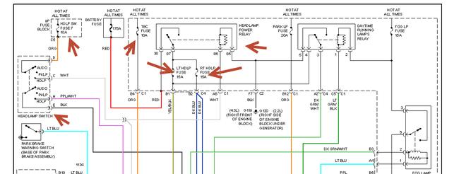

My low beam lights were not working, I found a wire that looked burnt at the wiring harness junction under the dash as I was taking this apart it sparked. I reinstalled it and checked all the fuses, turned the key it started to turnover and then just stopped. Once this happened there was no electrical power to anything, I checked all the doses again and nothing was blown. I checked the fuse link under the battery and it looks ok. Still no electrical pore to anything.
Jan 30, 2021 at 12:44 AM (Merged)
HMAC300
  • 48,601 POSTS

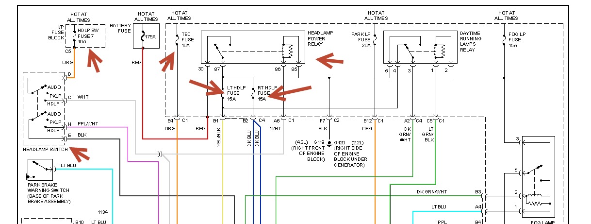

It sounds like the battery cables are dirty this guide can help us.
or you probably hooked the wire to the wrong place for one check the things I've pointed out in first pic second pic is where wires go to headlight switch and what fuses to check. Check out the diagrams (Below). Please let us know what happens.

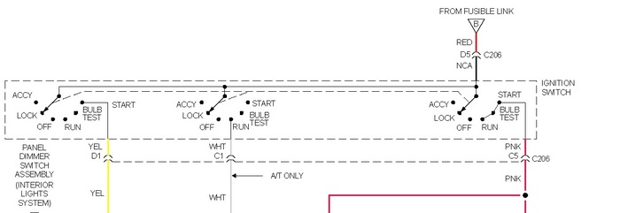

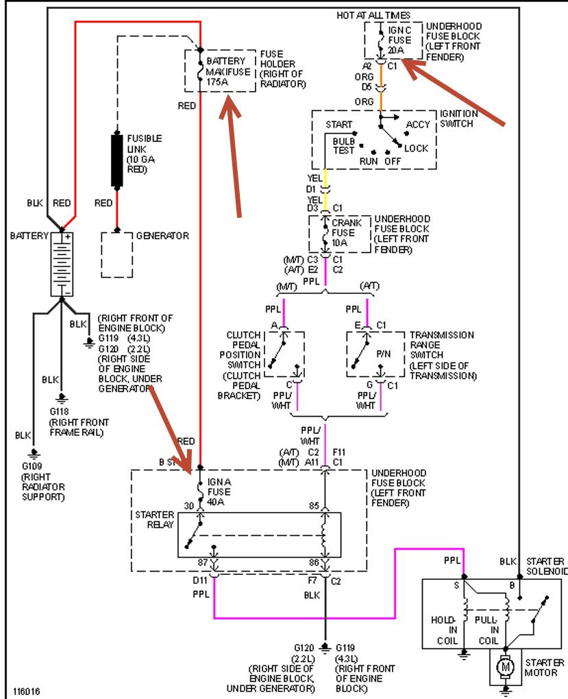

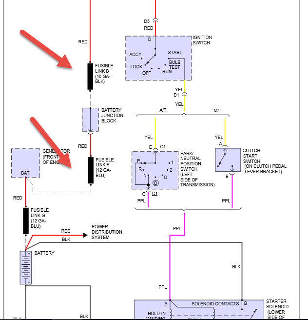

JDL
  • 16,098 POSTS
There should be two red wires that supply feed to ignition switch. In the diagram, voltage feed to ignition switch are on top, feed from ignition switch on bottom. Check the ignition switch wiring.

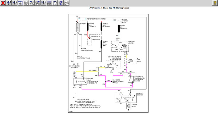

MRKWESA
1996 chevy blazer, car has no power at all. battery is ok, no power to anything. all fuses ok. alternator was replaced 1 week ago.
Jan 30, 2021 at 12:45 AM (Merged)

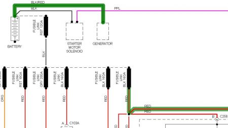

HMAC300
  • 48,601 POSTS
check the fusible links ( they are usuallysmaller wires connected to larger ones.) i've sent the schematic along.

HMAC300
  • 48,601 POSTS
Shoot forgot to send picture. Sorry see picture as well.

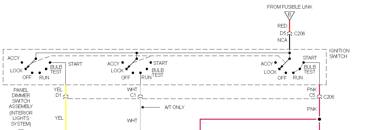

SETNSAIL
lights all work fine in and out, but nothing happens when key is turned, wont start,no blinkers,radio,windows etc.. i changed the ignition switch and nothing
  • 75,992 POSTS
See fusible links below-test the red wire going into the ignition switch-nothing there check fusible link Blk /16 gauge
https://images.2carpros.com/forum/automotive_pictures/12900_fusible_link_1.jpg
