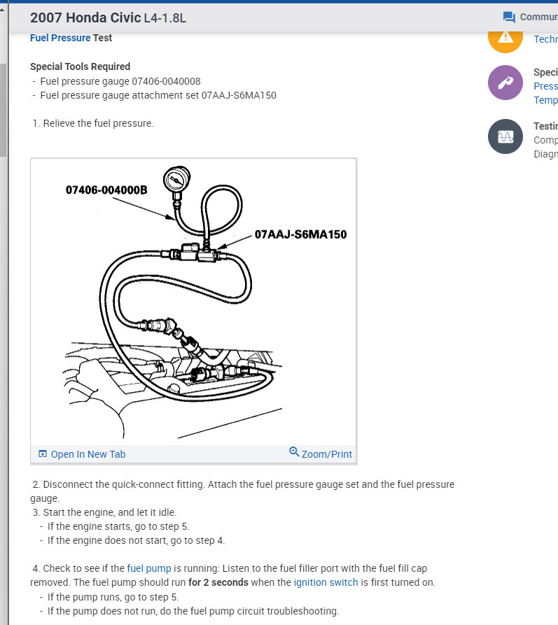

No start, fuel is not reaching the fuel injectors as if the system has shut down
2007 HONDA CIVIC
197,000 MILES • 1.8L • 4 CYL • 2WD • AUTOMATIC
DAWINKA
We can hear the fuel pump turn on for a few seconds and that's it. We can run power directly to the fuel pump and still does not pump gas for the fuel pump to the injectors.
Jun 25, 2022 at 10:51 AM

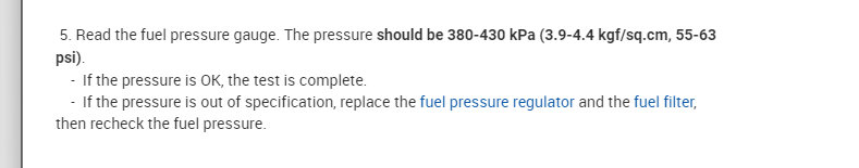

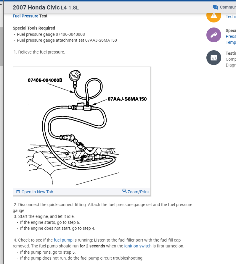

We need to confirm that the fuel pressure is the issue and not just the pump.
So, we need to start with checking the pressure when you hear the pump run and if you get no pressure then we have a pump issue.
The only thing that I am questioning is if there is something that is telling the PCM to shut the pump off but even if you are running power to the pump and it doesn't continue to run then this sounds like a pump issue.
So, let's start with a pressure issue and go from there.
