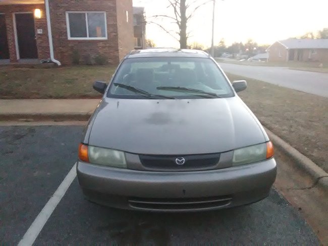

297,160 MILES • 1.8L • 4 CYL • FWD • AUTOMATIC
DAMIEN JACKSON
I was driving down the road and went and cut a corner and it just quit running on me, but was running fine before then. Tried to start it back up but will not start. It acts like it is not getting any fire and we replaced the spark plugs and wires and rotary cap/button and tighten down battery cables real tight. The car still will not start. even checked all the fuses. Can you please tell me what I can do to fix this car.
