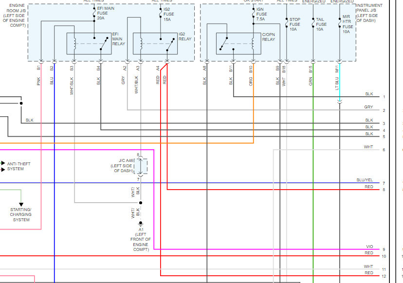

Car cranks but will not start. No fuel and no spark. Do not know where to turn.

This sounds like the crankshaft angle sensor or the fuel pump has gone out, when you turn the key to the on position without cranking the engine over can you hear the fuel pump run in the tank for 5 seconds? These guides should help us fix it.
https://youtu.be/dCjmRL3p4Cs
and
Also, lets run the codes to see what come up.
Please run down these guides and report back. You have two ignition main relays.
Check them both for voltage. See if the fuses feeding the load sides are good. I attached a diagram of them for you.
