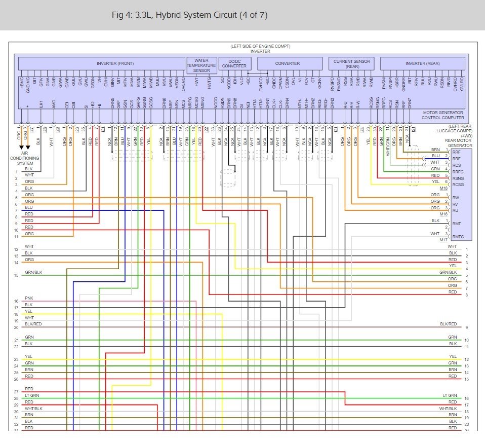

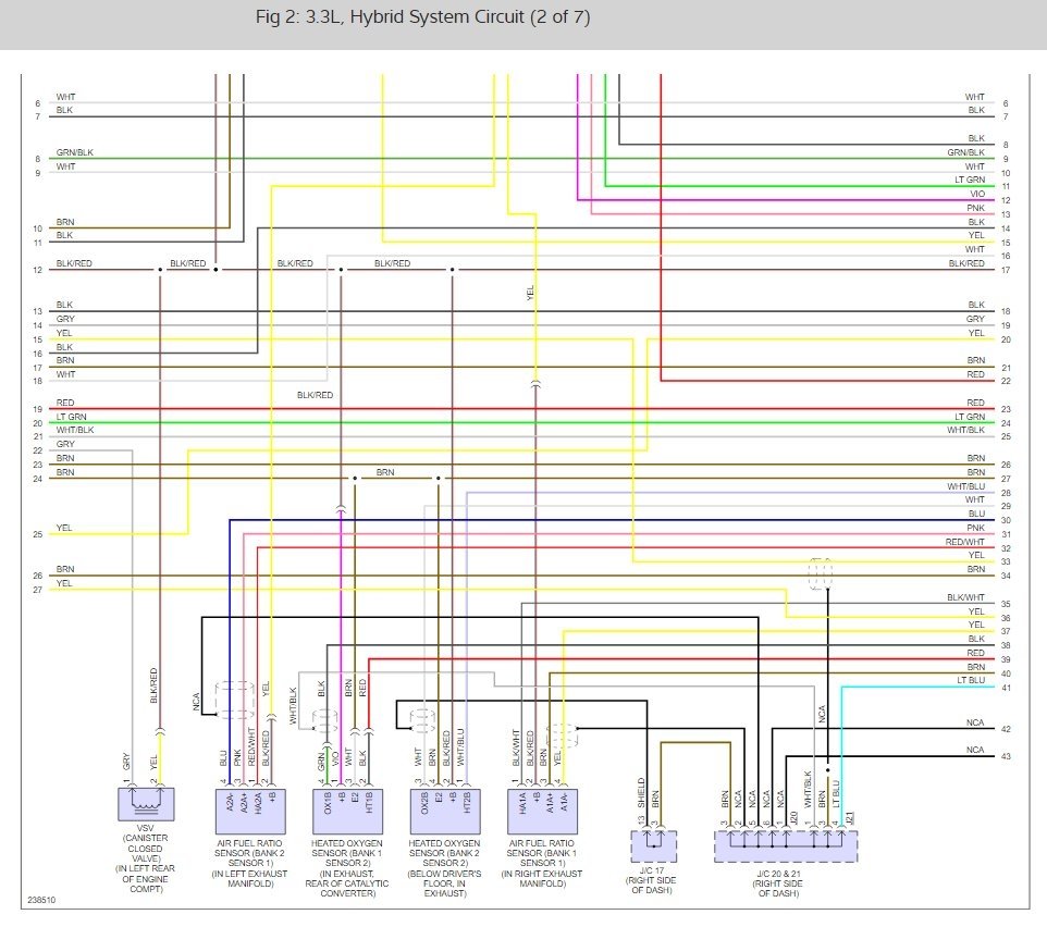

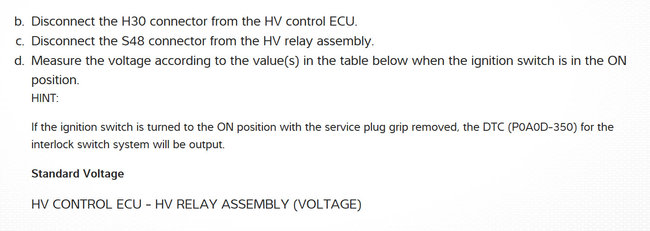

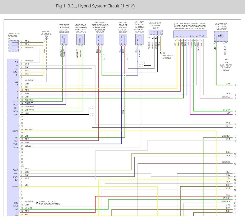

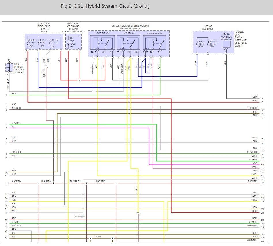

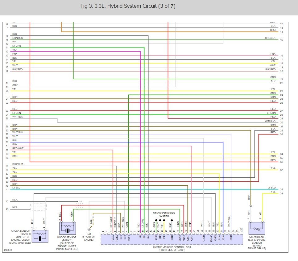

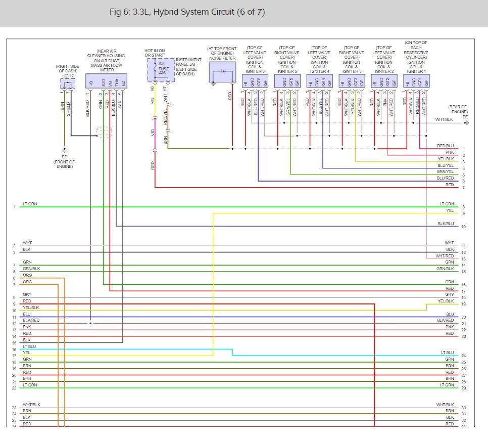

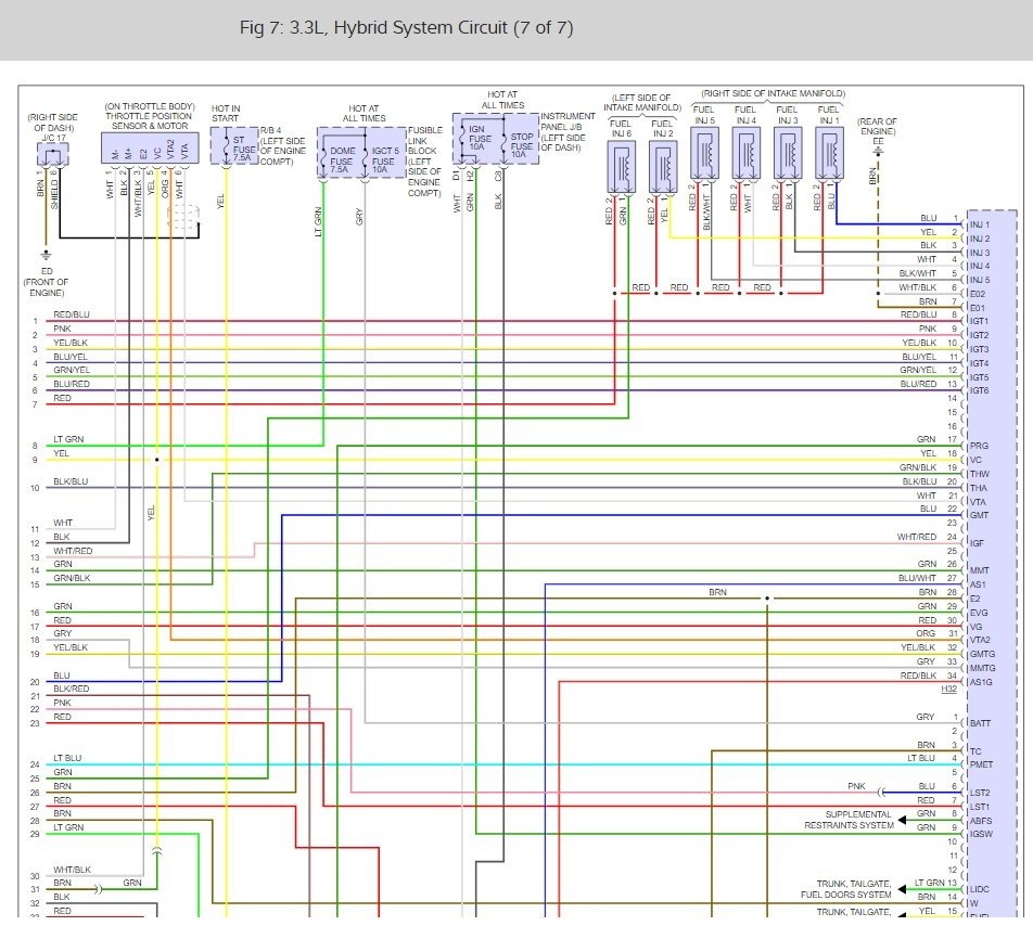

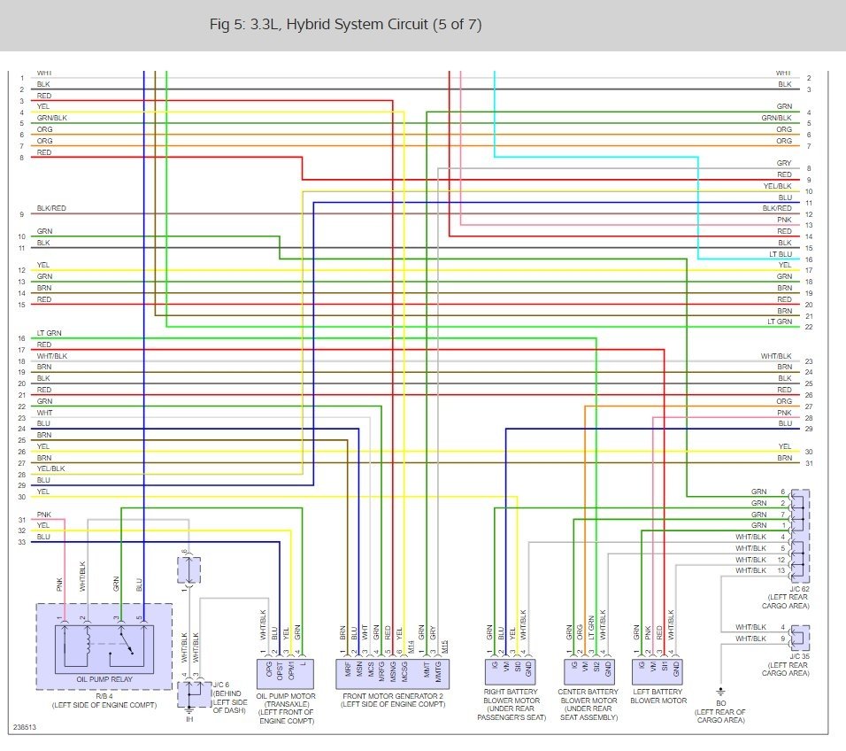

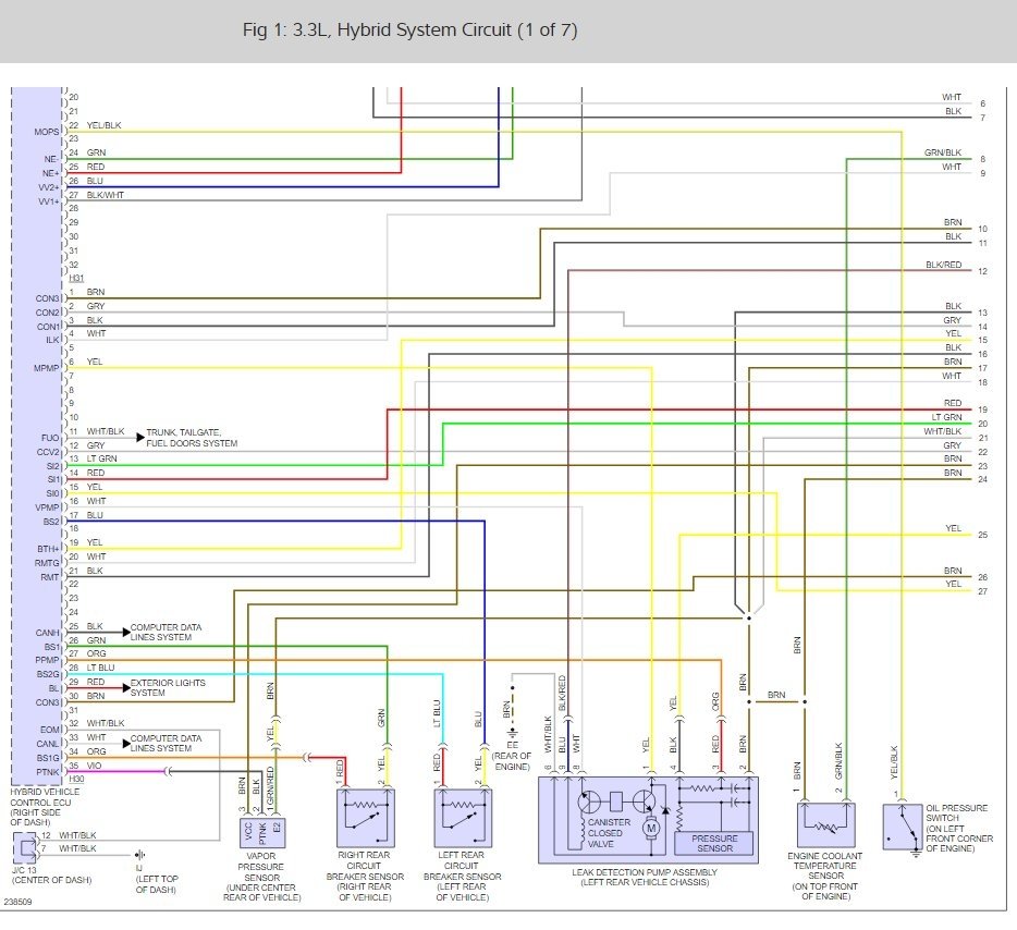

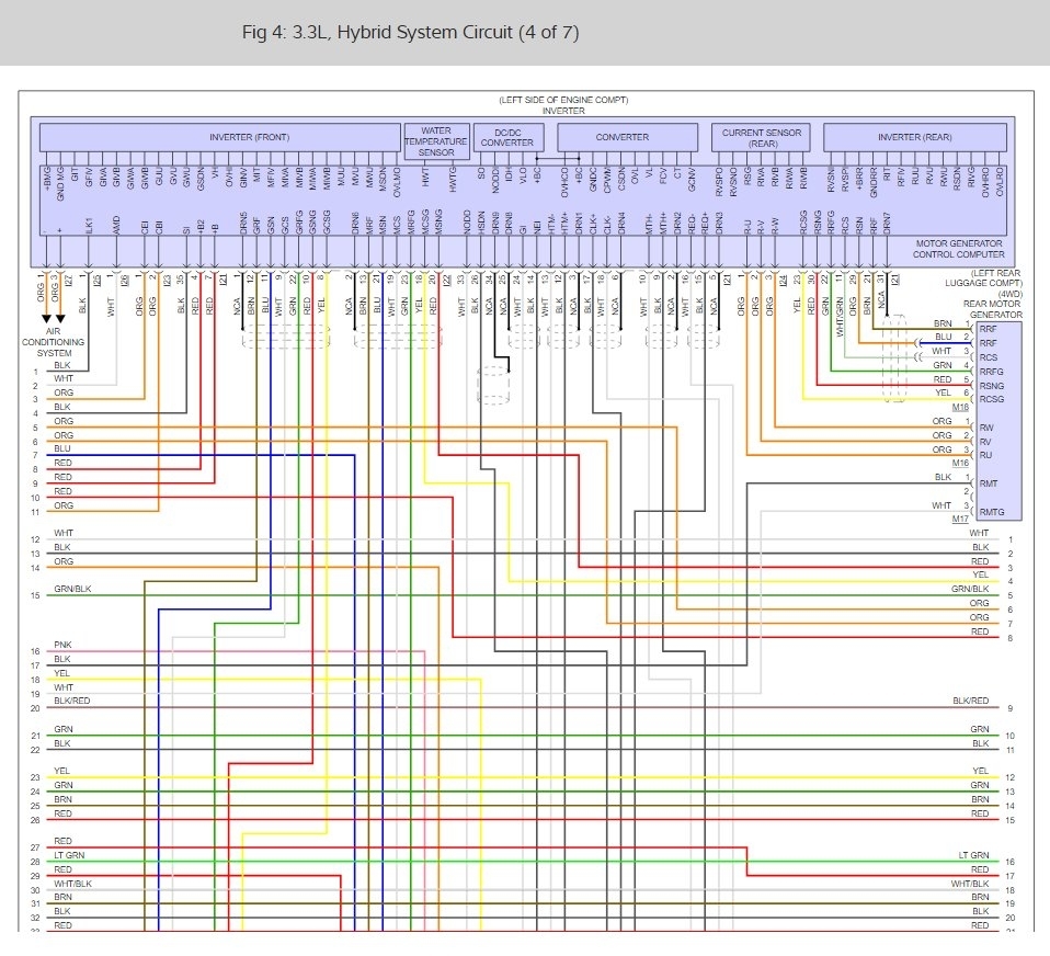

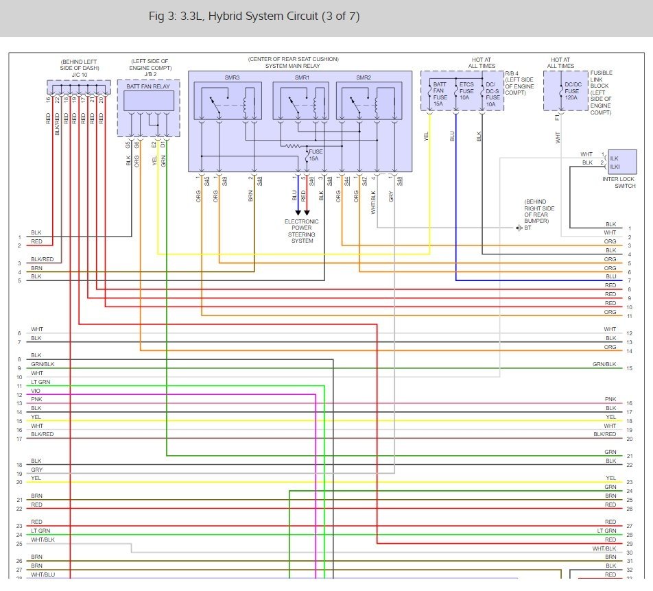

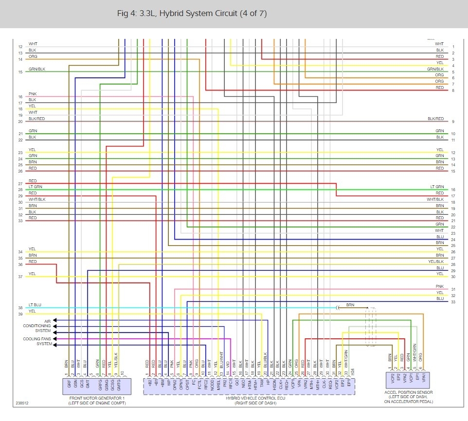

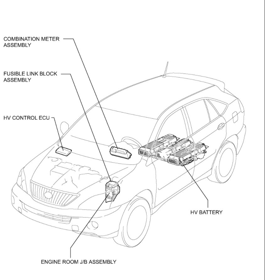

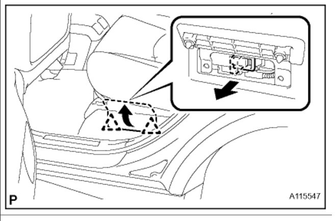

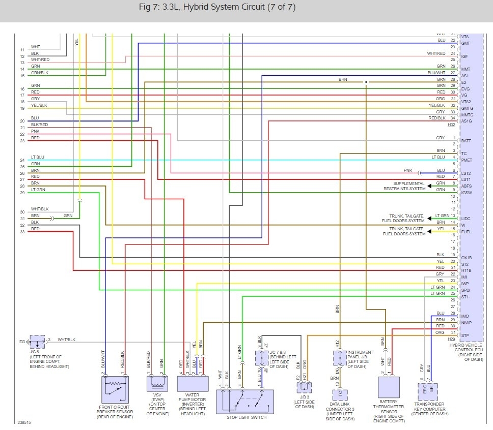

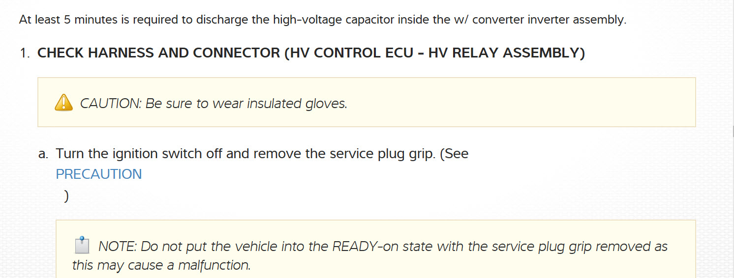

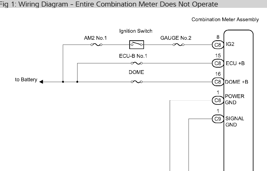

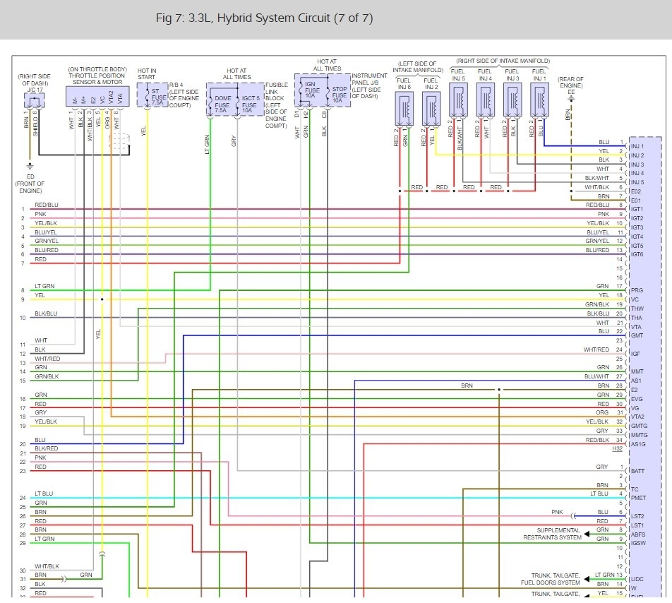

The communication error sounds like it is due to a relay not working a powering up a computer. Here are the engine and computer wiring diagrams (below) and a guide so so you can do some testing.
Do not mess with the high voltage side of the system (large wires)
and
Please run some tests and get back to us we are interested to see what it is.

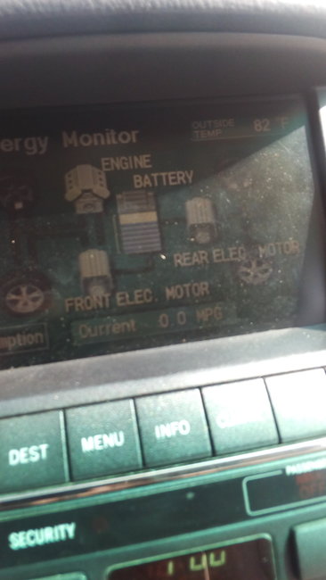

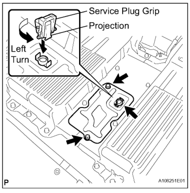

Thanks very much for your help we can now scan the vehicle and code gotten is poAOD but the service plug is OK the ready light came up but not steady all dash lights are out now but the monitor on screen is showing 0.00mkg even at a time the ready light became steady to show that it has started and the radiator water is seen boiling in front and after waiting for about 30seconds I then engaged the gear but the ready light off again. The electrician said my relay block assembly is bad that there is partial contact. So please where is the exact problem now because I thought if the traction battery is down which is rare the engine should start

The monitor on screen

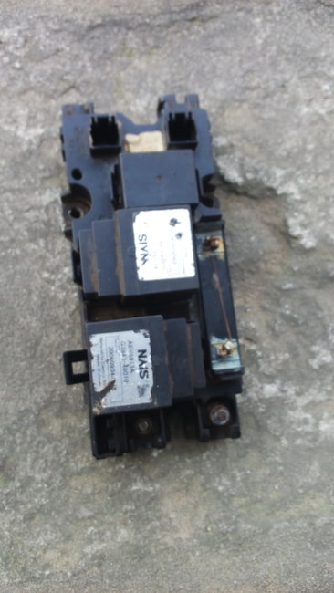

DECAPTAIN
  • 29 POSTS

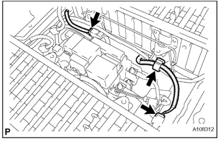

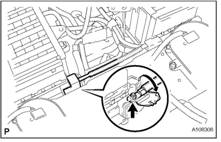

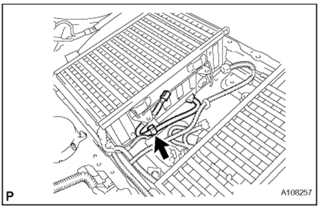

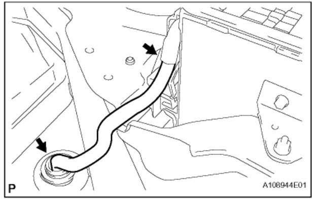

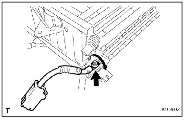

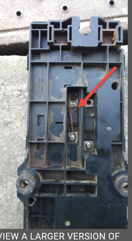

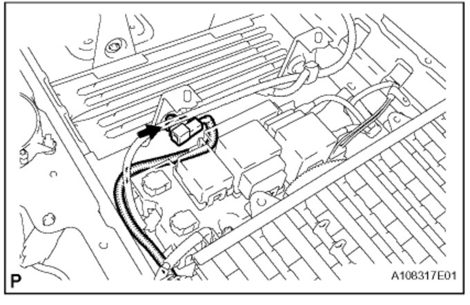

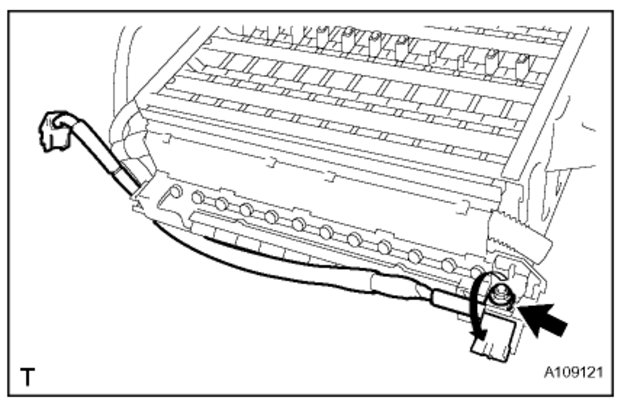

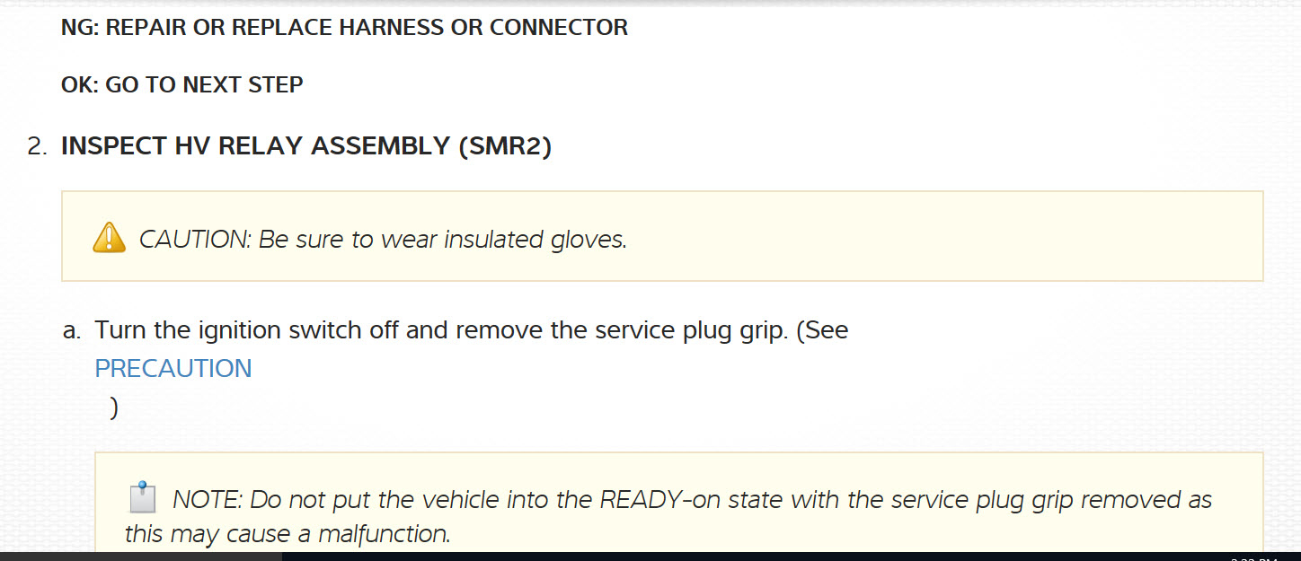

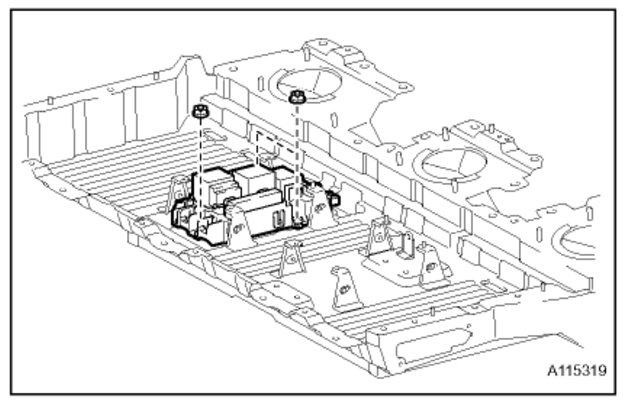

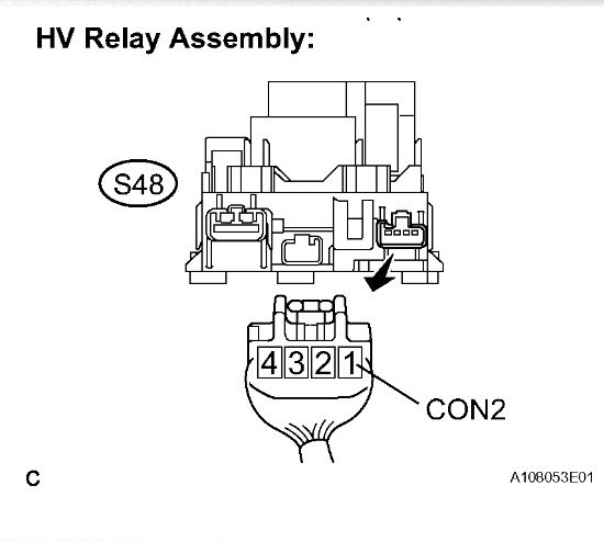

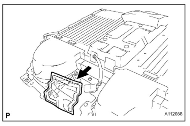

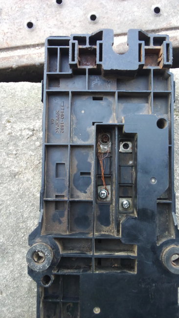

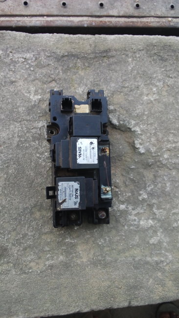

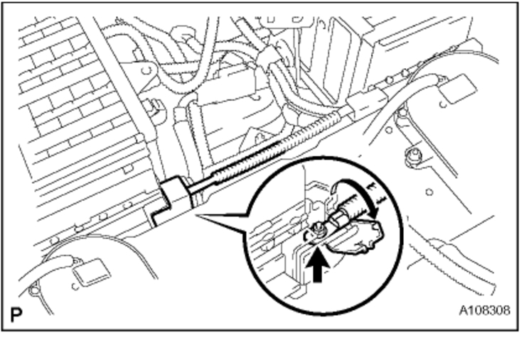

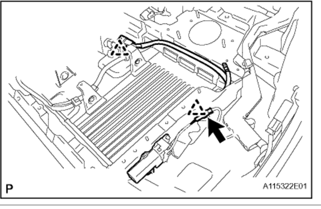

Please check this relay block assembly and tell me if anything is wrong. Also why is the current on the monitor reading 0.00mkg
Jul 10, 2017 at 5:31 PM

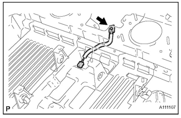

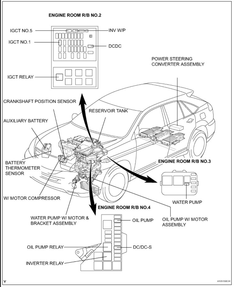

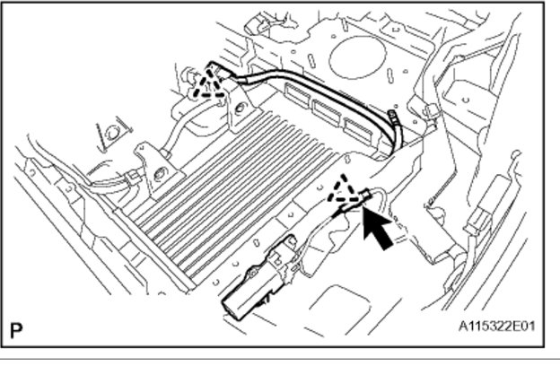

HMAC300
  • 48,601 POSTS

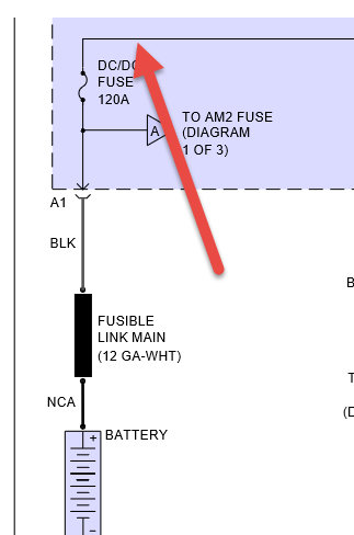

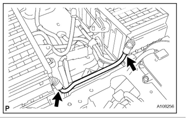

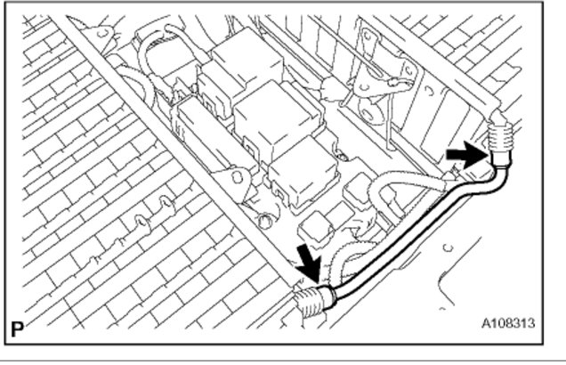

the wire in pic may be a fusible link which has failed and need another one if this is still connected see if you have power to one of the sides you should. something has caused this to short out protecting rest of system.se pic.
Jul 10, 2017 at 11:16 PM
DECAPTAIN
  • 29 POSTS

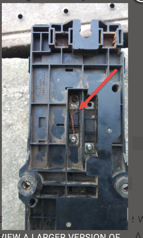

Thanks please check that energy monitor and tell me what is wrong is it supposed to read 0.00 and why is it so. Again the precharge resistor is the wires passed adeguate or we need the exact fuse socket. Sorry I think that the current reading is supposed to be Greater than 0.00 something is wrong
Jul 11, 2017 at 2:53 AM

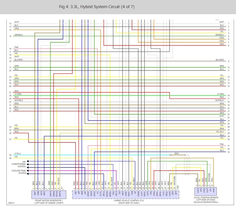

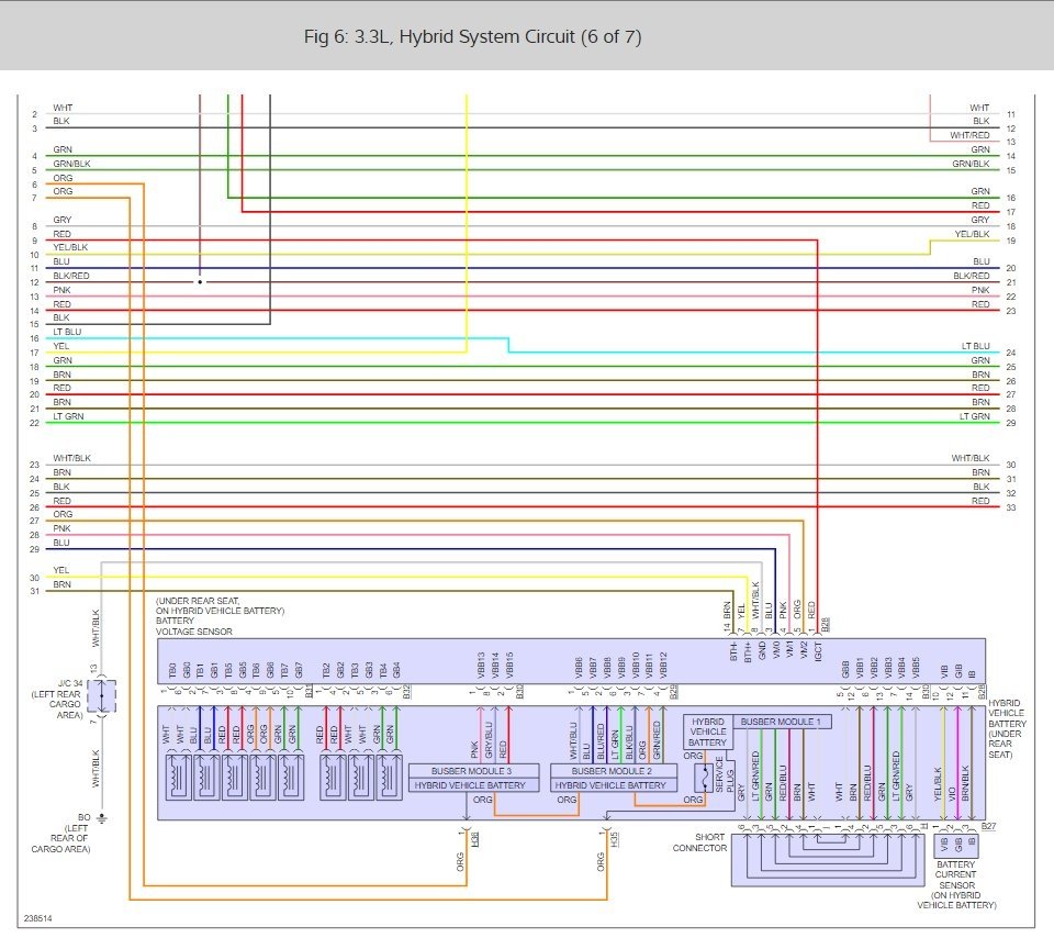

HMAC300
  • 48,601 POSTS

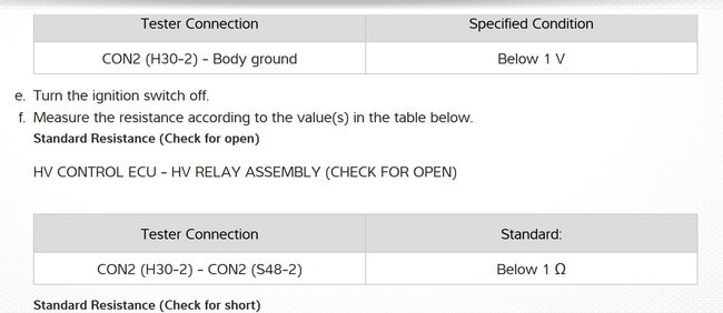

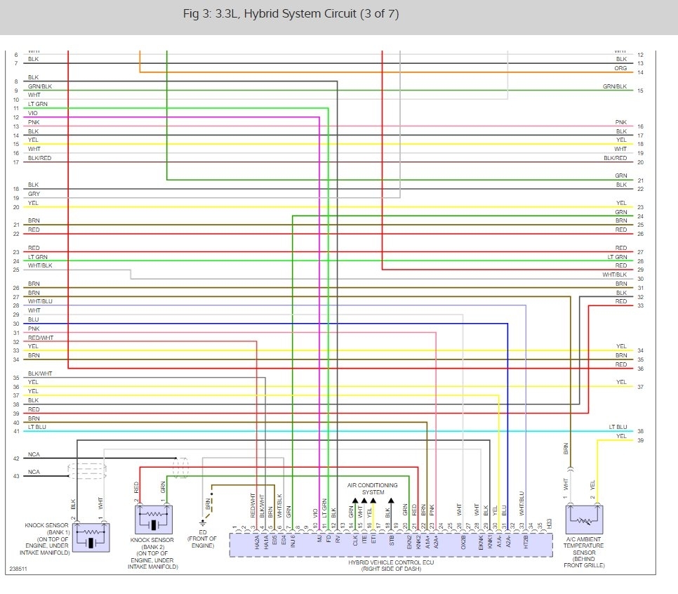

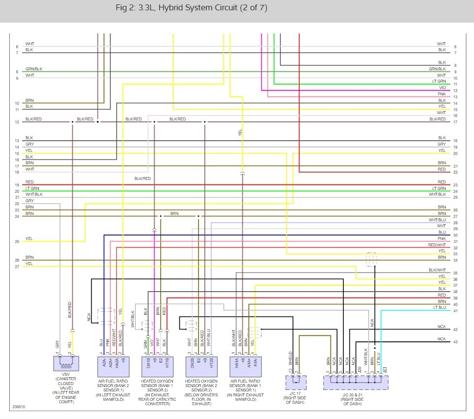

If you look at diagram I am sending it may be because of the wire that has burnt up that I sent in previous reply or the ecu for hybrid side is damaged causing this. because the energy monitor is for the hybrid side only. I still think the burnt wire at bottom of fuse box or what ever pic that is part of the problem. check to see if power is going to point in second pic if not one of those two fuses are toast

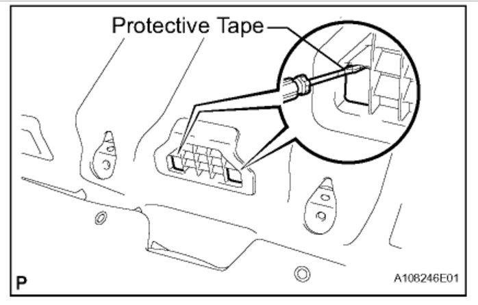

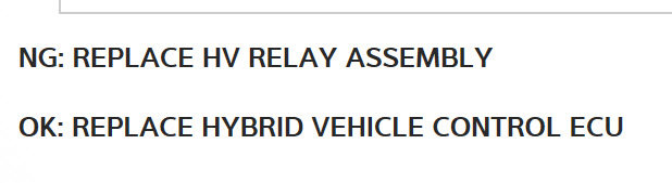

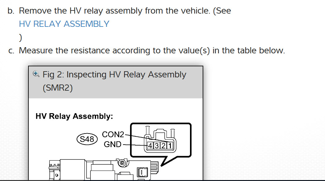

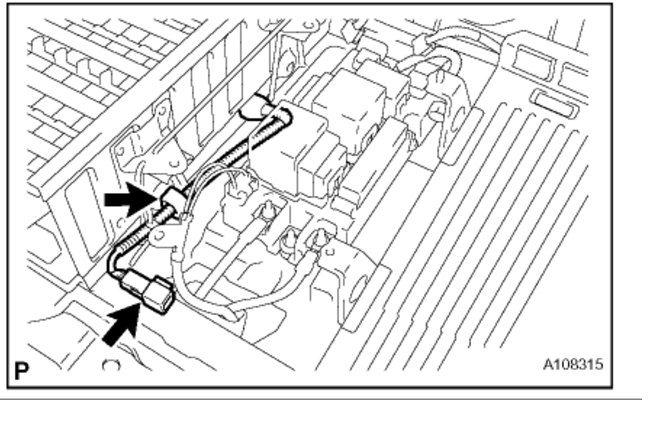

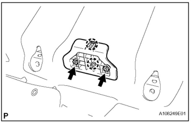

Thanks I just changed the relay block assembly and a code poAA1 is showing after scan and the ready light is not steady please what is now the problem
Jul 18, 2017 at 4:21 AM

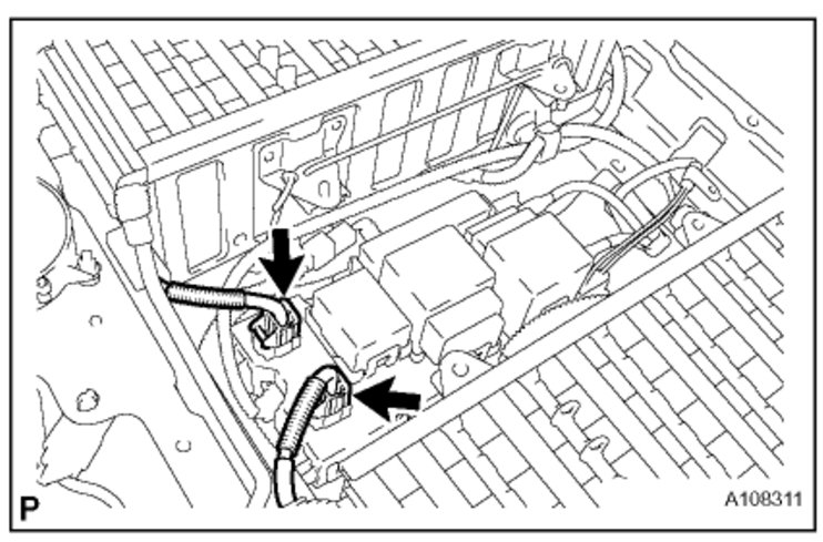

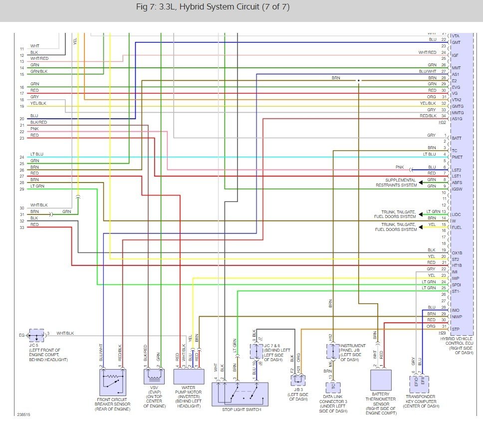

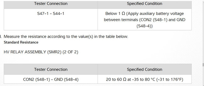

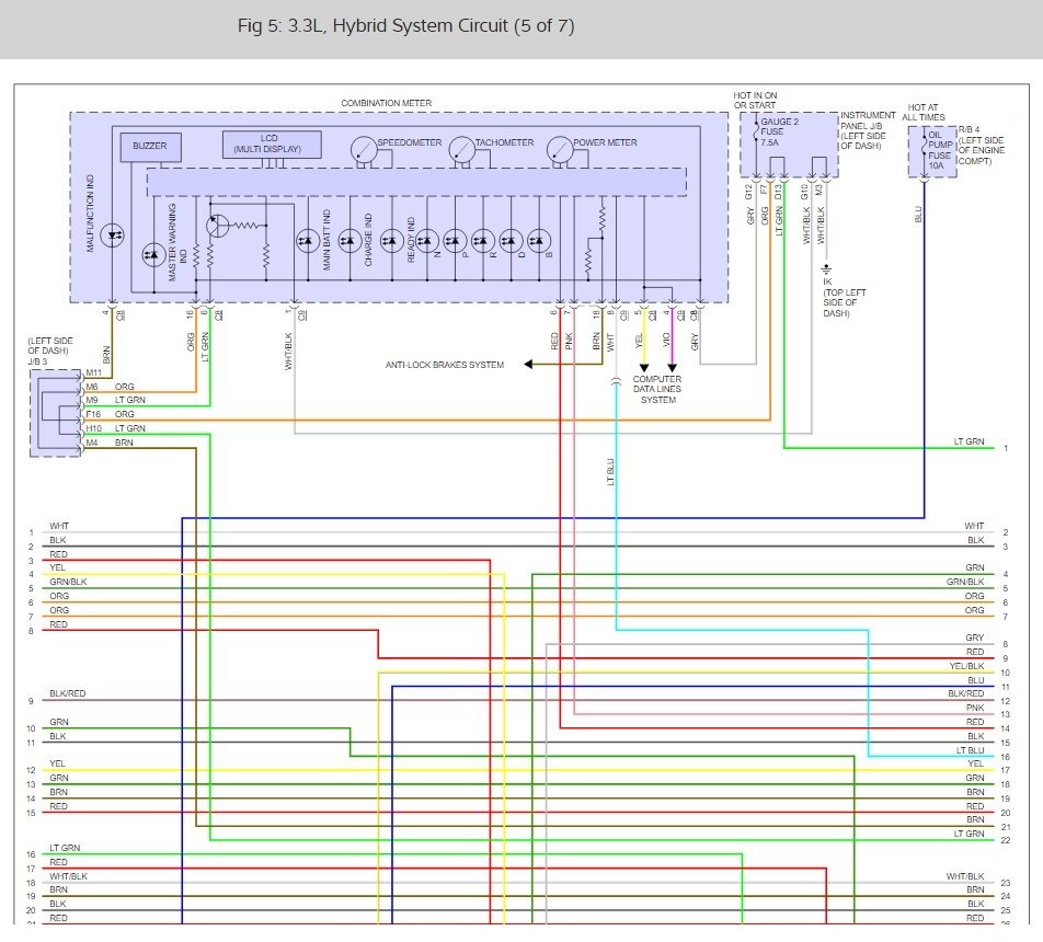

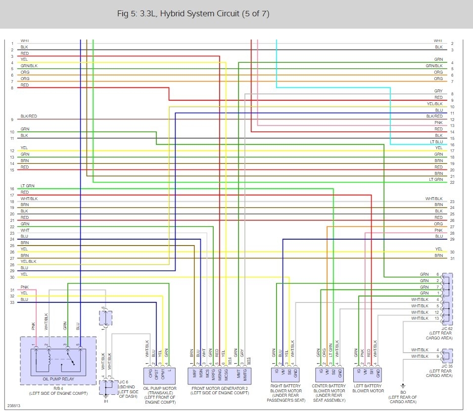

HMAC300
  • 48,601 POSTS

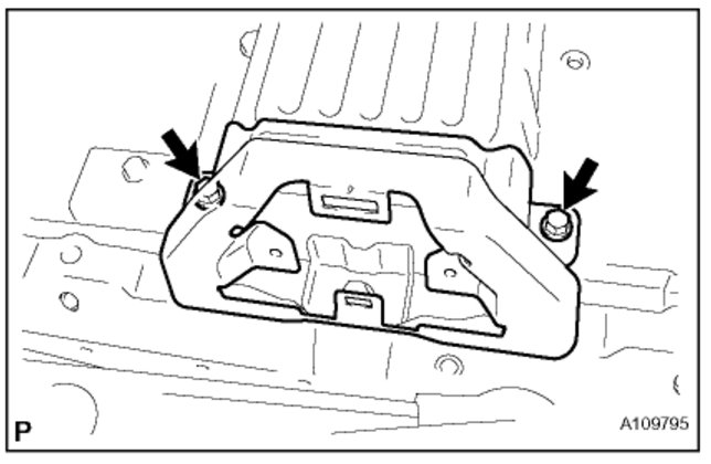

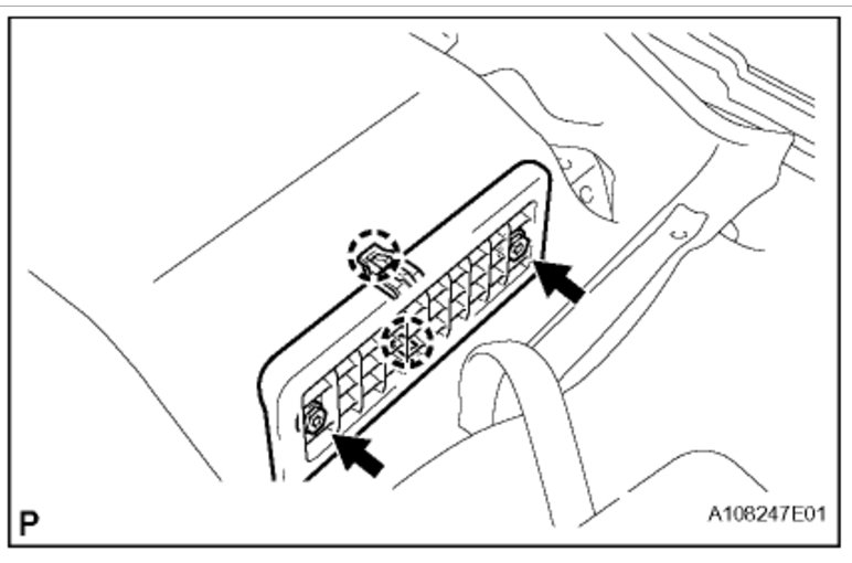

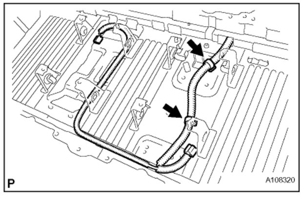

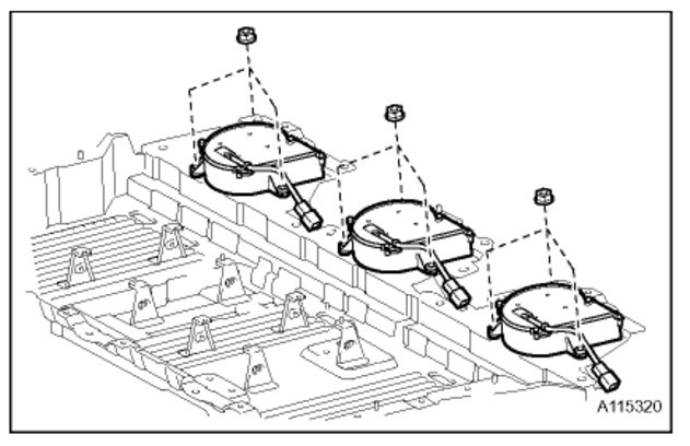

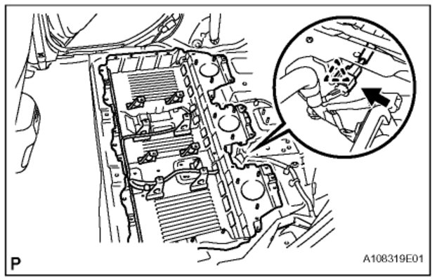

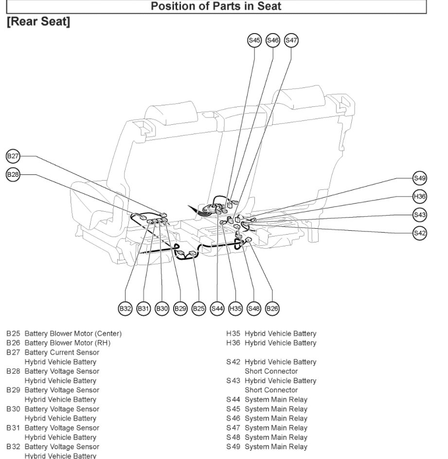

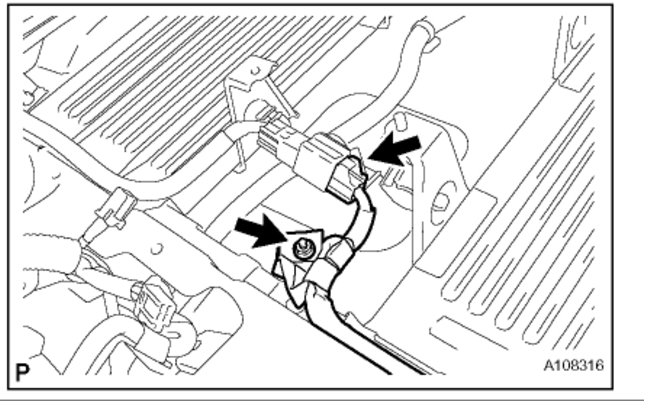

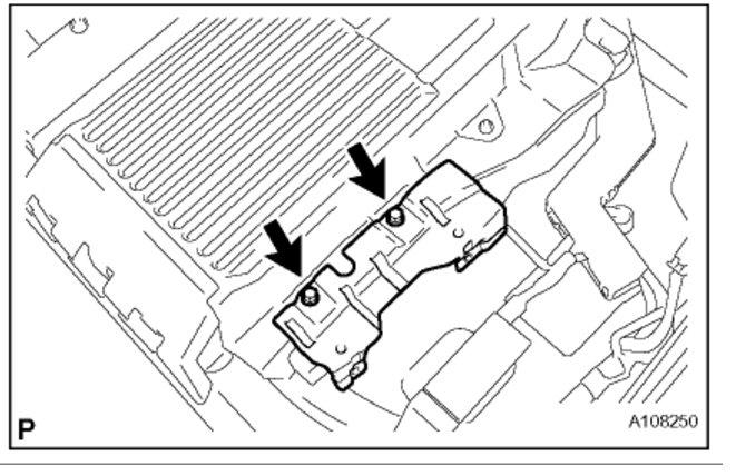

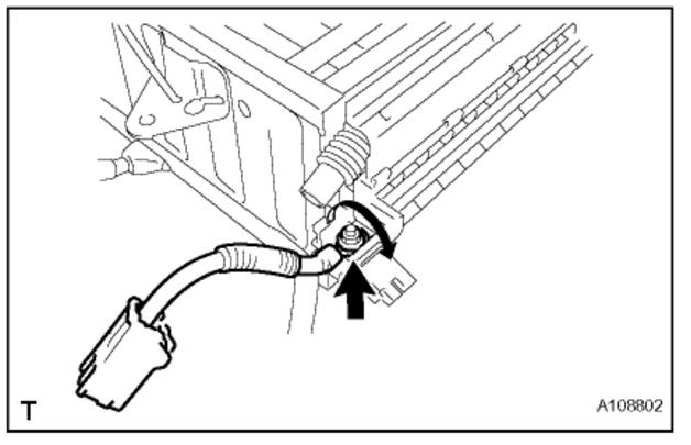

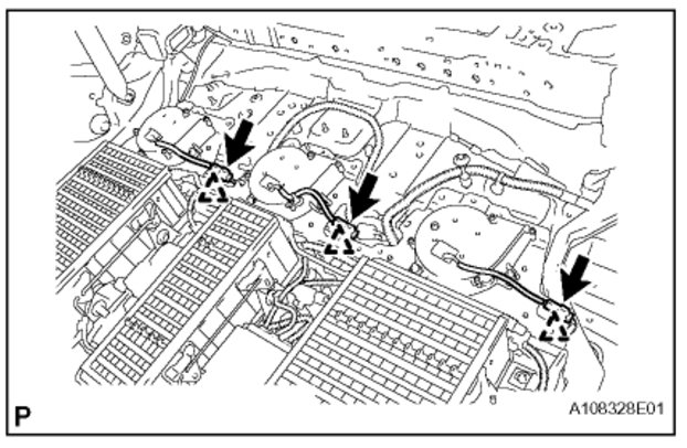

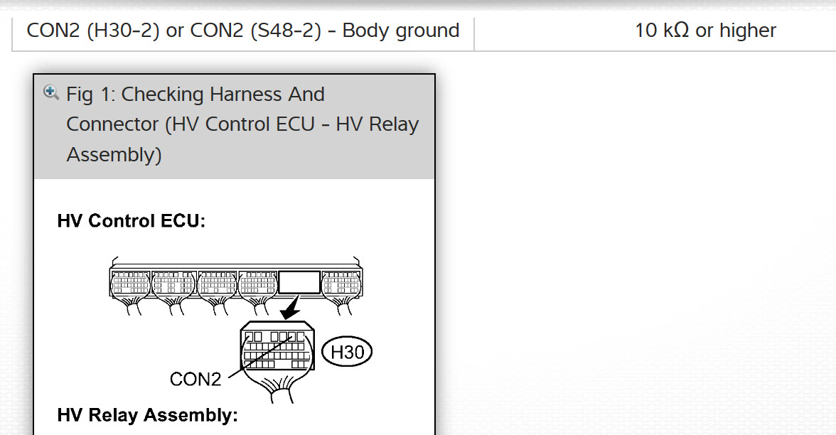

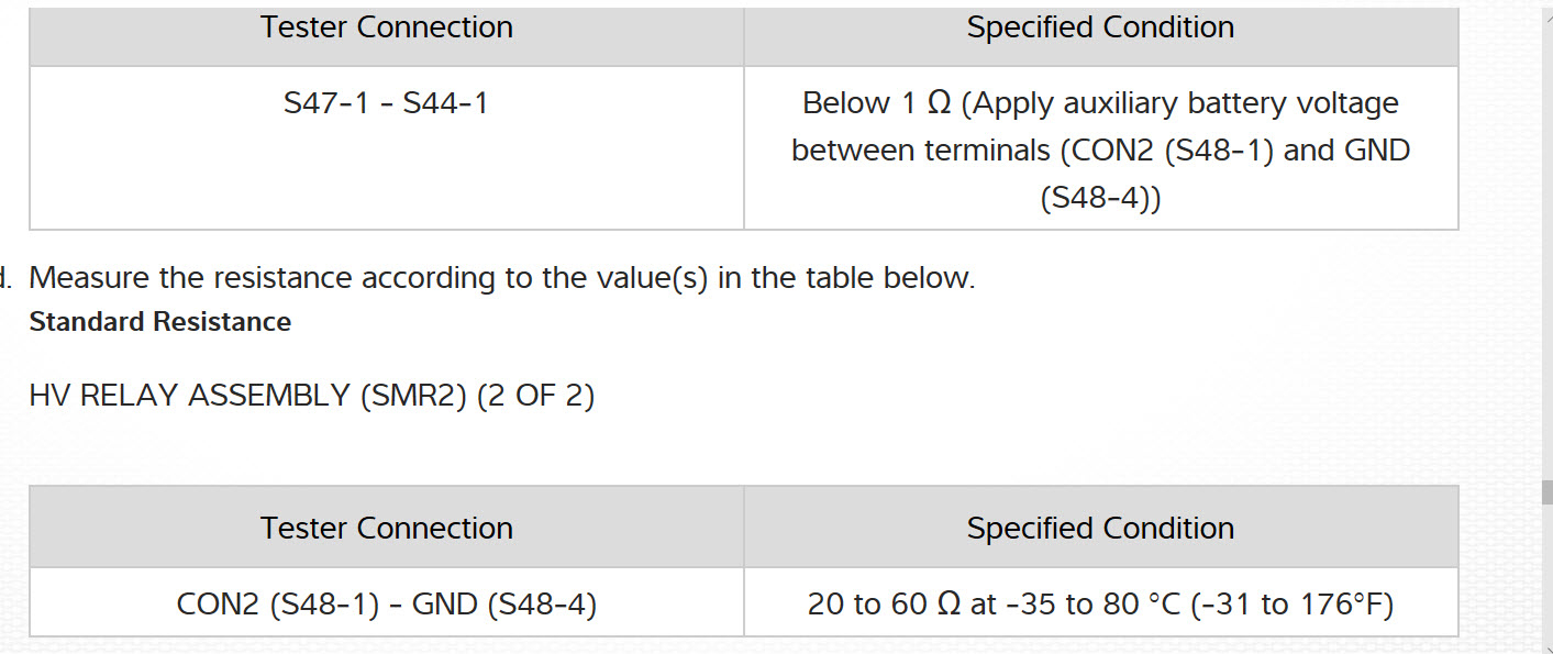

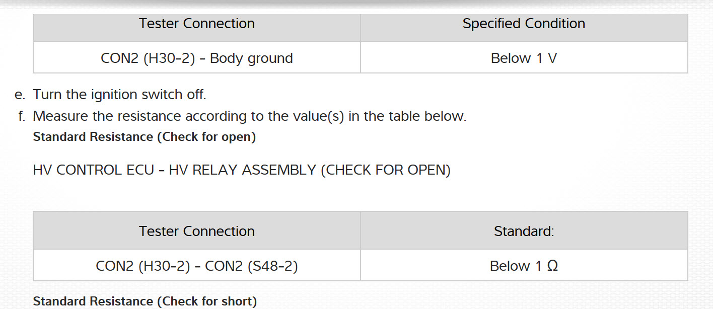

seepics this may be a wiring issue or connection as well as hybrid ecu or relay do testing in order of pics.
Jul 18, 2017 at 5:27 AM

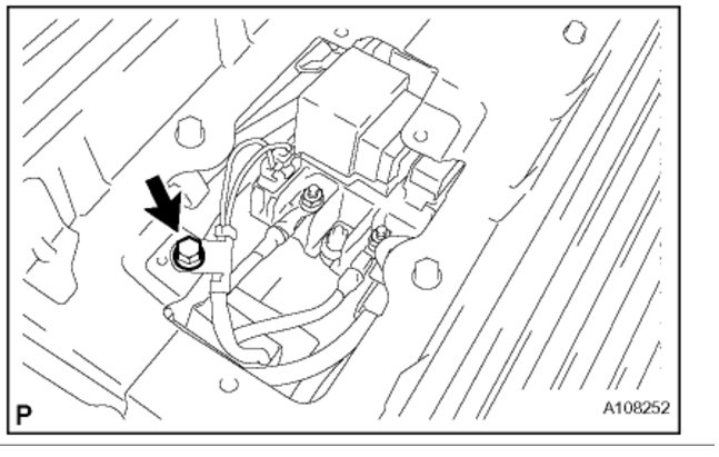

Thanks please which wires should one look out for Again the question I ask on energy monitor why is the current reading at 0.00mkg what is wrong and where. Tanks you said because of burnt wire but I have replaced d relay assembly now could the traction battery has run down and could it be charged or boosted and why didn't the engine start immediately.
Jul 18, 2017 at 5:20 PM
HMAC300
  • 48,601 POSTS
in this pic there is frayed wire which we do not have a diagram of this may be like a maxi fuse so if no wire to complete the circuit nothing works. I will leave this as an open question as I am not really familiar with this system I only jumped in to help out.

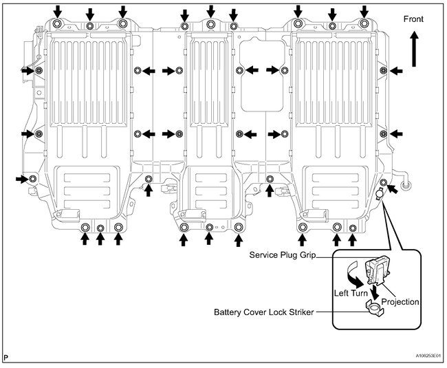

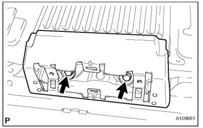

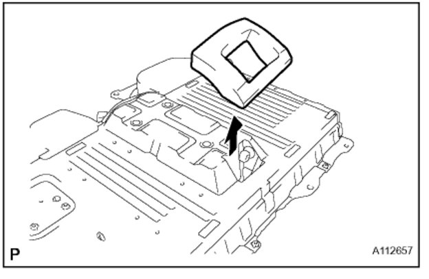

  • 55,381 POSTS
Once the battery has been run down it best to replace it. Here is a guide to show you what you are in for when replacing the battery.
https://www.2carpros.com/articles/how-to-replace-a-car-battery
Jul 24, 2017 at 8:26 AM
DECAPTAIN

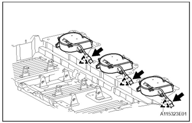

  • 29 POSTS

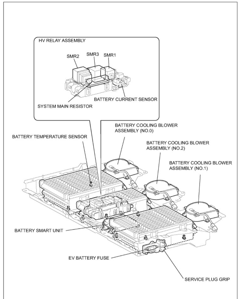

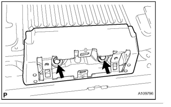

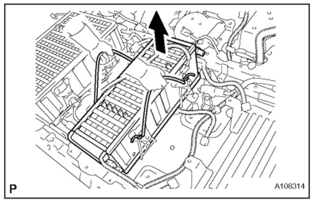

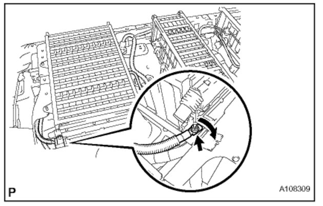

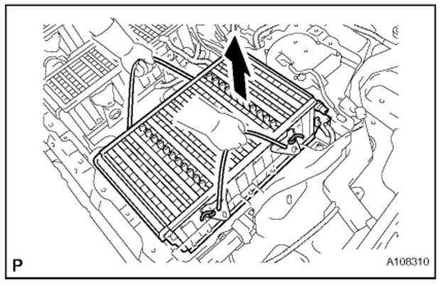

Tanks but I am referring to the hv battery under the back seat does it run down after 2 months of no use can it be recharged and what are the visible signs that the hv metal battery is down
Jul 24, 2017 at 5:34 PM

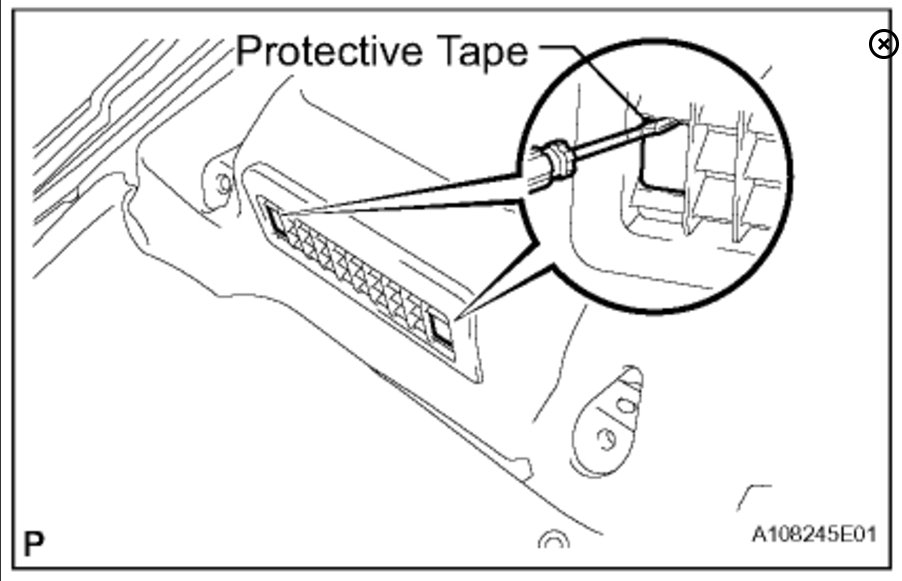

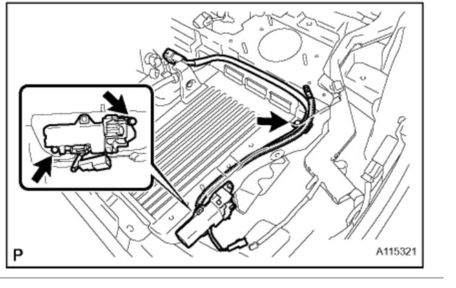

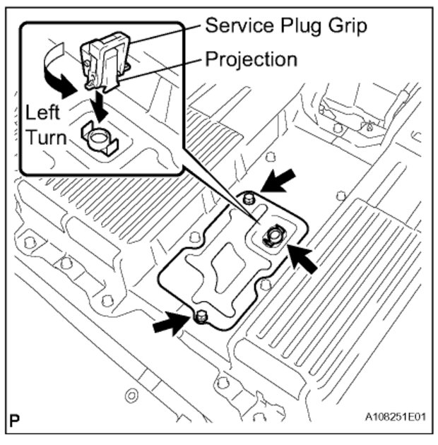

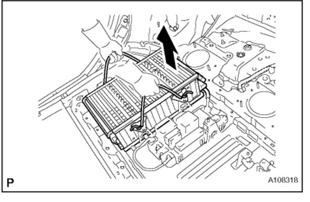

  • 55,381 POSTS

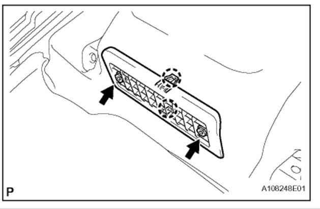

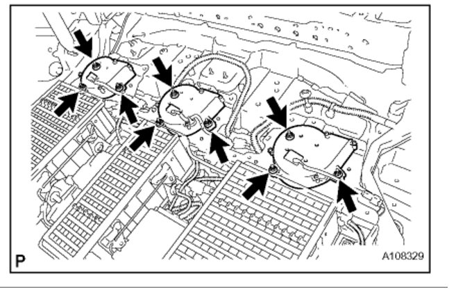

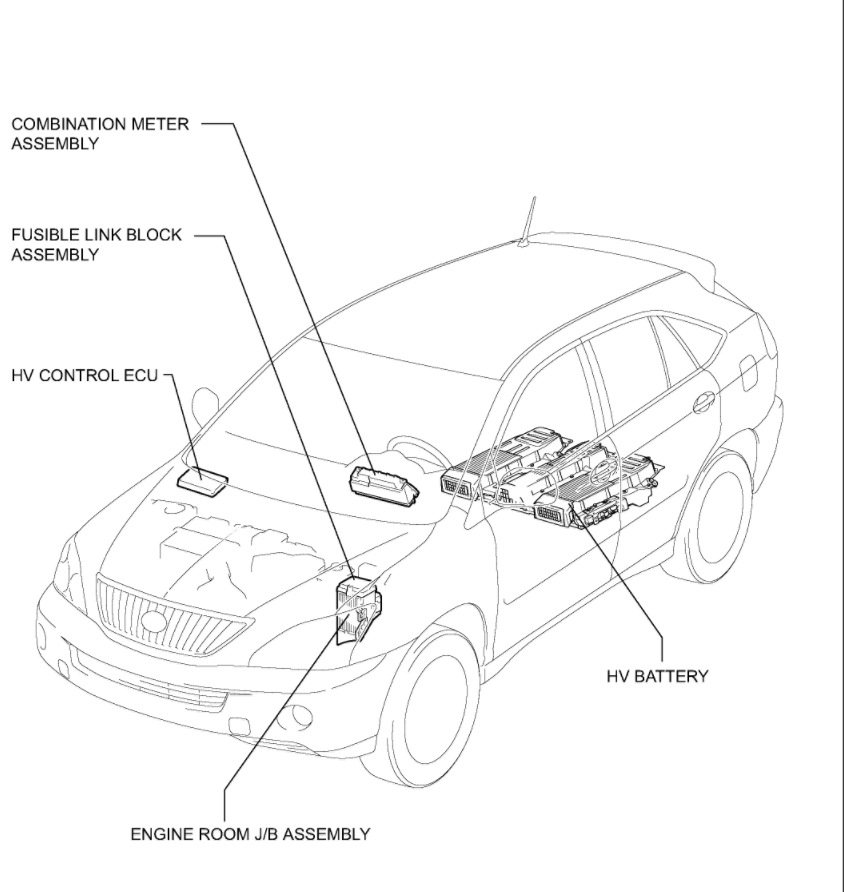

There are no physical signs just a load and performance test. The car is not a plug in so just drive it and the battery should come back if not you will need a new one. Here are some diagrams to show you how to replace the HV battery. (below)
