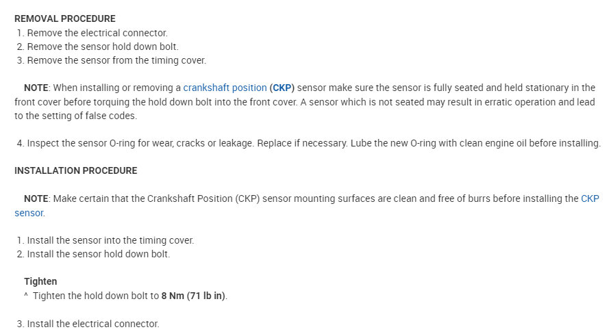

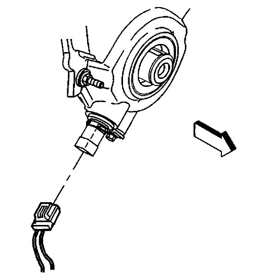

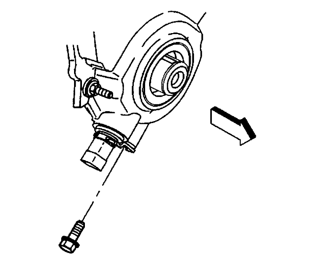

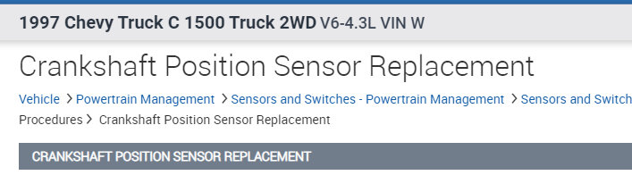

  • 110,240 POSTS
The crankshaft position sensor is located behind the crankshaft flywheel. It is held in with one bolt.
If you look below, I provided the directions for the removal and replacement of the sensor so you can see its location and how to replace it if you choose.
In the pic, it appears that the harmonic balancer/crank pulley will need to be removed, but it shouldn't.
Let me know if this helps.
Dec 6, 2022 at 7:09 AM

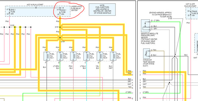

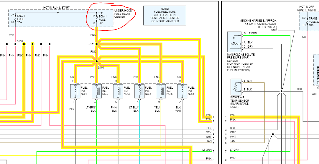

  • 110,240 POSTS

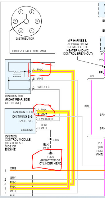

The freeze plug in and of itself won't prevent spark to the plugs. I have a feeling when the freeze plug was replaced, a power supply or wiring was damaged.
Let's try this a different way. I attached two pics below. Pic 1 provides the power supply to the coil and ignition control module (ICM).
In pic 1, you will see the ECM 1 fuse in the under-hood fuse box. Take notice of how many things get power from the fuse via a pink wire. First, confirm the fuse is good and there is power to and from it. Also, note there are several splices in this circuit as well.
If that checks good, go to the ICM and the ignition coil and confirm the pink wire to both has power when the key is in the on position.
Also, confirm the black wire from the ICM provides continuity to ground.
One other thing. Remove the distributor cap and have a helper crank the engine to confirm the distributor is turning.
Let me know what you find.
Dec 16, 2022 at 2:05 PM

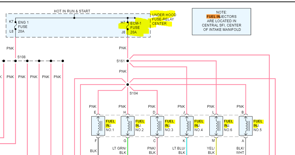

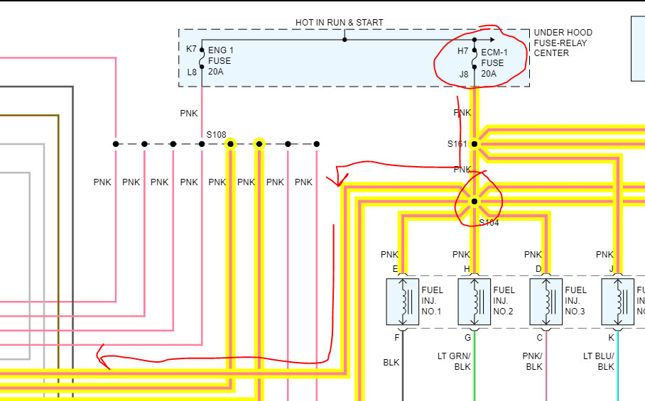

  • 110,240 POSTS
Did you check the ECM 1 fuse in the under-hood fuse box? Also, is there power to and from the fuse? Check that first and let me know what you find.
As far as powering them separately, it won't work. That fuse powers multiple things.
See pic below.
Dec 22, 2022 at 1:56 PM

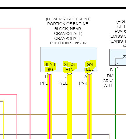

The wires were some what bare going in the plastic clip that plugs in to the crank shaft sensor and im not sure of the color there all a tan color from heat i fig i didnt relize that the harness was bolted to the fram futher up the harness and i didnt have much wire stiking out of the harness i splice the wires one at a time not to confussthem but could you tell me the color of the ground color of the signal wirethatpylsates 5 to10 volts and the color of the12 v wire so i can double check that i didnt mix the wires up when i spliced them im pretty sure the signal wire is the middel one in the clip im not a mechanic but i want to learn the clipwi.
Dec 24, 2022 at 12:32 PM

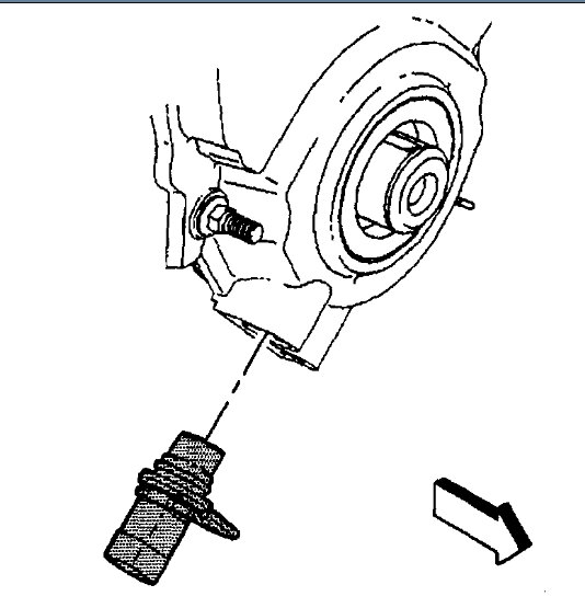

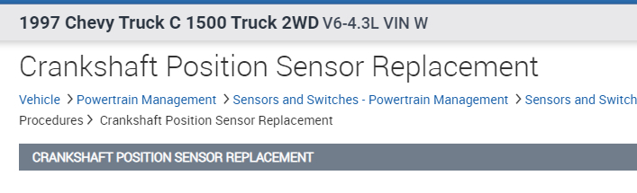

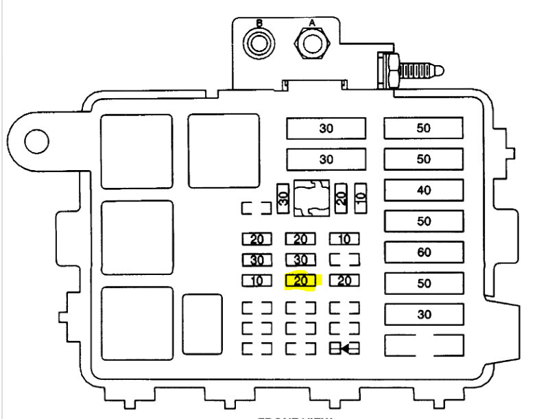

  • 110,240 POSTS
At the sensor connector, there are three wires, pink, yellow, and purple. The pink wire is the power supply. The yellow wire is called a sensor return which functions as a ground. The purple is the sensor signal wire. That is what the computer uses to determine the positioning of the engine. See pic 1.
If you don't have power to the pink wire on the connector with the key on, check the ECM 1 fuse in the under-hood fuse box. Remember, you need to make sure there is power to and from it in addition to checking the fuse. (See pic 2)
Note that since the power supply is being provided direct from a fuse, you should see battery voltage (B+).
