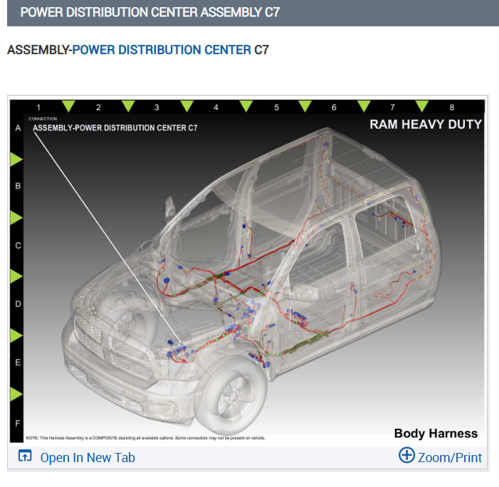

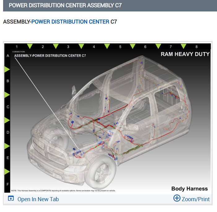

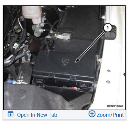

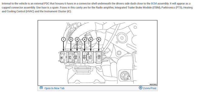

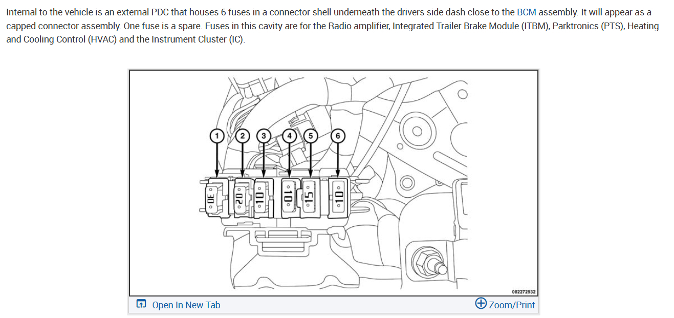

I would turn the system on and check all fuses, this guide will help, and I have the fuse location in the images below:
If all fuses are okay, it sounds like one of the accessory relays is not working or you have a bad PCM. But I checked over the wiring diagrams and this truck (2015) does not use an ignition key? Is it possible that it is a 2014? Either way let's run a CAN scan to see what codes are stored.You can get a CAN scanner (Controller Area Network) which will work on most cars from Amazon.
https://youtu.be/u-4syLc-ifQ
The accessory relays are integrated into the PDC which might be bad as well which should come up in the CAN scan if it is bad. Check out the images (below). Please let us know what happens.
