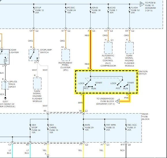

The yellow wire that connects to the ignition switch has no power unless I try to start the vehicle. The brown wire has no power as well. What would cause this? Vehicle will not start at all..
May 18, 2020 at 8:31 AM
Good evening,
The yellow wire is correct.
The brown wire should have power in the run position. If it does not the ignition switch is bad.

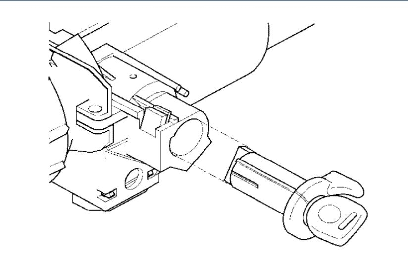

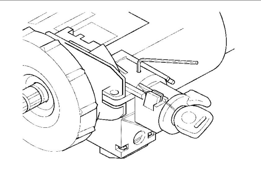

5. With the key installed, turn the key to the RUN position.
6. Install an allen wrench into the hole on top of the lock cylinder housing.
Push down on the allen wrench to release the tab on the lock cylinder inside the lock cylinder housing.
7. Slide the lock cylinder out of the lock cylinder housing.

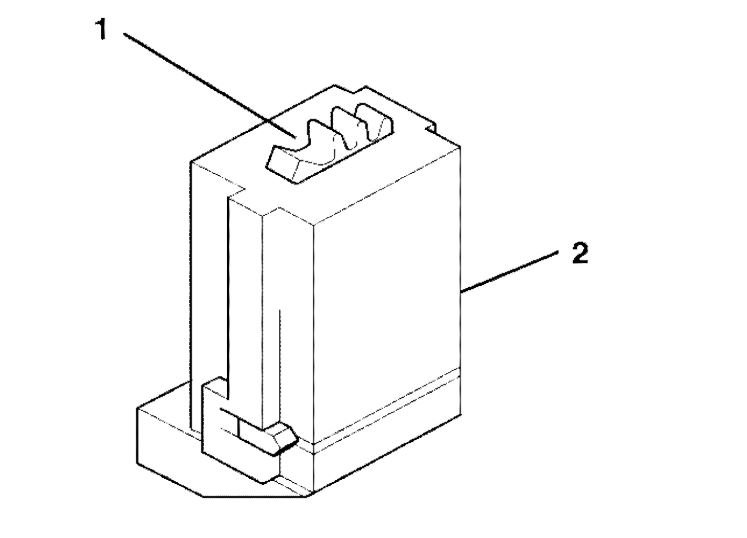

8. Disconnect the passlock and key buzzer from the lock cylinder housing.

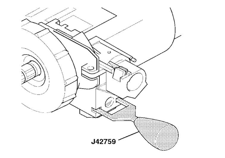

9. Insert J-42759 into the lock cylinder housing to release the tabs on the ignition switch.
10. Pull the ignition switch out of the lock cylinder housing.
11. Disconnect the connector from the ignition switch.
