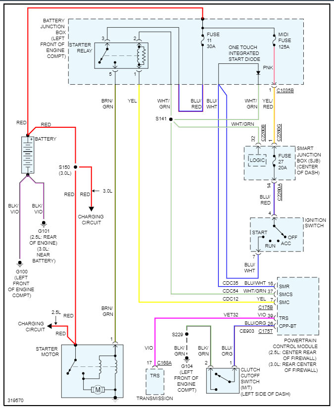

The shift cable and shift interlock solenoid broke. Both have been replaced. The car is in park now although it was stuck in drive before the repair. Car will crank and run fine if I jump the starter solenoid but doesn’t even try to crank otherwise. Checked and replaced any fuse or relay that mentioned “starter”. The car sat up for a while before the repairs we made but I checked for mouse damage and couldn’t find any.
Jul 31, 2023 at 10:04 AM
  • 55,694 POSTS

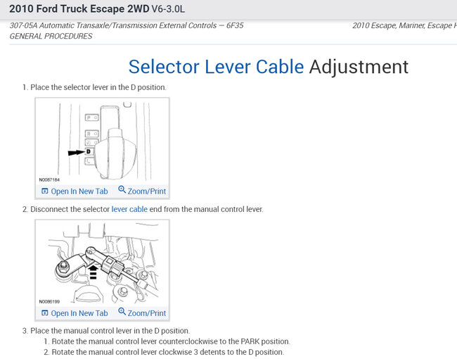

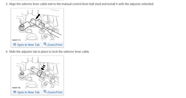

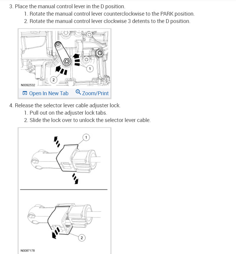

It sounds like the adjustment is off, please hold the key in the crank position and move the gear selector throughout the gear range to see if the starter kicks on. Here is how to adjust the shift cable in case you need it and I have included the starter wiring diagrams so you can see how the system works.
This guide may help as well:

This is the info I need! Would it be safe to assume the ignition switch can be ruled out? If the key is in on position it will crank when I bypass starter solenoid. If the key is off, it will not crank. Would that tell me anything else I could rule out?
I’m leaning towards a problem with the installation of those replaced parts. The mechanical switch at gear shifter works. When I change gears, I can hear a noise around the key switch. I tested it with multimeter, and it opens and closes properly when I move from reverse to park.

If the shift cable is off, I guess it doesn’t put the lever arm on the transmission in the right spot to crank? When the cable is not attached, I can place that arm to park position, then I can push it a little further, but it is spring loaded to return to park.

Yes, this is true, can you move the shifter and get it to crank over, you can use the wiring diagrams above to see where you are losing the signal to the starter.
Aug 3, 2023 at 3:18 AM
REMINEX3232
  • 6 POSTS
Moving the shifter doesn't allow it to crank over. The switch in the shifter is testing good in the park position. It has continuity.
As far as all the other tests I’m trying to work through them. When I check all the wires going into the PCM, am I testing for voltage to ground? Are any of those test continuity test? That is what’s holding me back from testing, but I’ll get back on it today.
When I test the relay seat, I get 12 volts at terminal 3. Terminal 1,2,5 all have continuity to ground. So I assume I just need to trace back from there to see why positive voltage isn’t being supplied to one of those terminals?
