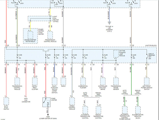

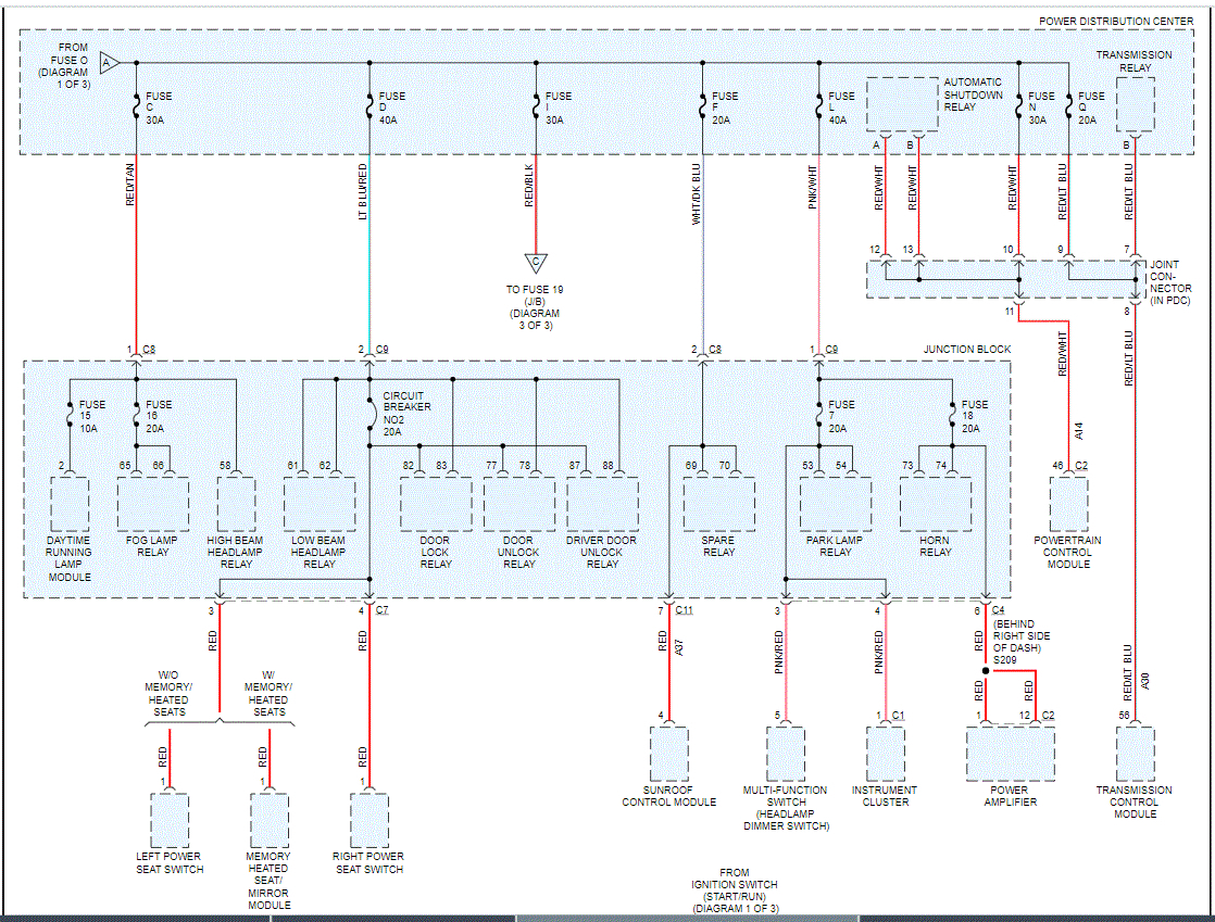

I have replaced the entire engine brand new parts everywhere car still wont start.
Apr 23, 2021 at 1:57 AM
CA DH

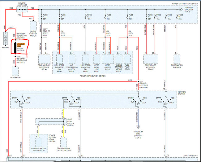

Is there a fusible link in the middle of the car under the dash? just asking or can you give me all fusible link locations?
Apr 23, 2021 at 2:05 AM
  • 110,240 POSTS

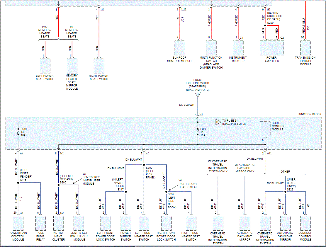

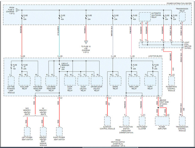

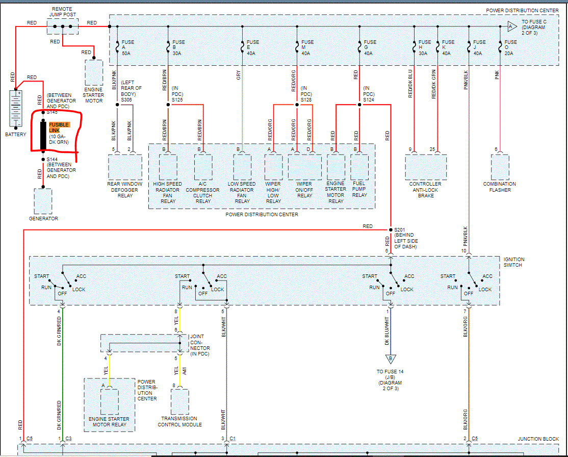

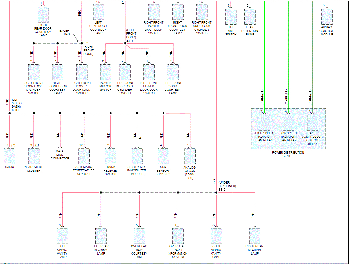

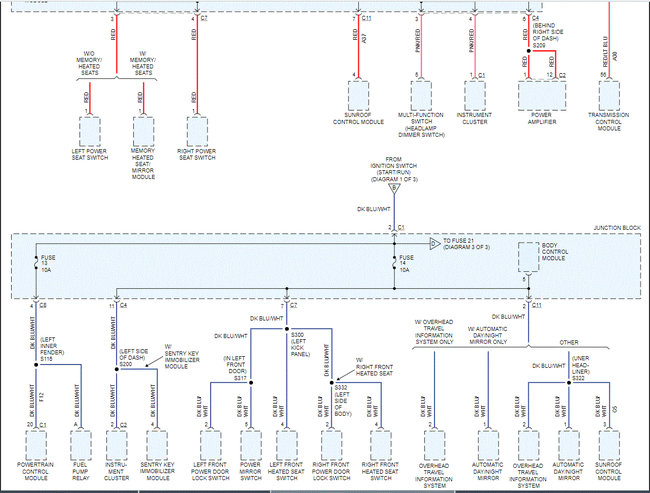

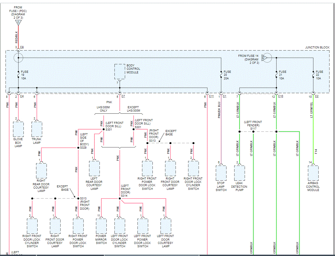

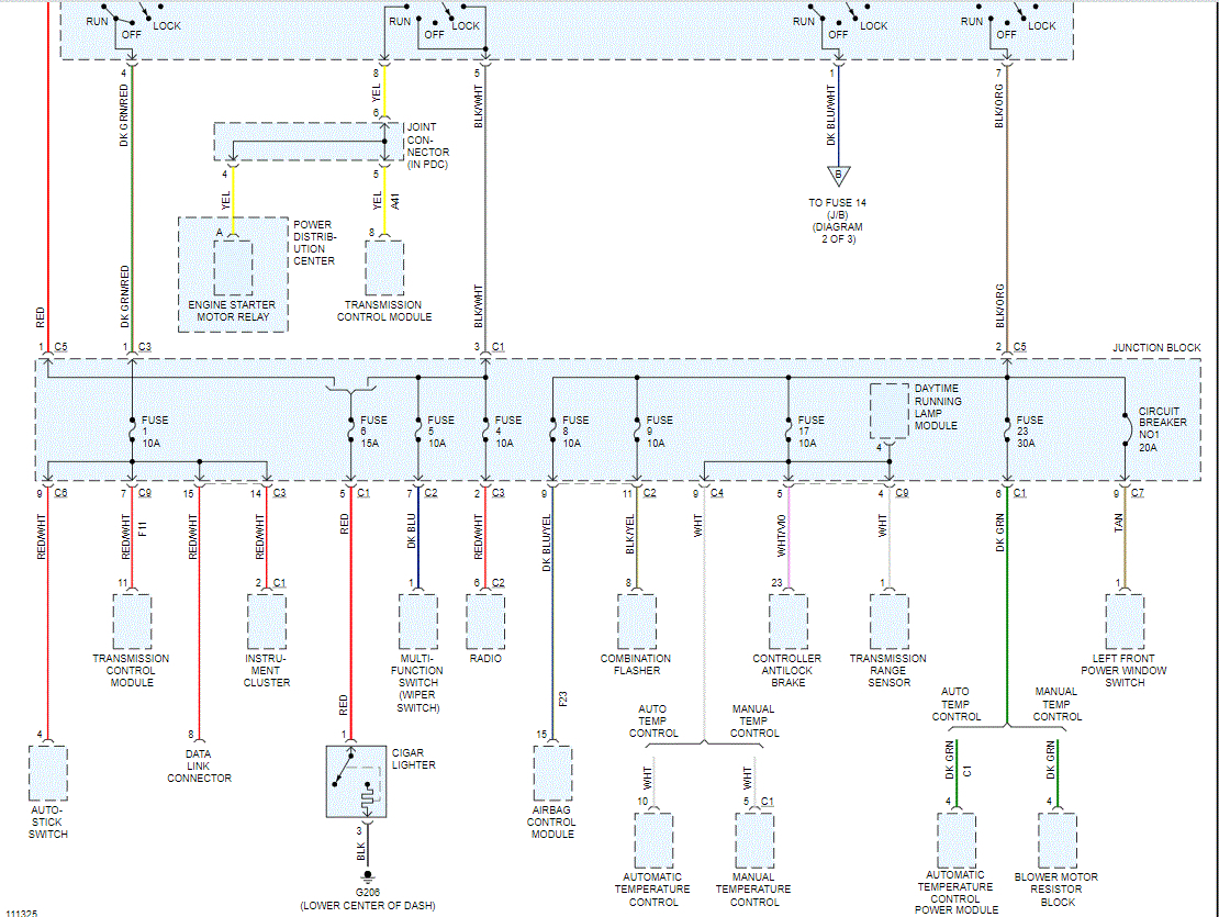

I attached the entire power distribution wiring schematics below. I'm not sure exactly what is happening, so I hope that helps.
If possible, let me know the specifics. For example, does the starter engage? Does the engine fail to start? Is anything electrical working?
See the pics below. The only fusible link I'm seeing is between the alternator and the battery. You will see it in the first pic below. Also, I circled it for you. Also, I had to cut the pics in half to make them readable. I did overlap them so you can follow from one to the next.
Let me know if this helps or if you have other questions. Also, let me know the specifics of what is happening.
