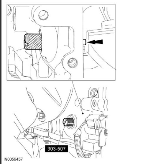

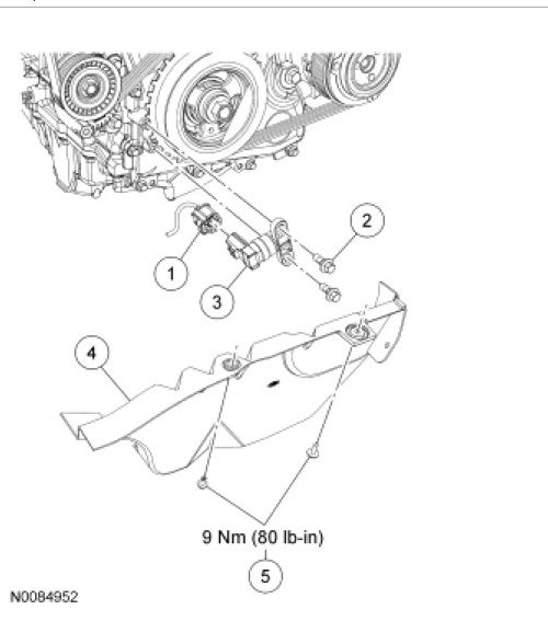

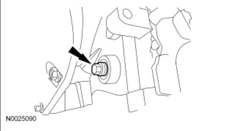

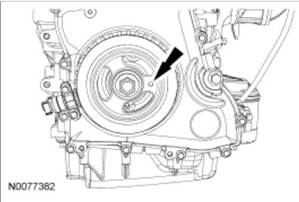

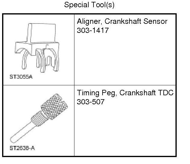

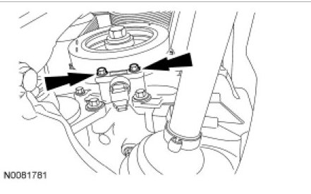

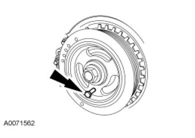

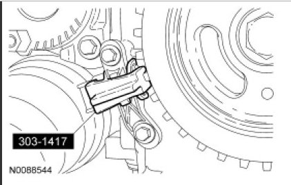

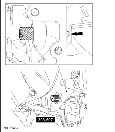

It sounds like you have a crankshaft angle sensor that has gone bad. This will make the fuel pump stay off as well.
Here is a guide to let you know what you are in for when doing the job:
You may need to jack the car up here is a guide on that as well:
Here is how you do the job in your car.
