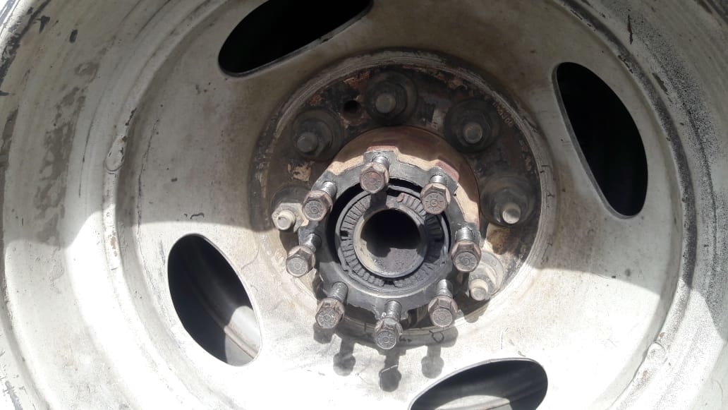

We found the left axle broken and rear wheel bearing need change also I quick checked in internet I found it is not expensive so I will try to order it from any us spare parts that they ship overseas mostly takes 10 - 14 days to ship to Saudi Arabia (axle part yc2z-4234-ab) but I don't know the bearings part number.
Tomorrow I will send picture of that also what I have done inside the car

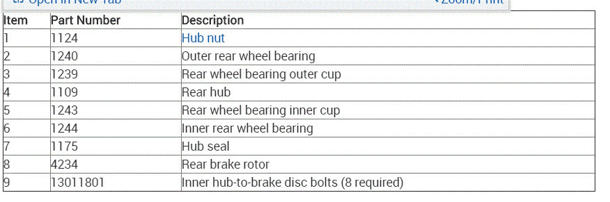

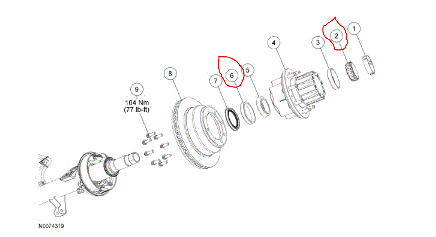

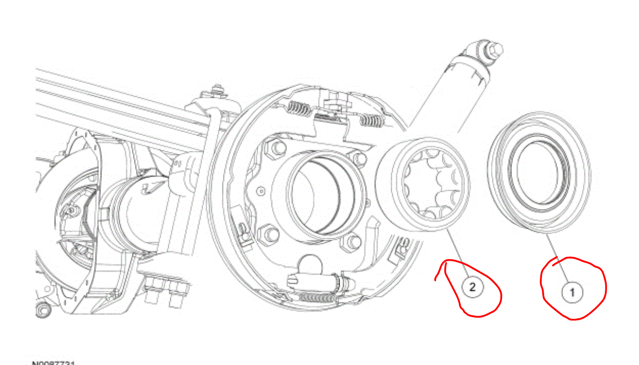

If you tell me which bearing it is, I can most likely get the part number. I suspect it is the axle bearing closest to the wheel. They commonly go bad. Let me know. If that is correct, you will need to also replace the axle seal. First the bearing is installed into the axle housing and then there is a seal that goes in as well. The axle itself will go through the seal.
When you get the info, let me know. I suspected something broke. LOL You are not having good luck with this vehicle. It must have had a rough life before you purchased it.
Also, we will need to confirm which differential you have. If you look at pic 1, it shows an exploded view of the full floating differential (Dana). Pic 2 is the part break down and part number for each part. The full floating design has two bearings.
If you look at pics 3 and 4, they show the Dana 60 and Dana 70 semi floating design. I did the same thing with pics. Pic 3 is an exploded view and pic 4 shows the part and number.

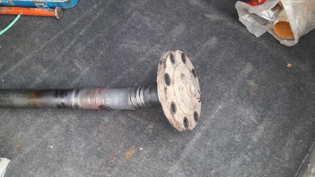

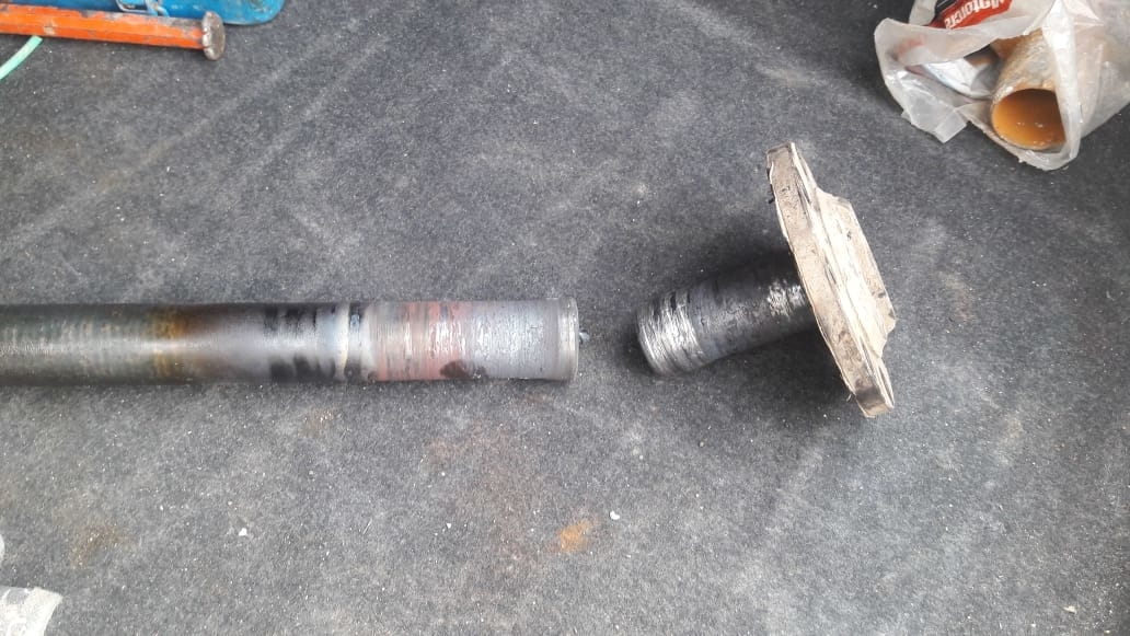

I send picture for the left side axle the broken I mange to fix it with electric welding as temporally until I purchase new one. But you see the bearing need to be change right a way it is not available here. The Ford dealer give this part number (yc2z-4234-ab).

Wow. That certainly broke. Please, Please, Please, be careful. I have never seen one welded before. I'm concerned it could break. And you do have the "Full Floating" axle. Which makes it nicer to work on.

Make sure you replace the bearings and the bearing seals.
