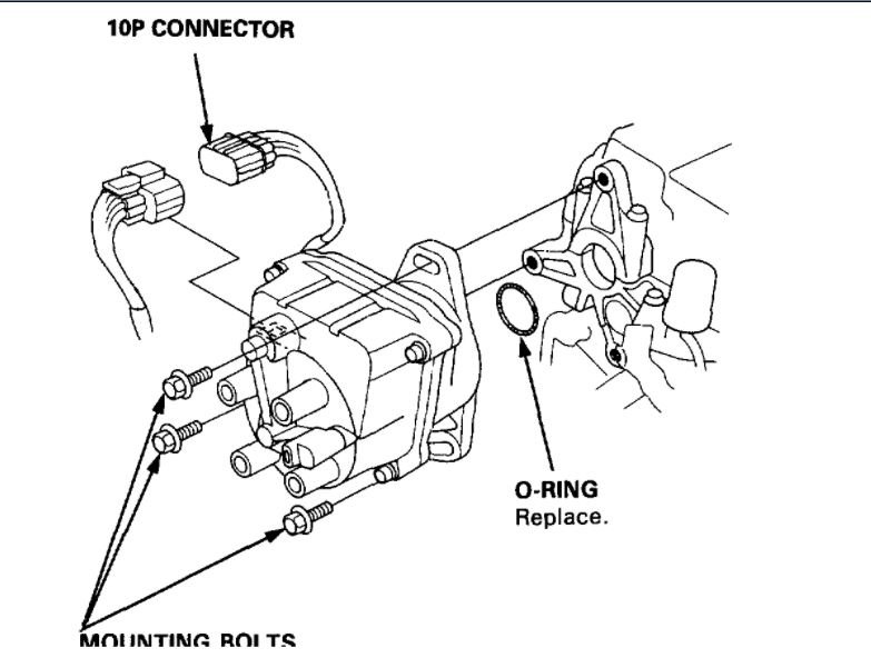

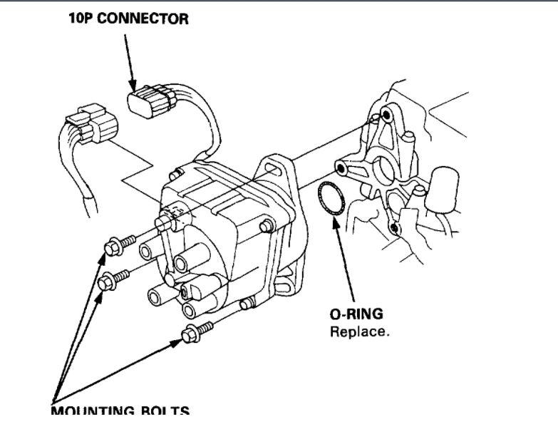

So my car won't start it's not getting spark and the fuel pump not kicking on when key is turned. there's brand spark plugs and wires the dizzy is new fuel pump is new, but the crazy thing is; when i plug in a code reader to the obd2 port the fuel pump works when you turn the key to the on position but still wont start.
Nov 16, 2020 at 4:49 AM
Good afternoon,
Are there any codes set in the system?
The distributor is a very common failure. There are sensors inside that fil and affects both the fuel pump and spark. I attached a picture below of the distributor.
Also, remove the distributor cap and make sure the rotor turns when cranking. That will tell me the timing belt is working.

The rotor is turning. there no codes no lights on on dash panel. the dizzy is getting pretty warm.
Nov 16, 2020 at 9:11 AM
Okay, then I would replace the distributor.
I gave you the picture in a previous post. You cannot install it wrong as the gear is keyed to only go in one way.

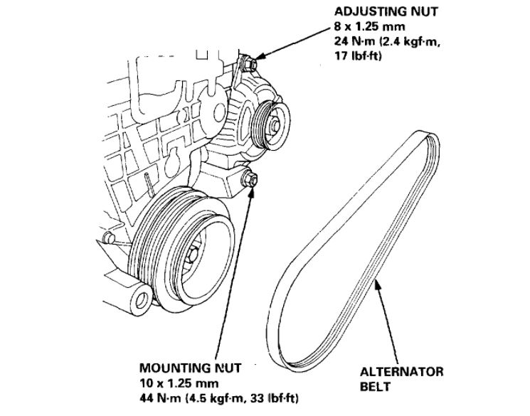

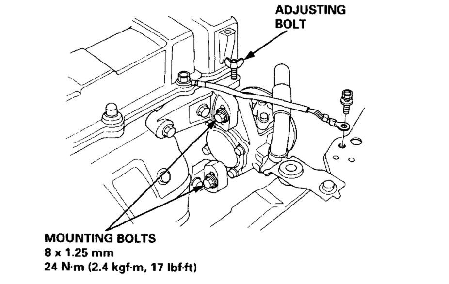

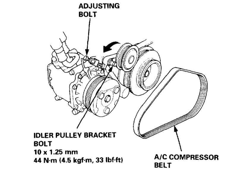

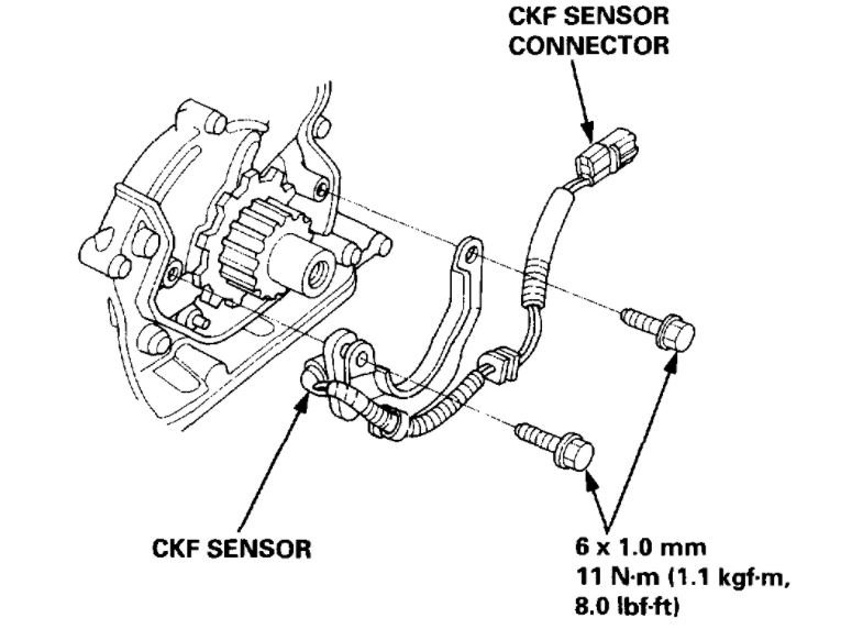

Assuming the new distributor is good, you have a second crank sensor behind the timing cover at the crankshaft gear.
REPLACEMENT
1. Remove the wheel well splash shield.
2. Loosen the adjusting bolt and mounting bolts, then remove the P/S pump belt.
3. Loosen the adjusting bolt and idler pulley bracket bolt, then remove the A/C compressor belt.
4. Loosen the adjusting met and mounting nut, then remove the alternator belt.
5. Remove the cylinder head cover.
6. Remove the crankshaft pulley.
7. Remove the middle cover and the lower cover.
NOTE:
Do not use the middle cover and lower cover for storing removed items.
Clean the middle cover and lower cover before installation.
8. Disconnect the CKF sensor connector, then remove the CKF sensor.
9. Install the CKF sensor in reverse order of removal.
